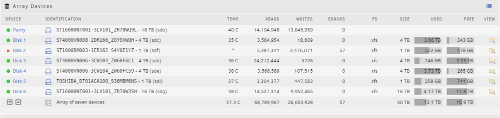

These are my drives, and they are as follows:
Storage = Disk 1, 3, 4, 6
Middleman storage + configs = Disk 2 ,5
However, now my Disk 2 pinged for some errors and didn't want to play ball anymore. I noticed some posts recommending to replace it ASAP, which I intend to. I recently installed 2 16TB disks to start replacing my 4TB disks. (Parity + Disk 6)
With this I began moving data from Disk 3 to Disk 6, and now it's almost empty.

39 minutes ago, Oaken said:
  • Empty Disk 3
  • Remove it from the storage share
  • Format if necessary
  • Rebuild Disk 2 from parity onto Disk 3
You cannot do this, you can move all data from the emulated disk2 to other disk(s), then do a new config and resync parity without disk2.
