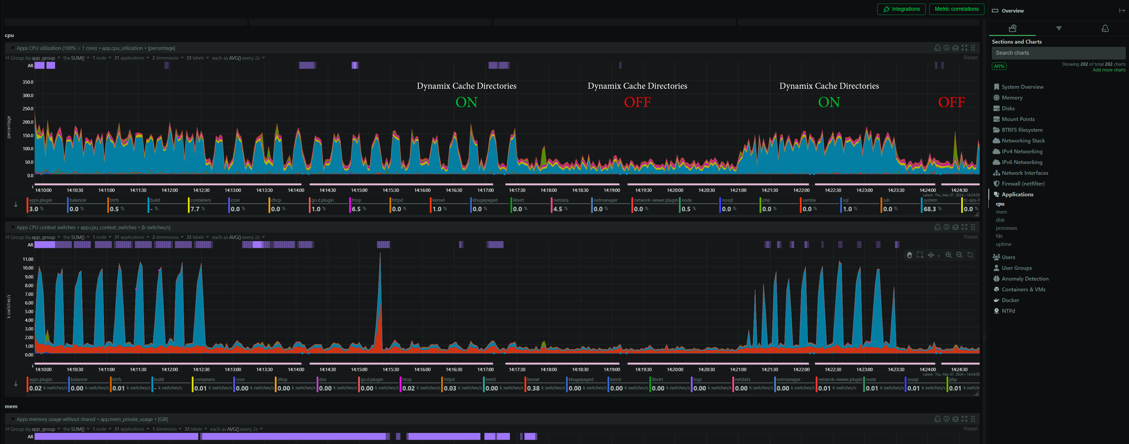

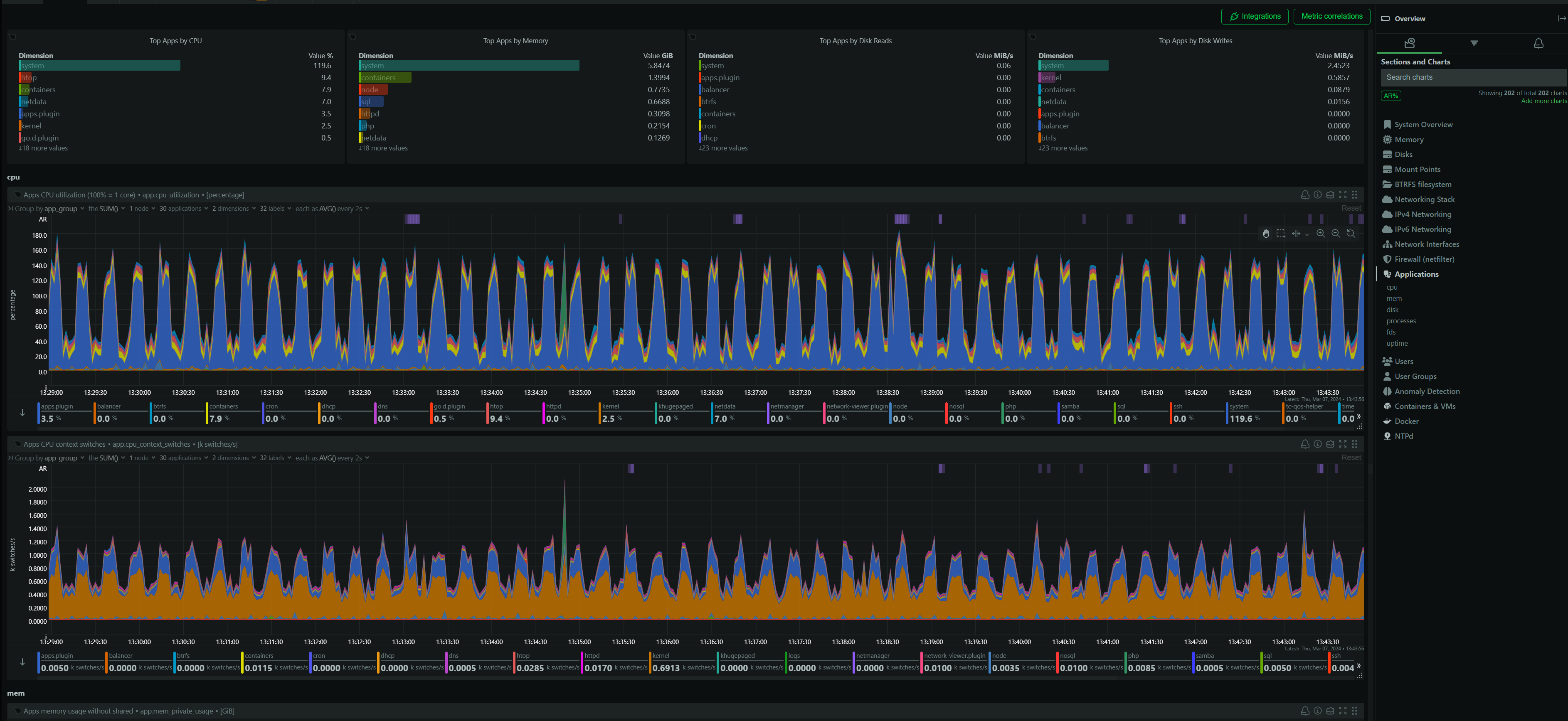

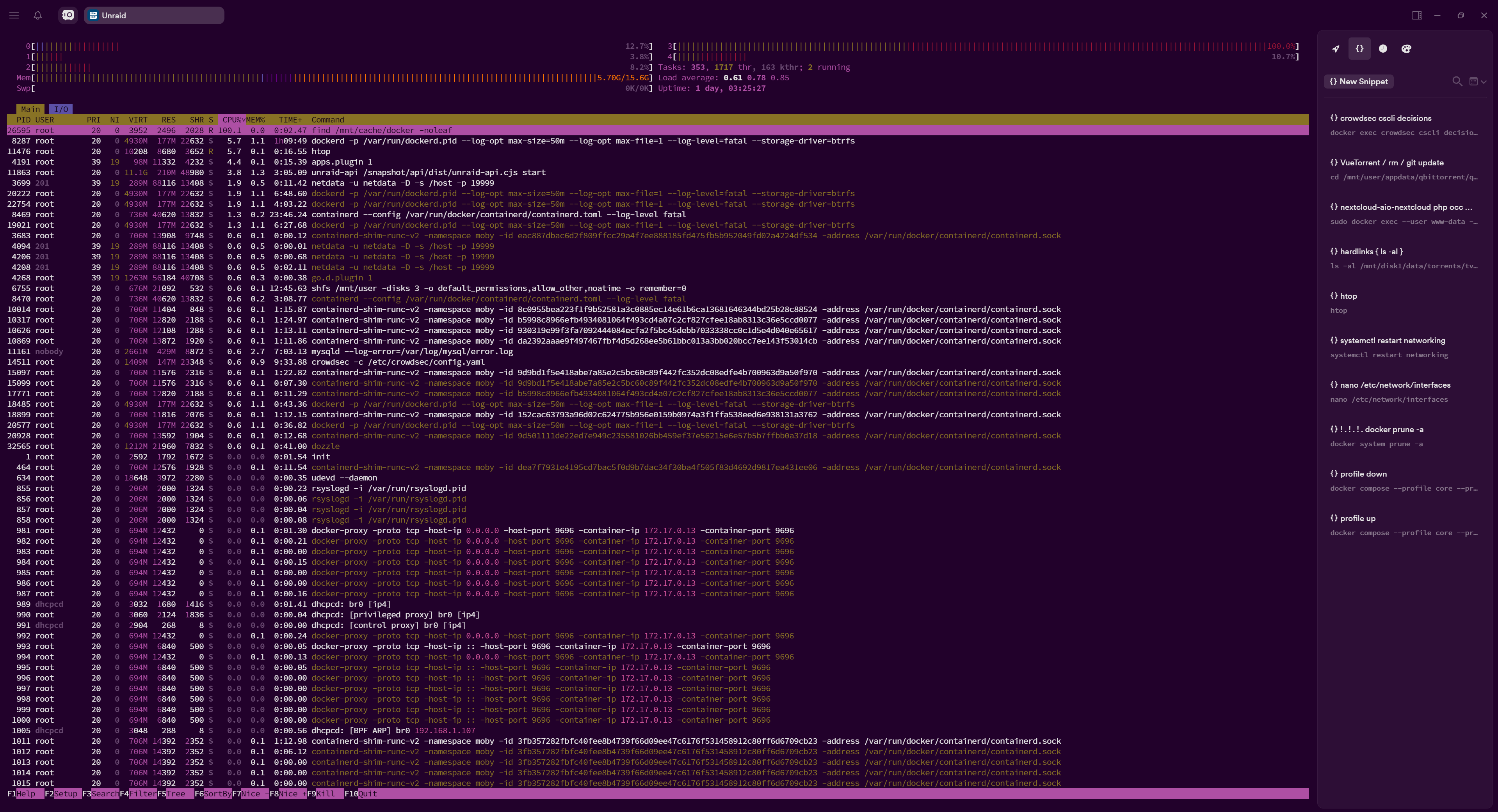

I've been experiencing an issue on my Unraid system where a particular process is causing unusually high CPU usage every 5-10 seconds. The process in question is a `find` command running as root, specifically `find /mnt/cache/docker -noleaf`. This seems to be repeatedly scanning my Docker cache directory, and I'm unsure why it's happening or how to address it.
I've attached screenshots from Netdata that show the spikes in CPU usage corresponding to when this command is executed. These spikes are making me concerned about potential performance impacts on my server.

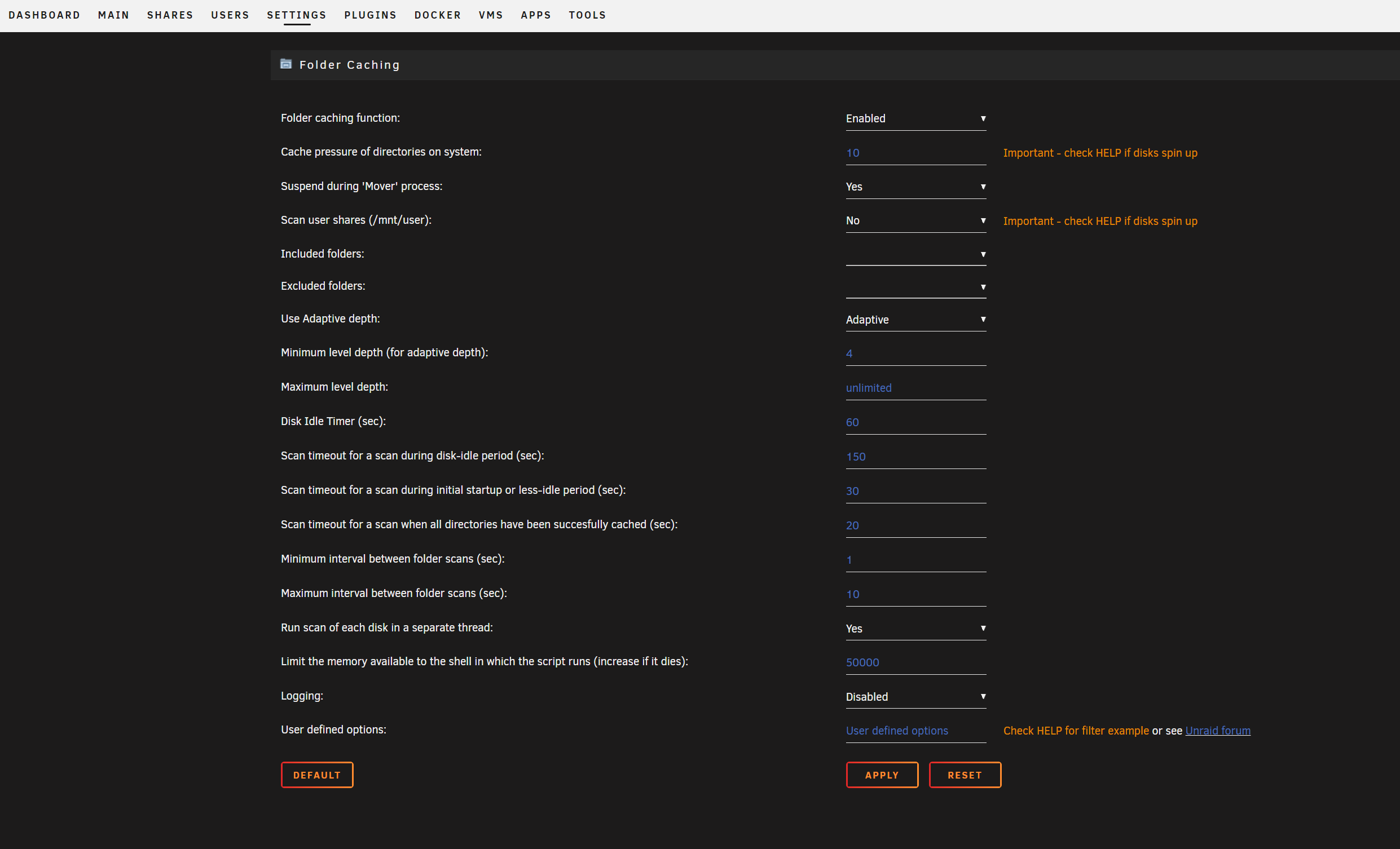

Ok, I think I found out what is causing this issue. It was the "Dynamix Cache Directories" Unraid plugin.
I disabled it. Any reason why I should leave it on?
The purpose is to avoid disks in the array being spun up unnecessarily.   However you do need to use the included Folders setting to limit to relevant folders to avoid excessive scanning.

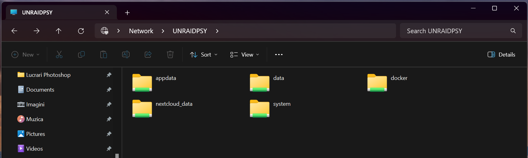

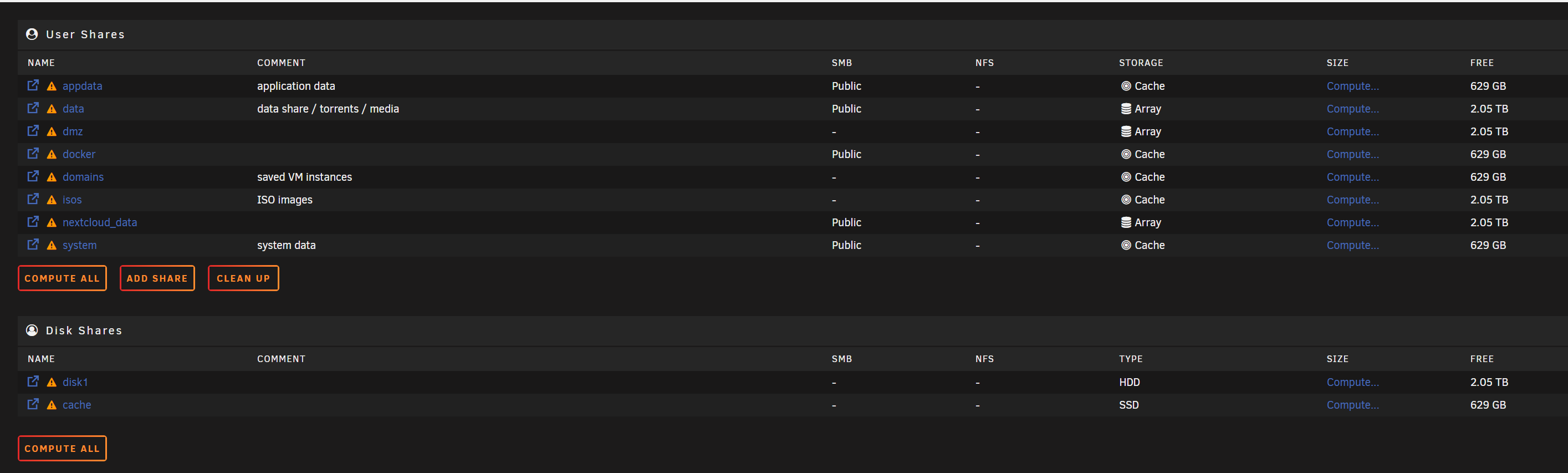

My shares:
There is no ‘right’ answer to this as it depends on exactly how you have things set up, but based on you comment it is likely you only want the ‘data’ folder included.
Ok, Thanks!
I have SMB on for these folders. Nextcloud data is on the spinning disk too. Should i include the data and nextcloud dir too?
It seems that these spikes appear only if I do not include any dir in the plugin settings.
Edited by psy
Of the shares you have, only data and nextcloud_data should be scanned.
Personally, I would have those other shares hidden or not shared on the network.
You basically want to make settings to limit the number of folders/files to be scanned.    If the number is too large the the Linux level will not be able to keep all directory entries in RAM so it is continually re-reading them causing the symptoms you saw.
Thanks! I share them because in data i have only torrents and movies and i don't care about them, and nextcloud_data because transfer is way better with smb than via nextcloud on browser.

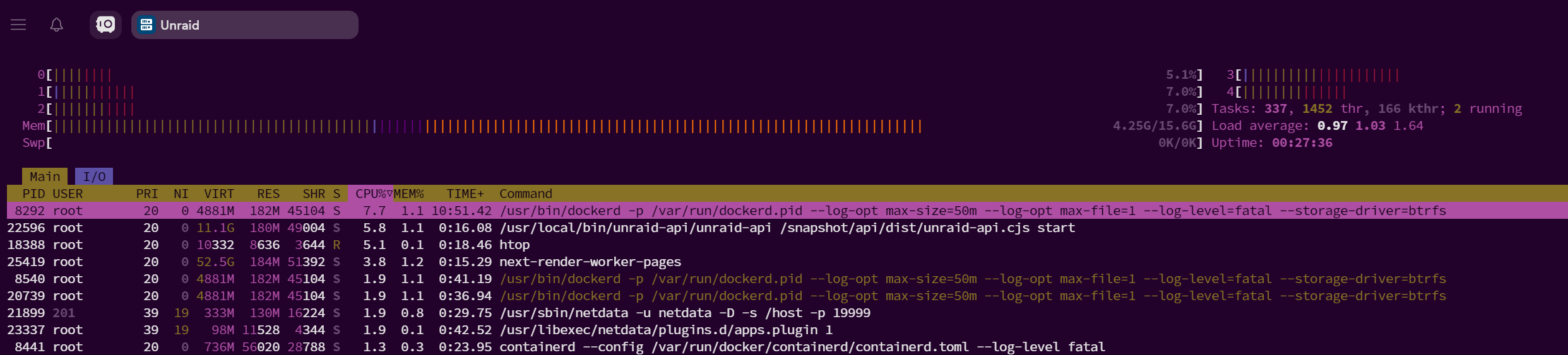

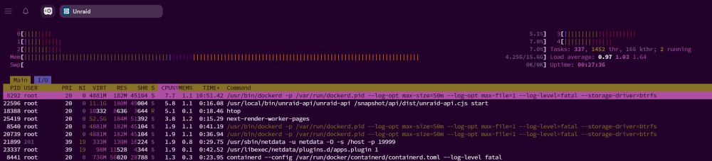

What is this process?
/usr/local/bin/unraid-api/unraid-api/snapshot/api/dist/unraid-api .cjs start
It seems that this also causes my cpu spikes every few seconds.

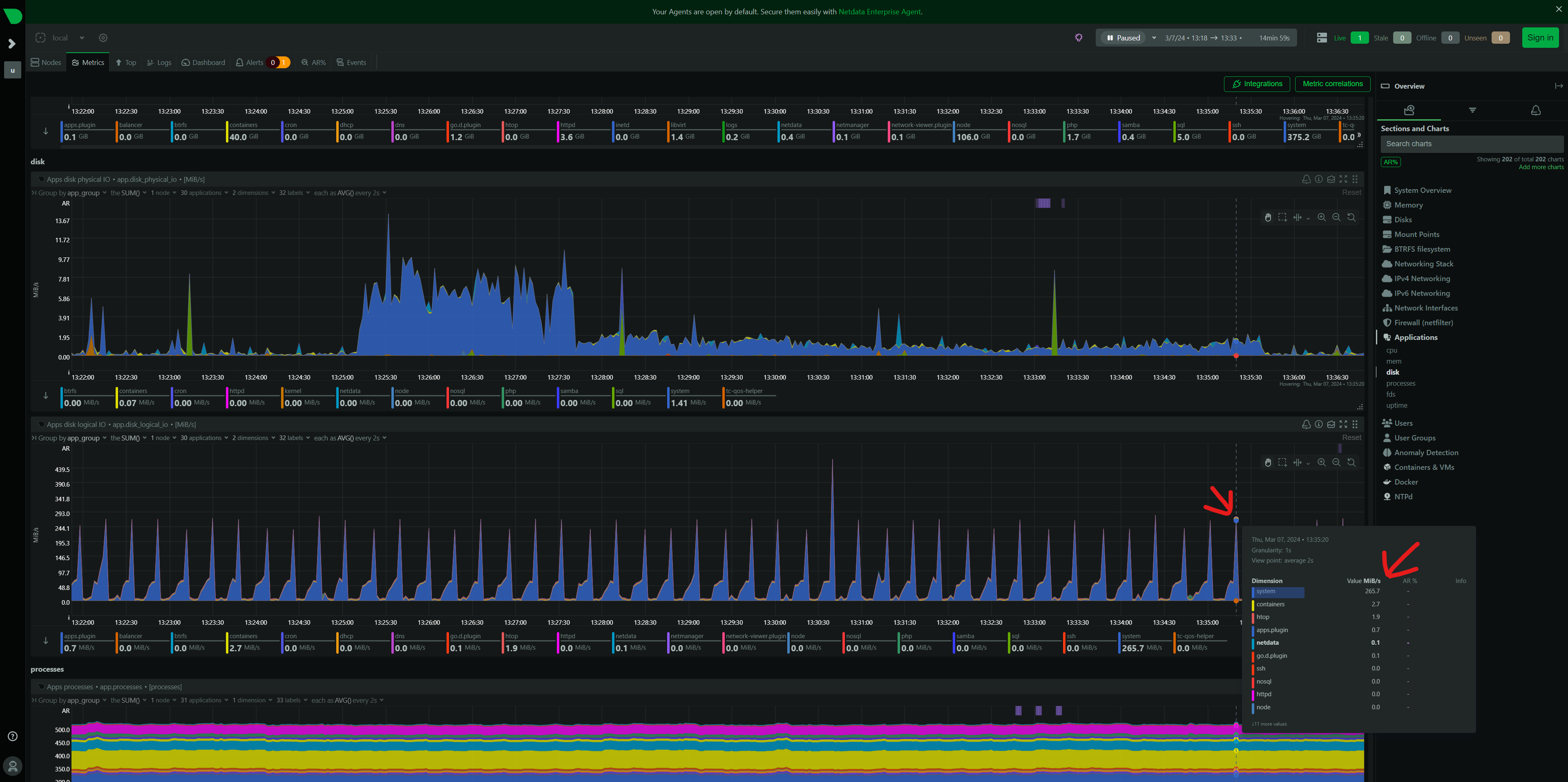

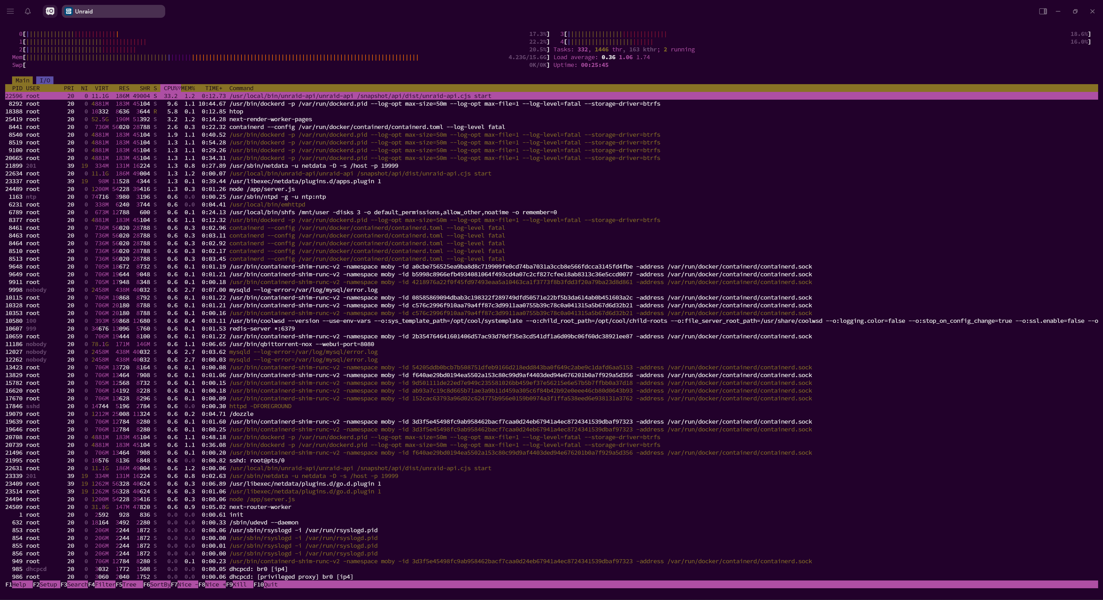

Also this one:
I fixed the unraid-api cpu spikes by removing the unraid connect plugin.

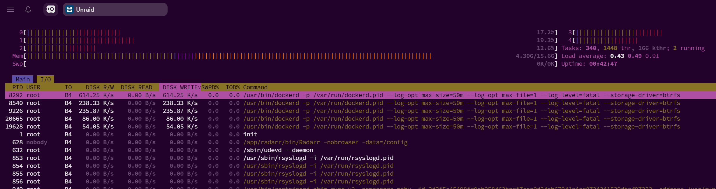

I think something is filling up my logs, and therefore putting pressure on nvme writes. Is this normal?
