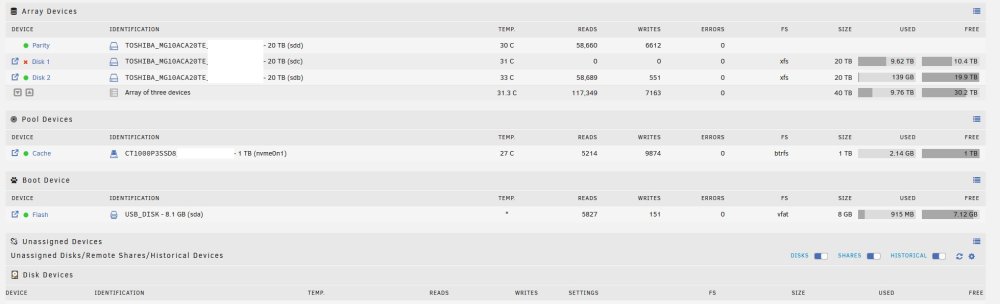

Hi community,
I'm using the latest version (6.12.8) of Unraid in a 3x20 TB TOSHIBA MG10ACA20TE Setup. In order to save power, I'd like to make use of the sleep mode and wake on the server either via PC or mobile phone. So I used this guide (https://docs.unraid.net/unraid-os/guides/wol-setup-for-unraid). It worked for a couple of times (wake up via PC -> Server) until I experienced a "device disabled" issue on one of my drives. After the first nervous breakdown, I checked the SMART data, it looked fine, so I started to rebuild the array which was successful.
Now, a couple of days later I found the "Dynamix S3 Sleep" app on the Community Market, but unfortunately after the first usage, I ran into the same "device disabled" issue again. So I'm pretty sure that the Sleep mode somehow negatively impacts my array / one disk within the array.
The disk itself is brand-new, I did a complete Unassigned Devices Pre-Clear before to be sure that the HDDs are (most likely) fine.
I would be very happy if one of you could give me some guidance:
- Any idea how to re-enable the disk without a painfully-long rebuild?
- Any idea what could cause the issue in regards to the sleep mode?
Thanks a lot for your support.
If nothing was written to the emulated disk you could do a new config, but then will need a correcting parity check, and that will take the same time, that's why we usually recommend rebuilding instead.
Not with out the diags showing the error, but I would say sleep can be a good suspect, try running the server without sleeping for a few days.
Thanks for the reply. The diags are lost after each reboot correct? Thanks.
Guess I have to re-start just another 28-32 hours rebuild 😕
The syslog is, it should remain after sleep/wake up, it keeps happening you can also enable the syslog server.
