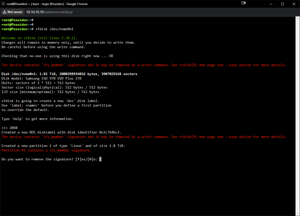

Pool is not importing because the first device doesn't have a valid fs, try this:
sfdisk /dev/nvme0n1
then type
2048
and hit enter, finally post the output/screenshot of the results
Edited by NGMK
Type N to keep the signature and enter, then type
write
and enter, after that re-start the array and post new diags.

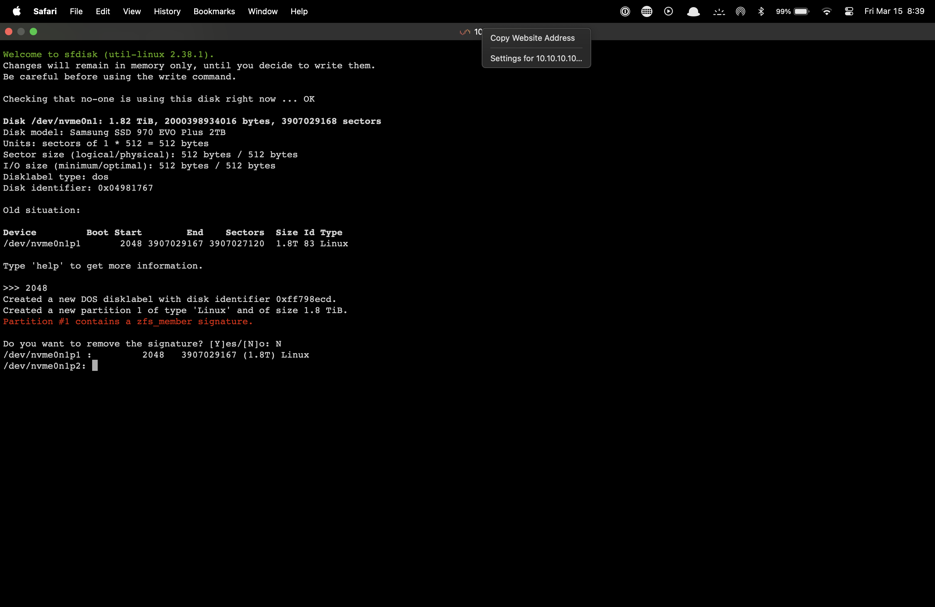

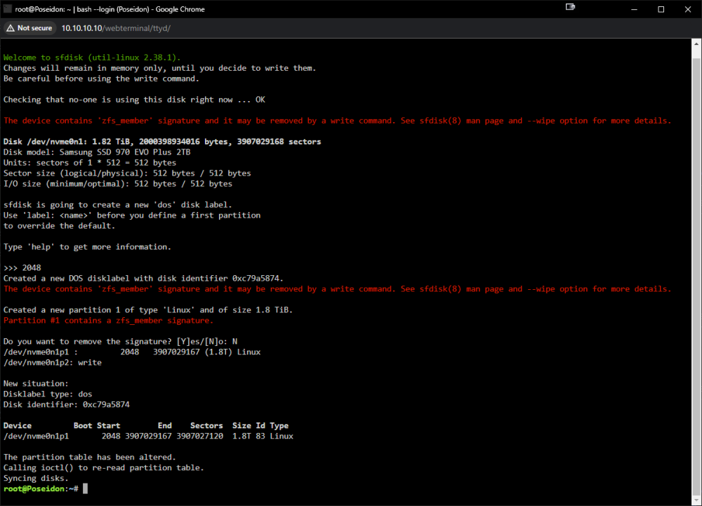

when you run the command  [ sfdisk /dev/nvme0n1 ] then type [2048] then [N] to not remove the signature  I get the following, asking for the other devices in the pool. I type write close the command line and try starting the array but it wont start. below if the screen shot and the new diagnostics
P.S. I really appreciated you taking the time to help.
poseidon-diagnostics-20240315-2031.zip
That is not for the other devices, it's if you wanted to create a second partition, just type write and enter, not clear if you already did that or not.

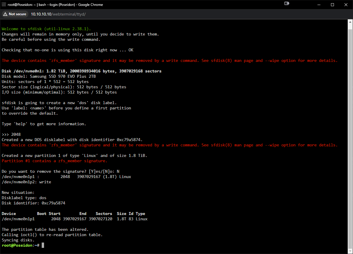

Yes I already did type [write] after, and I did this whole process more than once but the Array wont after, and I always end up having to reboot the server. the only data valuable inside the cache pool was my appdata and I have a 2 weeks old backup in the main array, however Im very concern on how this cache pool became so corrupted, this is the very first time me using ZFS and red on another post that zfs1 with 3 drives in a cache pool was only recommended in a experimental setting and not in a mission critical server.  What else can we try here. I will prefer to save the pool if possible. New Diagnostics attached.
poseidon-diagnostics-20240316-1430.zip

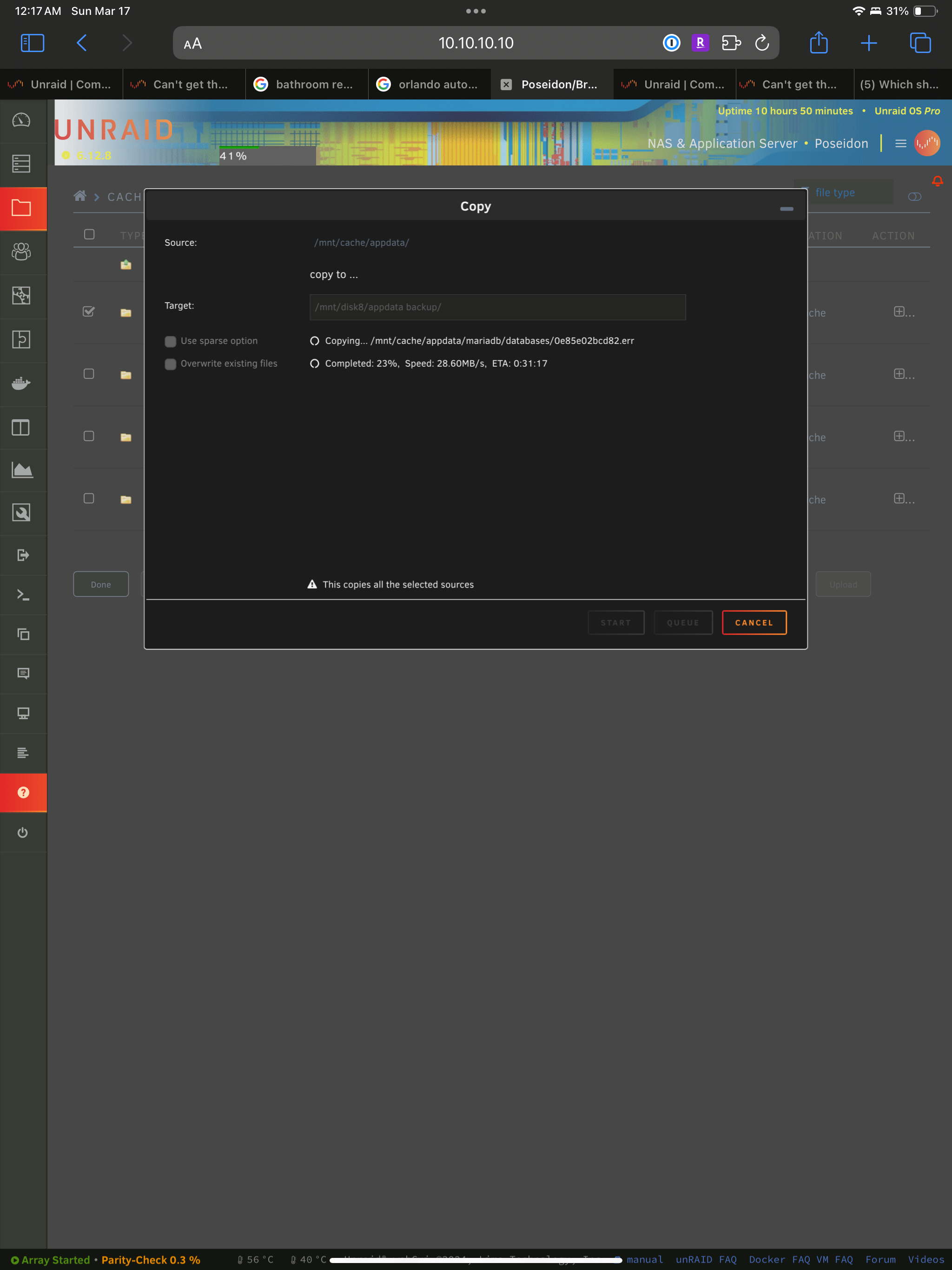

and was able to start the array with the cache on read only status, the cache pool is available on the gui file explorer, I tried coping the appdata folder to one of the array disks and all was going well until it just stayed on a single file transferring it forever
Check the main page for write speeds, to see if it's still going, also the syslog for any errors.
So I created a new share in a another cache pool I have with only one sata ssd and copied the appdata directory to it and judging by it size i believe all files are there. Should I just give up on the nvme pool (main) reformat and recreated the pool?
Once the data is backed up you will need to re-format the pool.
