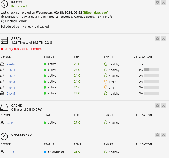

All runs well with the system but the time needed for parity-check ist very long in my opinion: a little more than 1 day and 3 hours.

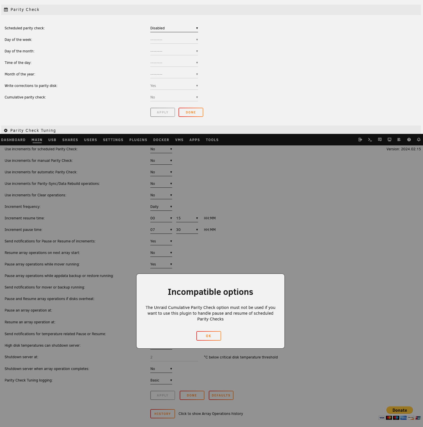

Therefore I tried to install the "Parity Check Tuning" to split the time of parity checking.
Always when trying to start the "Schedule" from Main/Array Operation I got the Message "The Unraid Cumulative Parity Check option must not be used if you want to use this plugin to handle pause and resume of scheduled Parity Checks".
So I disabled the "Standard" Parity check but always got the "Incompatible Options" when trying to fill in the options of the tool.
My searches here and in Google were not successful. What did I wrong?

You must still have the standard parity check set to the schedule when you want the parity checks started, but you must set the Cumulative Parity Check setting to No if you are using the Parity Check Tuning plugin to handle pause/resuming of increments.
I'll reword that message to make it slightly clearer.
Thanx a very lot! Now it runs without Error-windows!
That message is misleading and I will look into clarifying.    You must not disable the built-in parity check running at the frequency you want as the plugin never initiates a parity check - just handles pausing and resuming of one already initiated.    What the message is saying is that you must disable the option in the standard settings for the cumulative checks as otherwise you will get strange results as the standard software and the plugin both try and handle pauses and resumes and get in each others way.
