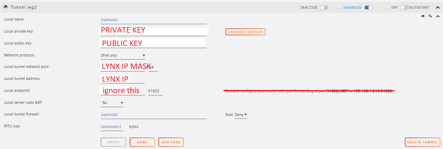

2. Add tunnel.  (Mine became wg1).
3. Setup the interface to look something like this:

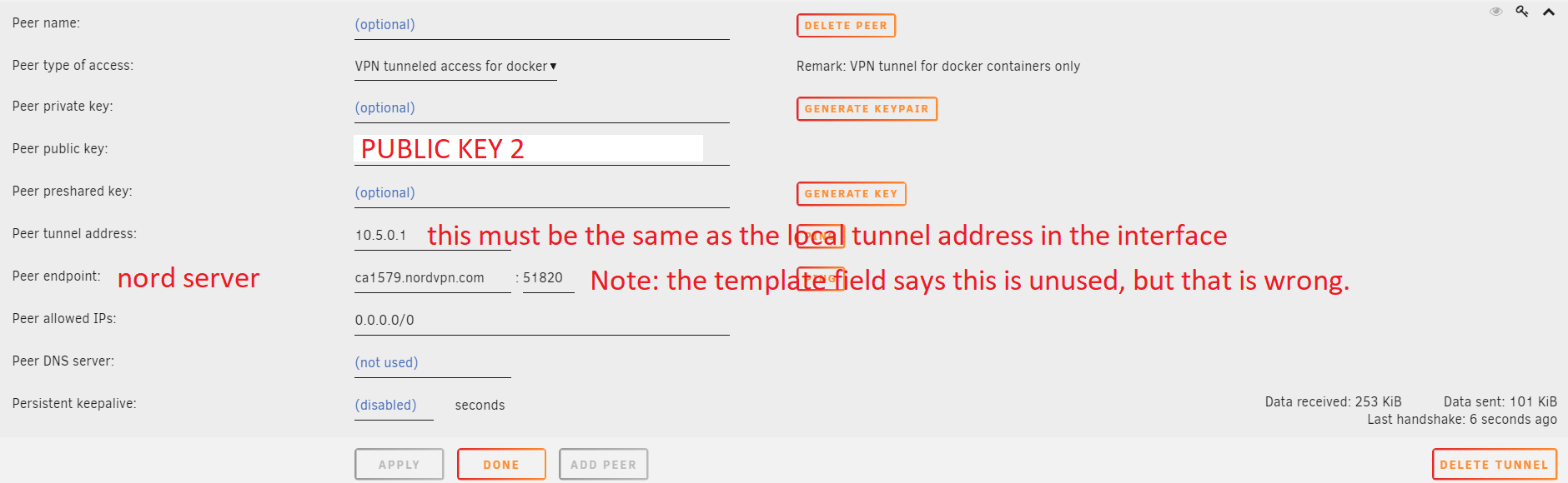

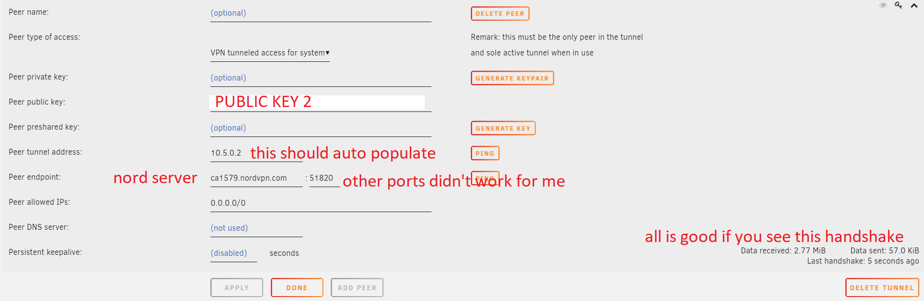

4a. Setup the peer to look something like this (for system):
4b. Setup the peer to look something like this (for dockers):
5. If the tunnel works you should see the handshake like above.  Also, you can sanity test by downloading the firefox docker and assigning the network type to "Custom: wg2" (or whatever wg tunnel instance).  Then you can navigate to what's my IP or other website to verify the VPN address.
