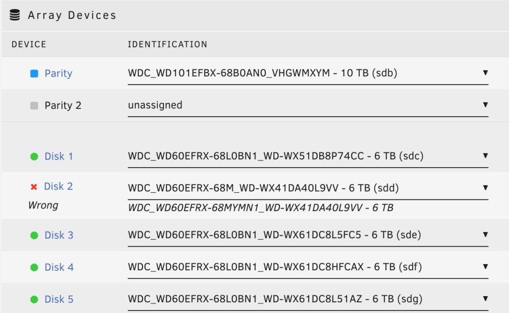

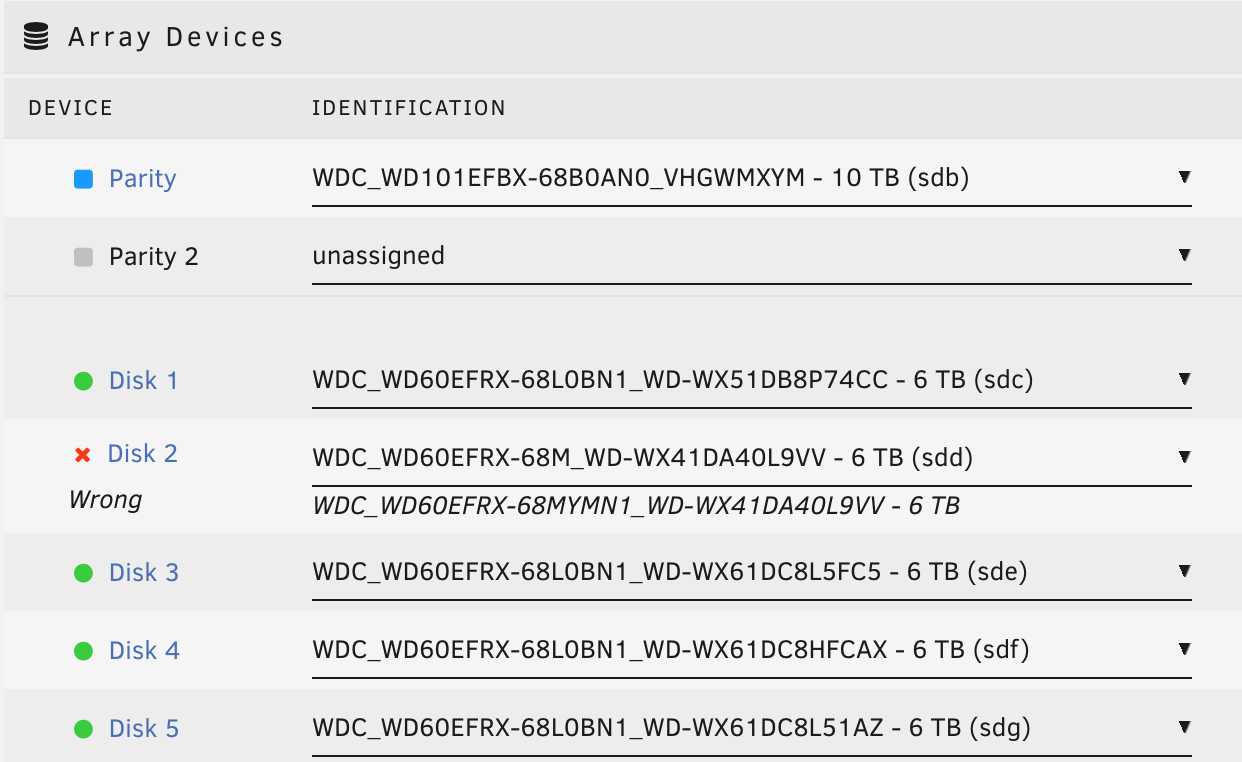

It's been a month now that I have been trying the most basic thing, get my array setup. Haven't even reached creating shares because of this and I'm getting very disappointed in the process.
Sometimes it's the parity disk that doesn't activate, other times it's a drive that gets unassigned, it's simply horrible. I've attached screenshots and diagnostic file.

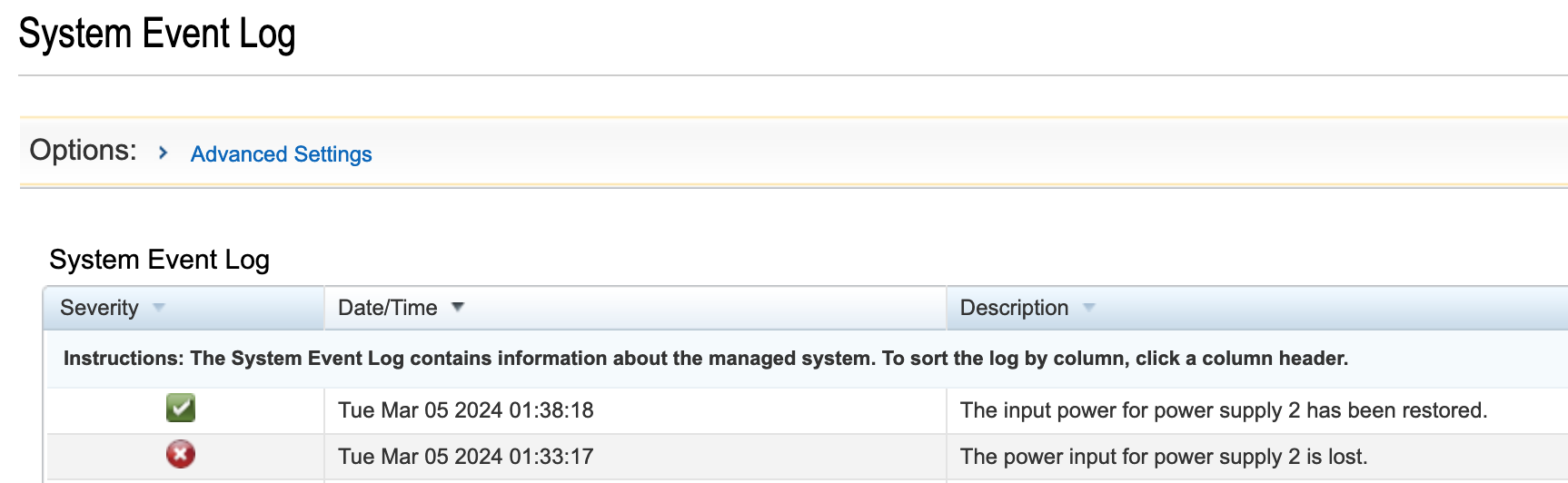

Apologies, just noticed those entries, no that wasn't me. I've checked the server logs on lifecycle, it doesn't show anything of the sort. Last hard reset was on March 5th, there are 2 redundant power supplies, no way anything shut down without me doing something. Looks like you found something else that's pretty odd

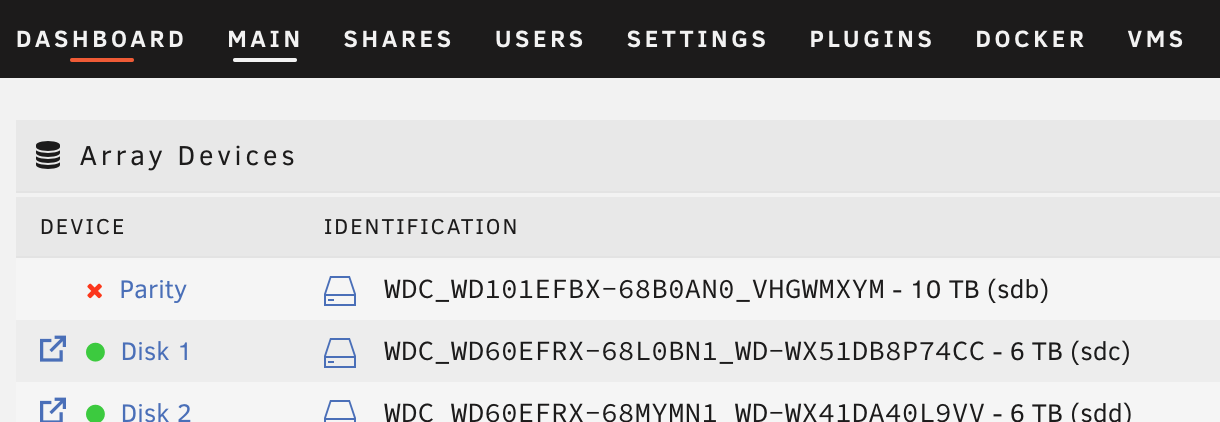

Could be just a SATA cable issue, since both disks are sowing UDMA CRC errors, especially parity.

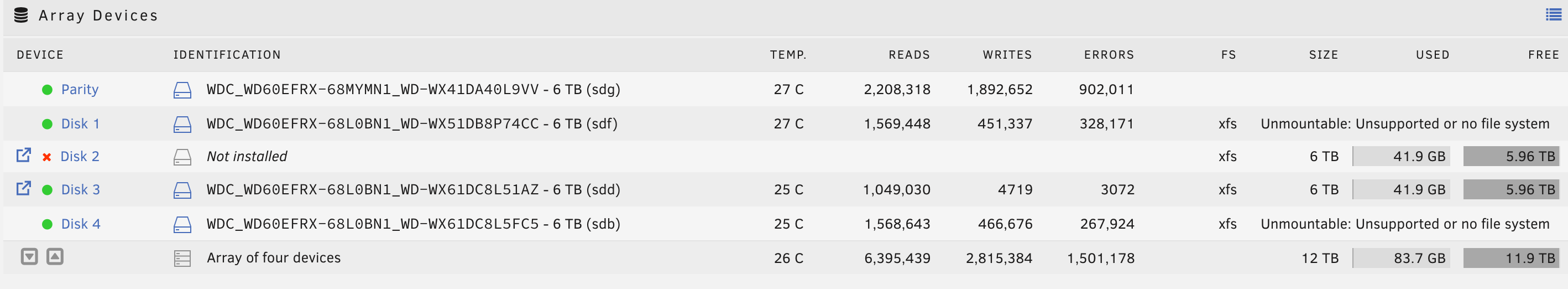

Started over with a new config ,and it's completely different and completely random, look at the screenshot.
I can't format the disks 1 and 4, disk 2 keeps erroring out.

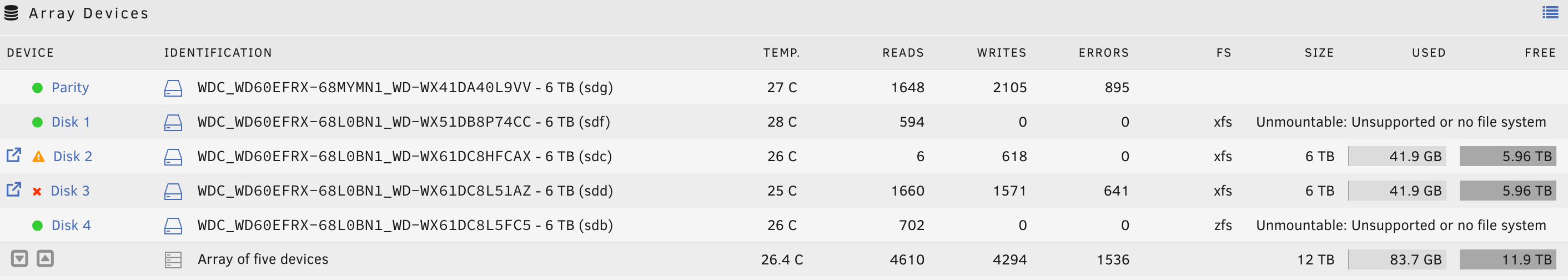

Ha yes, more logic, started a new config, just repeated the array
