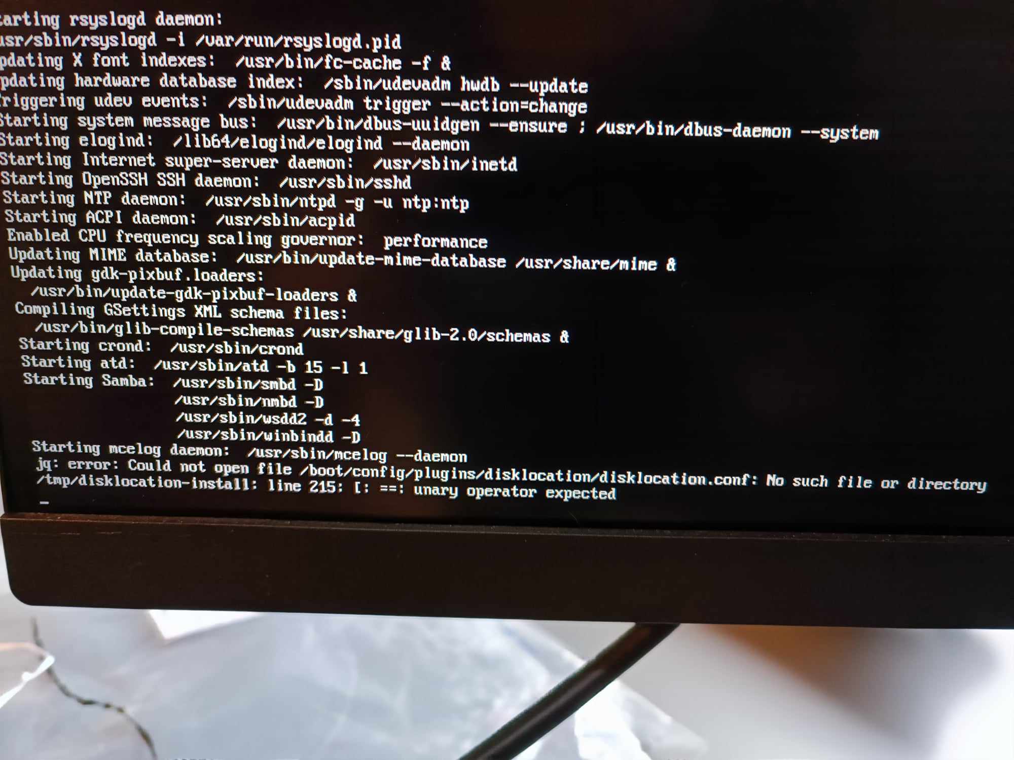

Hi, i just upgraded my server from a threadripper to a 13900k but unraid won't start because of plugin error,
also the usb won't start automatically even if boot device is set correctly.

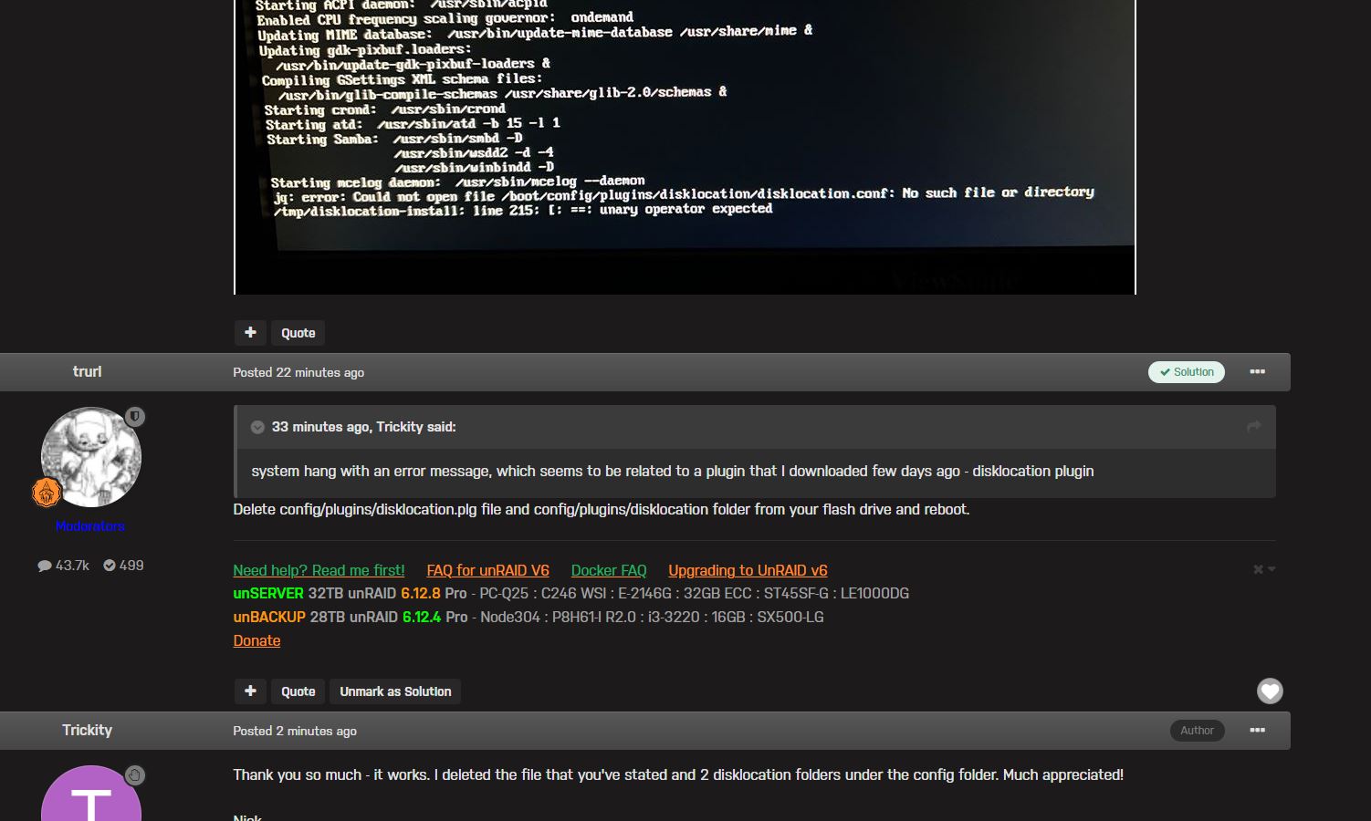

Solved by JorgeB
Try booting in safe mode.
it works in in safe mode but can't delete plugins
I thought to share with you the solution that the moderator helped me this morning. I had that exact error and it is ok now. Please see attached image.
I have already solved it myself, in the same way, thanks
