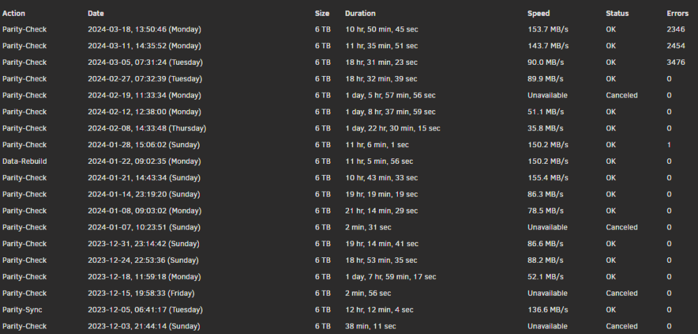

Recently on my last few parity checks I've been getting thousands of parity errors when before I consistently got zero, or 1 or 2. Doing some light research I keep seeing people asking for diagnostics files, specifically after running a parity check without error correction. I've done so, but having trouble seeing someone also explain where to look for the info on what's at error.
Could someone help me figure out what is causing parity errors, and really I would like to know if you could point me to where specifically I should be looking to where the errors are occurring? My uneducated guess would be a hardware issue. There are no reported errors on any of my drives though.
Attached is diagnostics I ran recently with error correction off. Below is also a history of my parity checks. 3/5 and 3/11 were error correcting, and once I saw it repeat with similar error count I ran 3-18 without error correcting.

The two logged parity checks have the same errors, at least the logged ones, reboot to clear the log, then run a correcting parity check, then a non correcting one, all without rebooting, if the second one finds new errors post new diags.

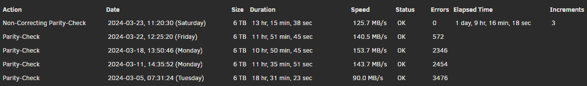

So interestingly enough, after the 2nd non correcting parity check, no errors. Which is weird because I was consistently getting them from the checks before. Attached the new diag, though. Also I see the history tells you whether it was error correcting or not. I thought I unchecked one previously but apparently I didn't, because this shows the only non error correcting one being the one I just did. So I guess for now I wait and see if the errors resurface.

That will be because you had the Parity Check Tuning plugin installed at the time the most recent  check was run.   The earlier checks which do not show the type of check would have been run before installing the plugin so there is no indication of what type of check they were.
Second check not finding errors suggests everything is OK now, but keep monitoring tor the next checks, you can also reboot and run another one, since some sync errors issues only show the problem after a reboot.
I did an additional parity check and its also zero errors again. Not sure exactly why I suddenly saw repeated large parity errors and it then went away. I will say that I never rebooted the server in between those so the only thing that's changed is that I fully shut down and restarted the server and then the parity errors stopped showing up.
