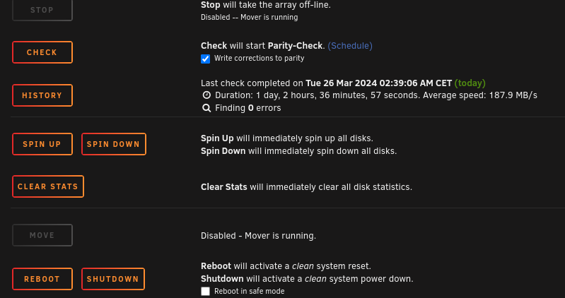

Hi there,

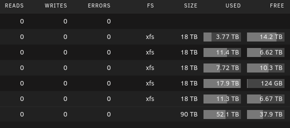

I am trying to move data to reset my configuration for my cache pool. Started mover and it moved some data. Now there is zero activity on the drives and the mover button is greyed out. I reset the stats to see any changes but nothing happens.
Solved by itimpi

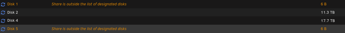

That shows that those shares have some files on cache. It doesn't show that appdata, domains, and system no longer have any files on the array.
I want to keep that shares on my cache drives only. I checked the disks of the server and could not find any "copies" of these folders/shares. Is there another way to check?
You should want appdata, domains, and system shares with nothing on the array so Dockers/VMs will perform better and so array disks can spin down since these files are always open.
On the User Shares page, you can click Compute... for a share to see how much of each disk/pool is used by a particular user share.
Yes, appdata, domains, and system shares are only on the cache drive.
edit: but I found this:
These are emty folders on the disks. Is it safe to delete them using mc?
Edited by Civic1201
yes
