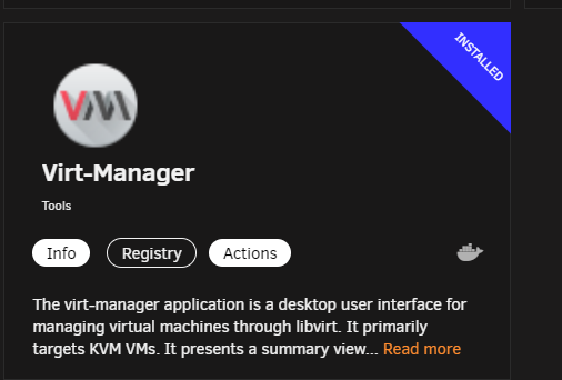

I cannot find this virt-manager in the APPS, and have no idea how to instal it. But a youtube video I found looks good.

virt manager is in CA its a docker.

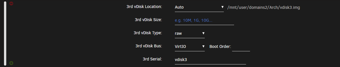

And I did send in a feature request about being able to change the type of HDD when you manually add it (QCOW2 RAW). And showing information about he chosen image.
it was not responded to and most likely never will be.
Edited by teitur
You can select image type when you add and in the next release will change the extension from img to qcow2 when you create new disks.

How about when you manually add an existing disk?

Used to be on there as it is installed on my machine. Will see where it is this is the docker location https://hub.docker.com/r/mber5/virt-manager
Will need to check code but if you had ext of qcow2 it will be set that way and raw for .img
Which is a problem when unraid itself creates files with the .img extension even when you set the type to qcow2.
Edited by Kilrah
Not in 6.13
Welp, we don't have that :D Good if it's fixed, but can't guess.

put this file in /boot/config/plugins/dockerman/user-templates/ you should be able to select from My templates. Not sure why not in CA now.
my-Virt-Manager.xml
Thank you very much.
I love this manager and im utterly amazed Unraid does not have this as the default VM manager.
For those not so good at linux (like I am)
usually you can use wget to download files, but not this link.
So download the file to your computer, then use the Unraid file manager (Dynamix File Manager) to upload the file to the server from your computer. Now I dont know how to navigate to the root directories in the file manager so just put the file in some directory then go to Terminal, find the file and use the command
cp my-Virt-Manager.xml /boot/config/plugins/dockerMan/templates-user/my-Virt-Manager.xml
I dont know if you have to, but I rebooted Unraid, then go to Docker add container and virt-manager is in the template list.
