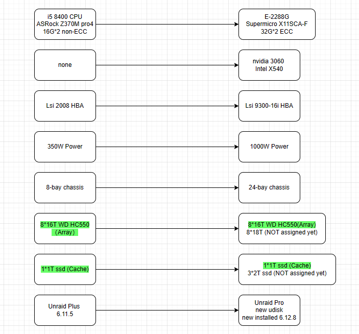

I updated my NAS recently, the hardware changes are listed here:

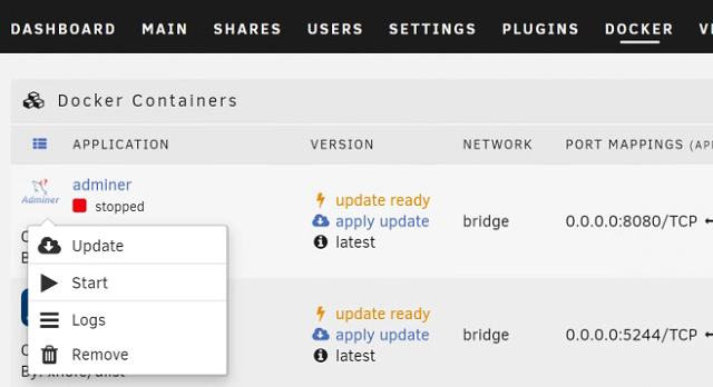

I can start stop the dockers, BUT I CAN NOT edit or update dockers. No edit option.

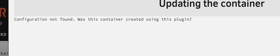

When I want to update the docker, it says "Updating the container
Configuration not found. Was this container created using this plugin?"
Where are the Configuration above? they are not in the docker.img file?
