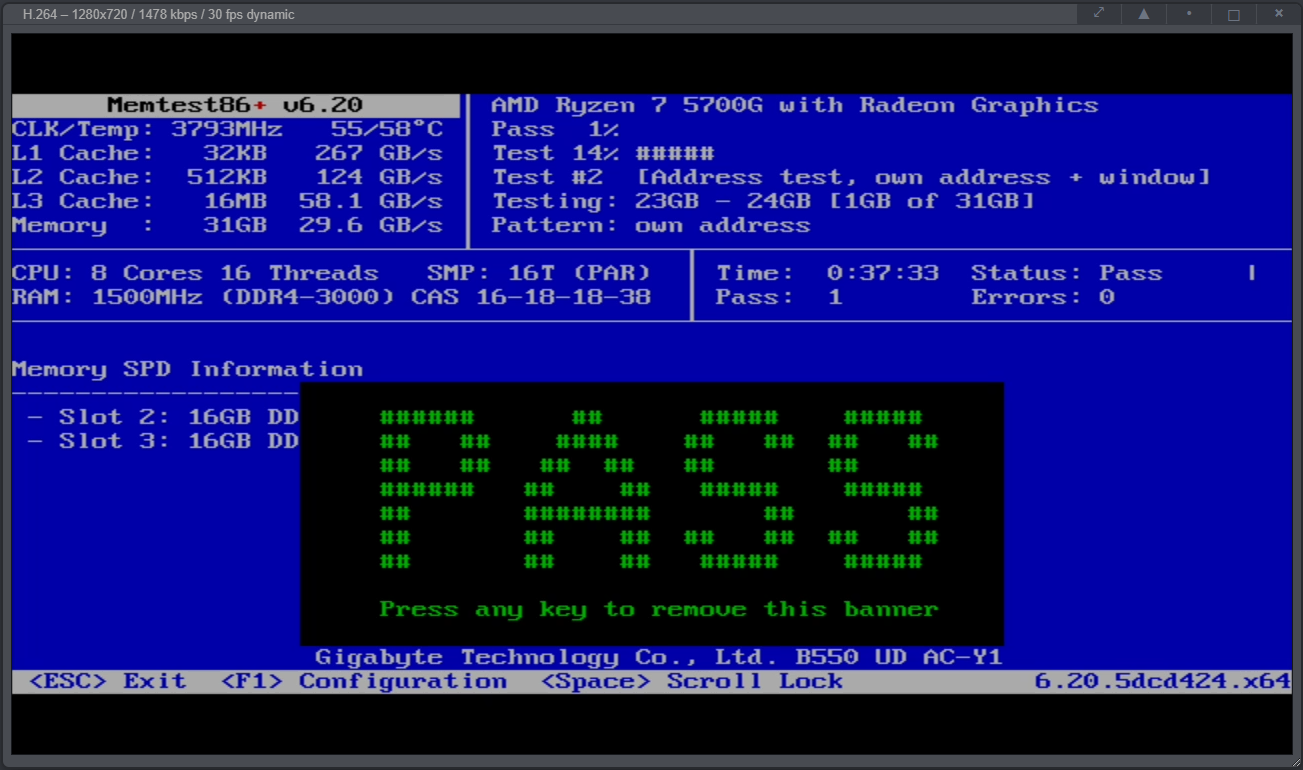

I have run memtest for around 30 mins, and it has passed.
Should I keep it running? or is there anything else I should be checking?
Unfortunately memtest is only definitive if it finds an error, you can run it for a few more hours, or alternatively, use just the server with one stick of RAM, if you keep getting crashes try the other one, that will basically rule out a RAM problem.
I have been running memtest now for a little over 3 hours without any errors.
