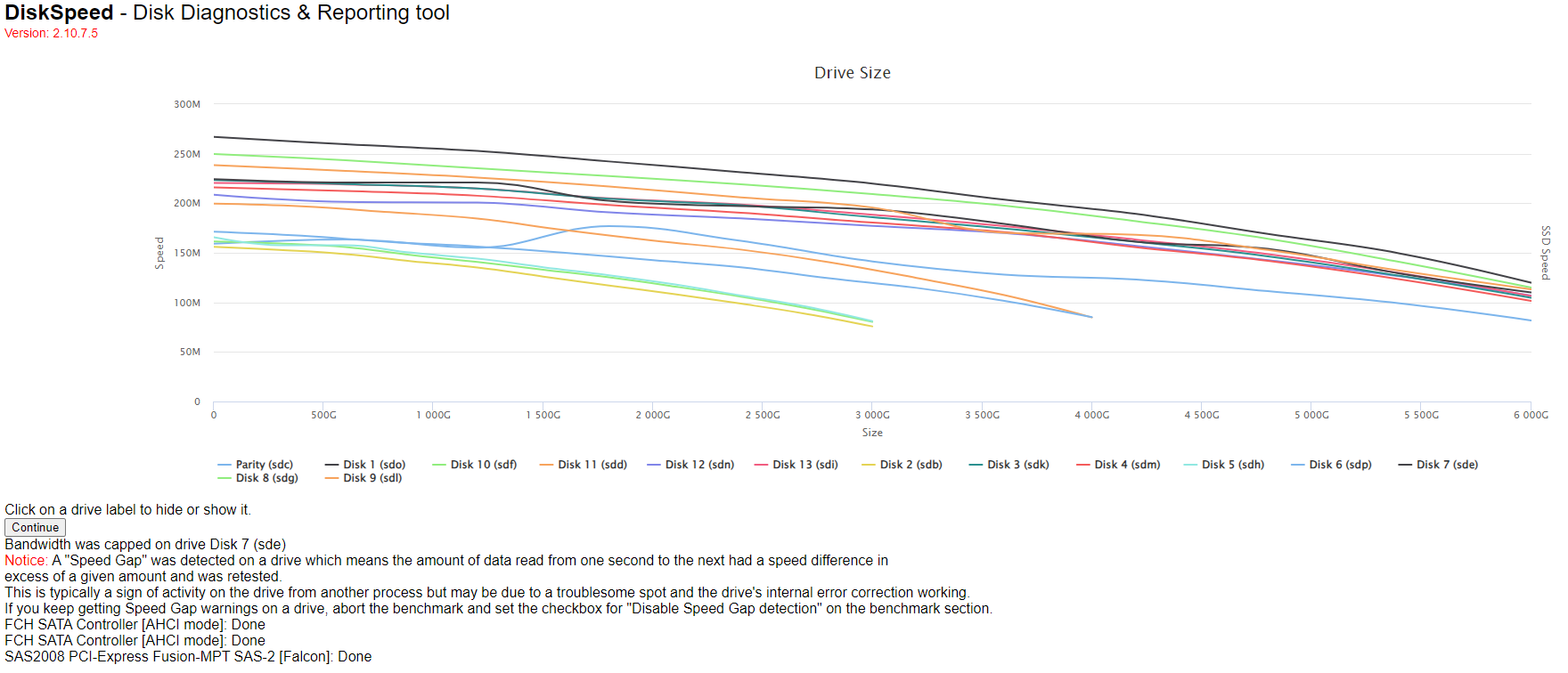

Hi all - running my monthly parity check and it is sooooooo slow all of sudden. I don't see anything obvious in the syslog - but I'm not an expert here and could use another set of eyes. This current setup is a couple years old at least - with a few disks being swapped out of course :)
Nothing looks amiss after running DiskSpeed
