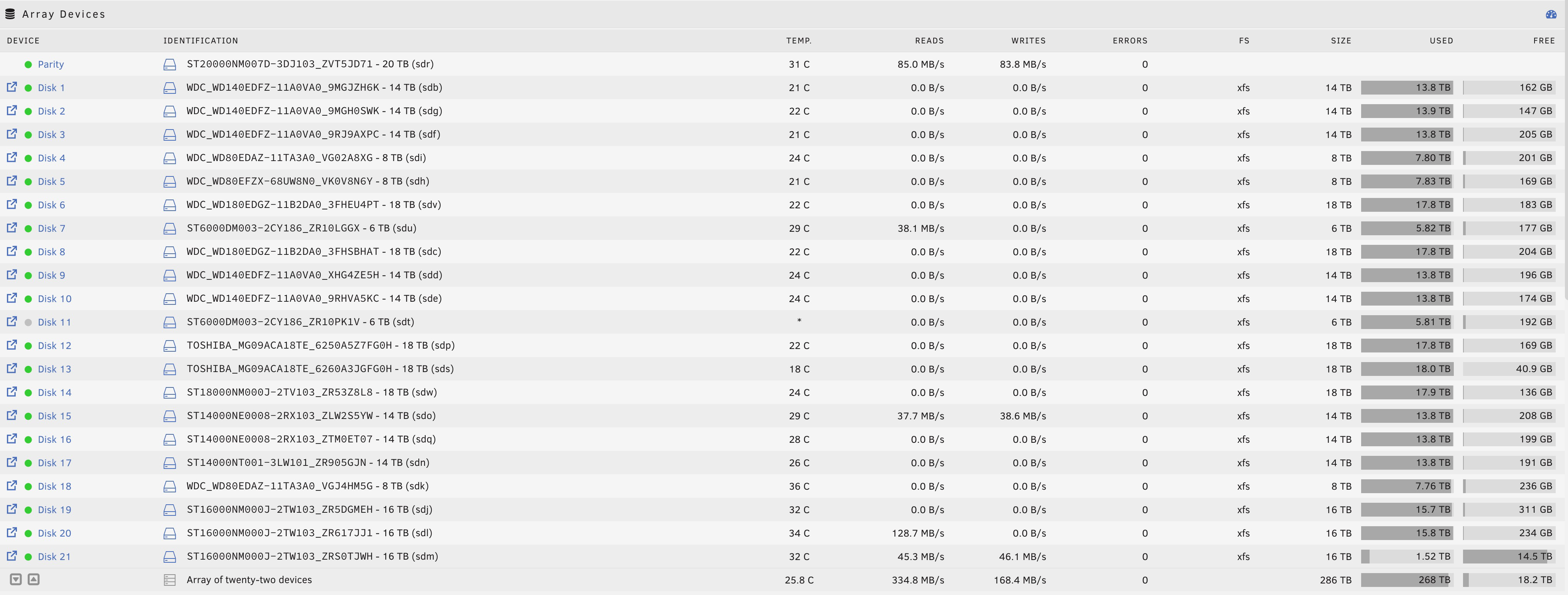

1. here is a recent screenshot I've made of my array :
but here is what the "DISK_ASSIGNMENTS.txt" file on my key is listing :

In regards to everything else, docker, plugins, etc. I don't really mind, but I really would like to get my array back. since I do have my parity drive ID, it must be possible.
it is safe to think this is not the place where my array config actually is stored on my usb stick ? Is it afe to assume I could simply re-flash an unraid usb drive, and copy the whole config folder to its root, and that I4d get all my previous config back in place ?

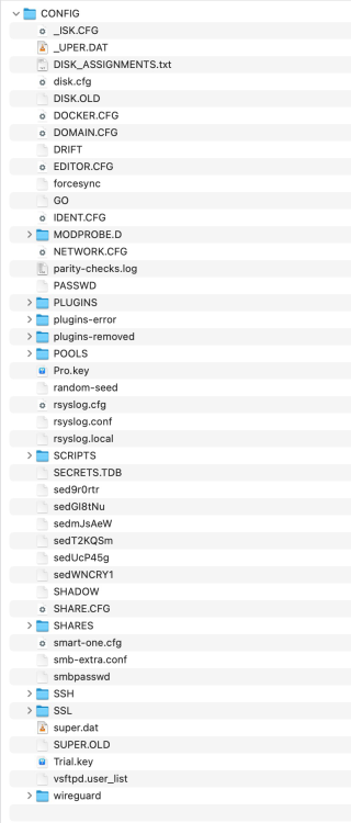

By the way, the data I've got back was recovered by testdisk, and even with a copy result that is OK, it seems like some folders are now in upper case :
I believe this will make things harder...
I think I did enable flash backups on Unraid connect, but fr some reason, when I head there, I keep seeing the Loading message, and cannot see my backups. I also tried using another browser and incognito mode, same result. Is there a chance I could find my "connect" backups somewhere ?
If not, is it safe to pass ALL the folders and files I see in the above list in lower cap ?
FAT is not case sensitive, so it shouldn't be a problem.

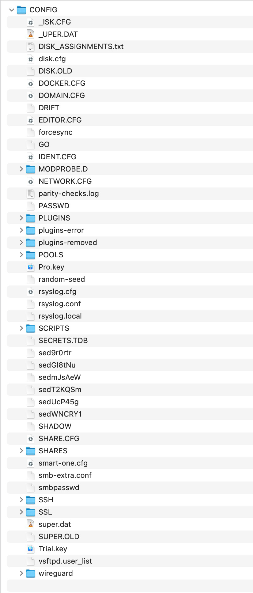

ok well, I am copying the "CONFIG" (upper case) folder I got back from my previous key back to the newly flashed one.
I'll try a reboot in a few seconds.
fingers...and toes...
OK you were right, the server started, all disks are detected, all plugins are running !

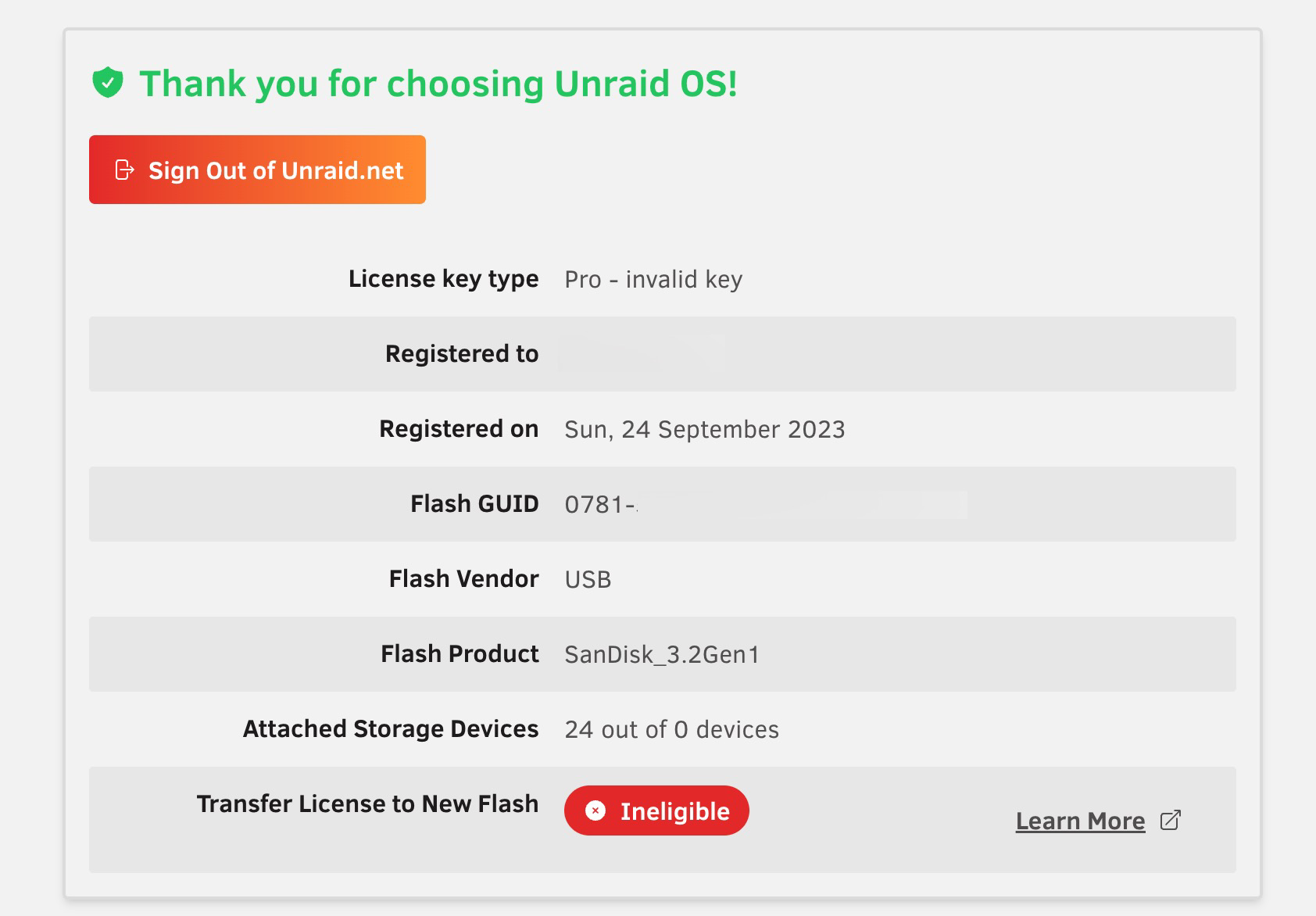

but the array wont start as I already had a usb key failure a few months ago and transferred it to the "new" one that failed as well.
So I guess I made too much key transfers in less than a year :
what now ?
5 minutes ago, meaning said:
what now
Contact support with the detail and they should be able to do a manual transfer for you.
Done. Thanks !
