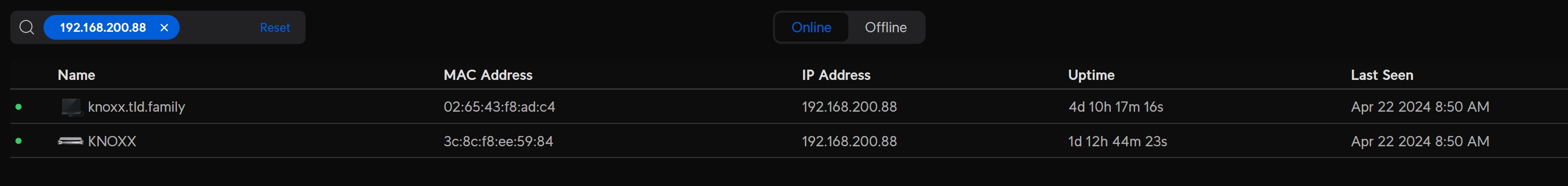

I also still have the duplicated IP warnings in my Unifi. I have gone through every post outlining fixing the MACVLAN networking issues that all claim to solve both the freezes and the duplicate IP warnings, but to no avail.
I should add that after following the post below, I am unable to contact the host system from my Homeassistant VM. I can't ping it or map network drives to any content on the host system from within the VM.
I'm happy to provide screenshots of network and docker configs and any log files that might help diagnose this once and for all.

It's these VHOST NICs (both have the same MAC addr)  that are showing up in the Unifi logs as sharing the same IP as the UN primary NIC.

Just to clarify so we are all on the same page, it is 02:65:43:f8:ad:c4 (vhost0@eth0 & [email protected]) that is being reported on Unifi as having the same IP as 3c:8c:f8:ee:59:84 (eth0)

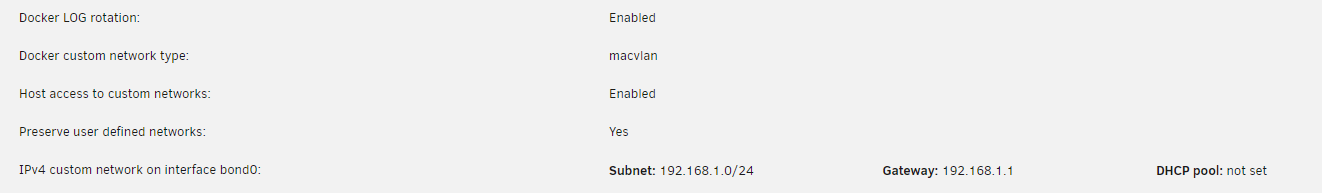

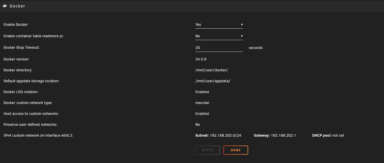

We need 2 pictures of your settings in unraid.
1. Advance docker settings:
--We need to know Docker custom network type / Hast access to custom settings...

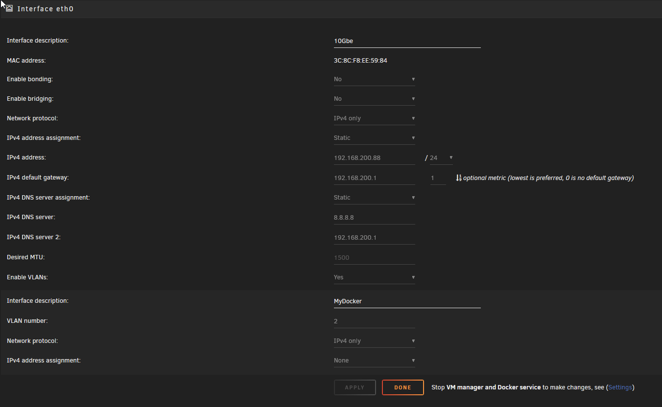

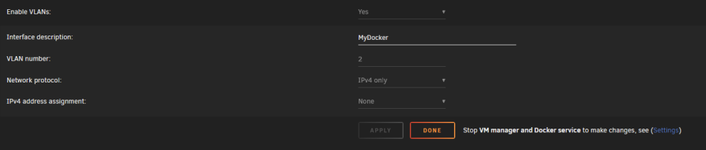

2. Network tab:
--We need to know if you have bridging on or off. I need to know if you are using bonding.
Especial with the vlan 2 that you have setup on eth0 interface...
It appears that your vlan 2 is getting taped for docker macvlan instead of eth0 directly...
To clarify, eth0 would need promics mode on. Not just vlan 2.

If I were to guess. I believe you have bridging and bonding off. Since you are using vlan and want to use vlans I recommend enabling bonding.

I'll have to wait and see if the duped IP warning pops up again. I'll post back if I see anything.
Thx for helping out!!!
Hmmmmm........Nope. No dice!
One thing I will say has changed is it is much more stable in showing up in Unifi now. It used to pop up now and then and then disappear for a bit. Now it's there full time and never goes away.
(but would a reboot be needed to clear anything out?)

I don't mean to be confrontational bmartino1, I appreciate your trying to help. But I'm not sure what the concern is with how the VLANs are set up on the UDM. All the services on that VLAN that are served by Unraid work just fine across the network. All of those containers on that VLAN show up as individual clients in the Unifi Network UI, with unique MAC addresses, just as I wanted them to. Also Spanning Tree is for network loops across switches. It would have no bearing in this situation.
The settings on the UDM would have nothing to do with the UNRaid server assigning the primary NICs IP to the vhost0 interface. That is what is causing the 'duplicate IP/different MAC addr' problem. This is NOT just shown in the Unifi Controller, it is clear in the CLI output on the UNRaid server itself. NetworkChucks video shows the MACVLan network he created does not have an IP assigned to it at all. So why is UR assigning that IP?
Perhaps this is a side effect of the workaround for the MACVLan freeze issue in the linux kernel that came out a little while ago. That is when I started seeing this issue pop up. Once I went through the workaround setup, this behavior started.

Let me clear up the confusions.
First, I have and always have had the system running in MACVLAN mode.
The actual problem is the primary NIC VHOST (vhost0) is being assigned the same IP as the primary NIC. The primary NIC and vhost0 each have unique MAC addresses.
As such, the network has two systems with different MAC addr using the same IP addr. The cherry in top being both systems are plugged into the same physical network port!
