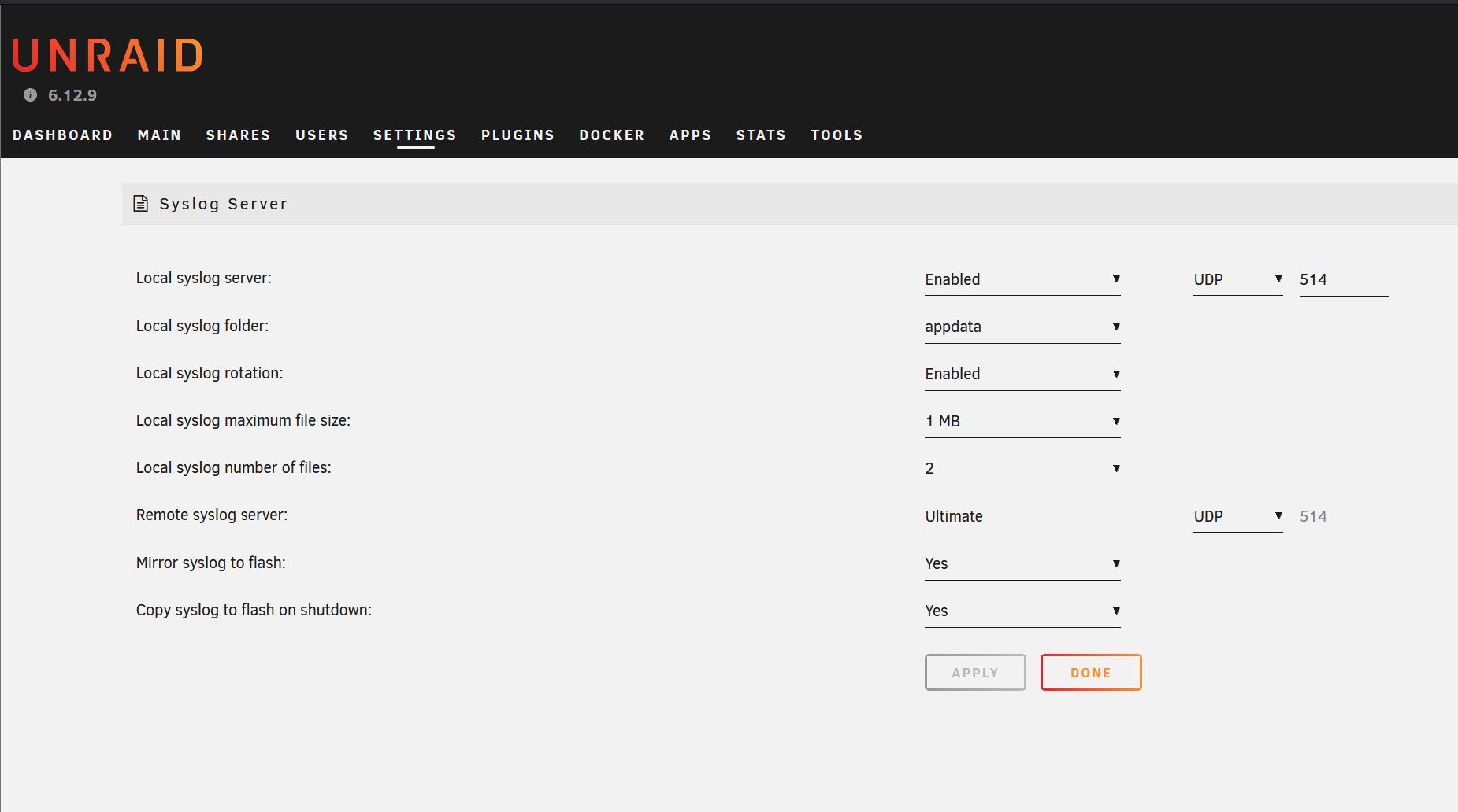

It might be worth posting a screenshot of your syslog server settings so we can check them
Ok, here is the screenshot.
Thanks

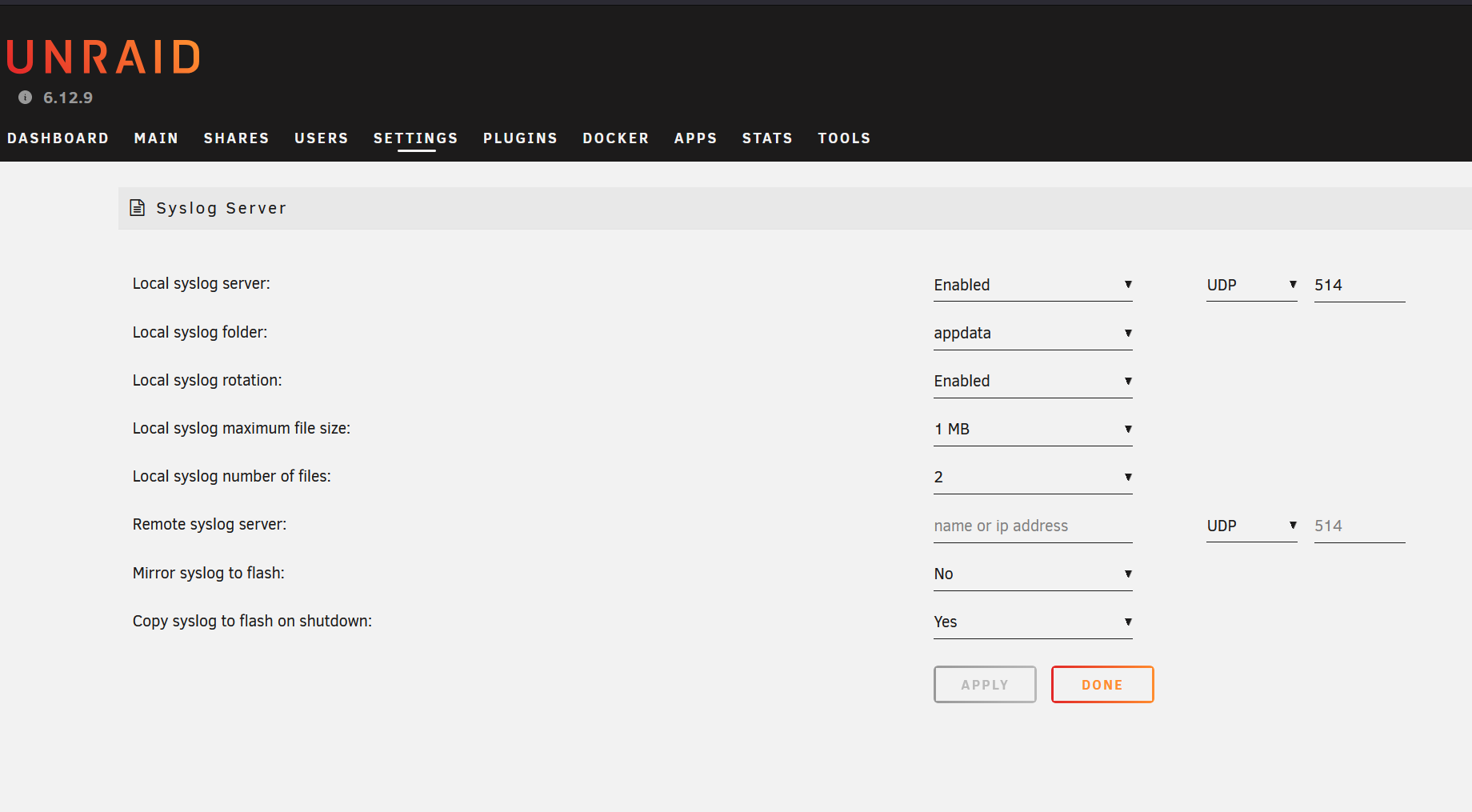

Those show that server is in ‘listening’ mode.     As the syslog server link mentions you need to set the Mirror to Flash option or put your servers address into the Remote Server field to actually get anything written.
Ok, I will make the change. It will probably be a week or two before another crash happens. I will post again after the next crash.
Thanks
Here are the new SysLog settings.
With those setting you end up with the a syslog fole in the ‘logs’ folder on the flash drive and in the ‘appdata’ share.    The file from the ‘logs’ folder is automatically included in any diagnostics.

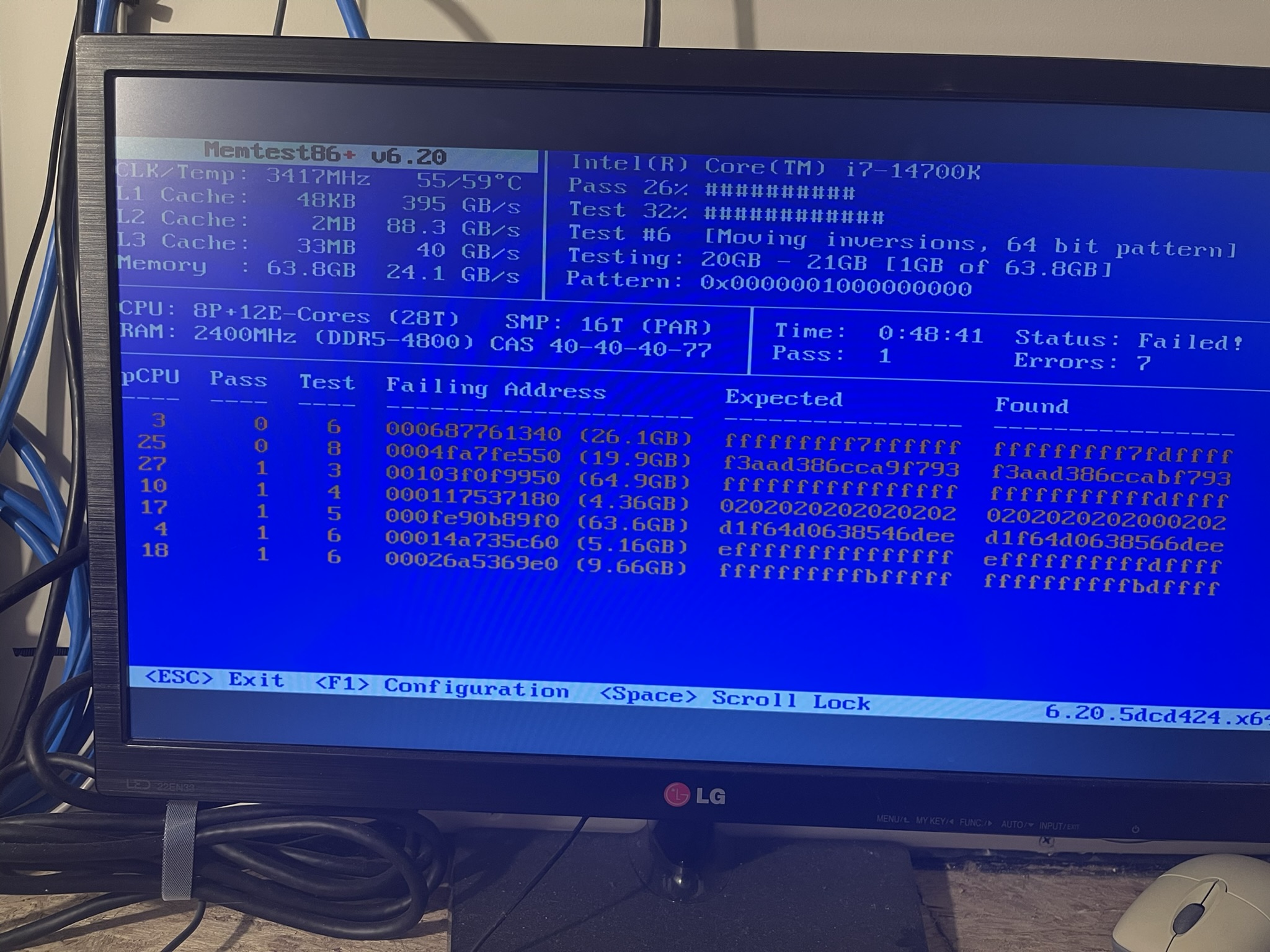

Constant call traces, start by running memtest, if nothing is found, and because memtest is only definitive if it finds errors, try with just one stick of RAM, if the same try with a different one, that will basically rule out bad RAM, if issues persist, another thing you can try is to boot the server in safe mode with all docker containers/VMs disabled, let it run as a basic NAS for a few days, if it still crashes it's likely a hardware problem, if it doesn't start turning on the other services one by one.
Looks like a bad ram stick, I ran memtest86 with one stick and memory passed. When I put the other stick in and ran memtest86 with both in it is showing failures. I have opened a ticket with corsair.
