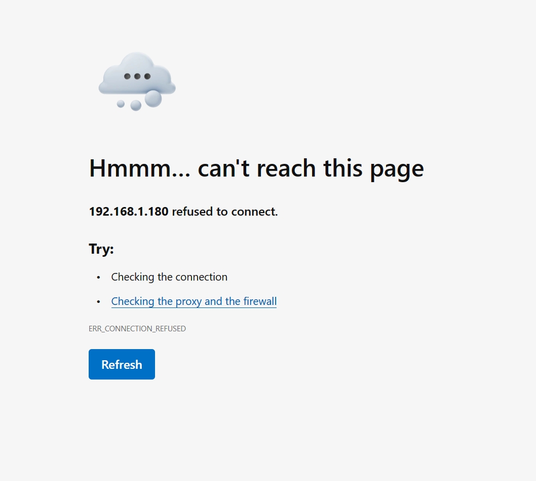

Web UI connection refused. SMB/ SSH access ok

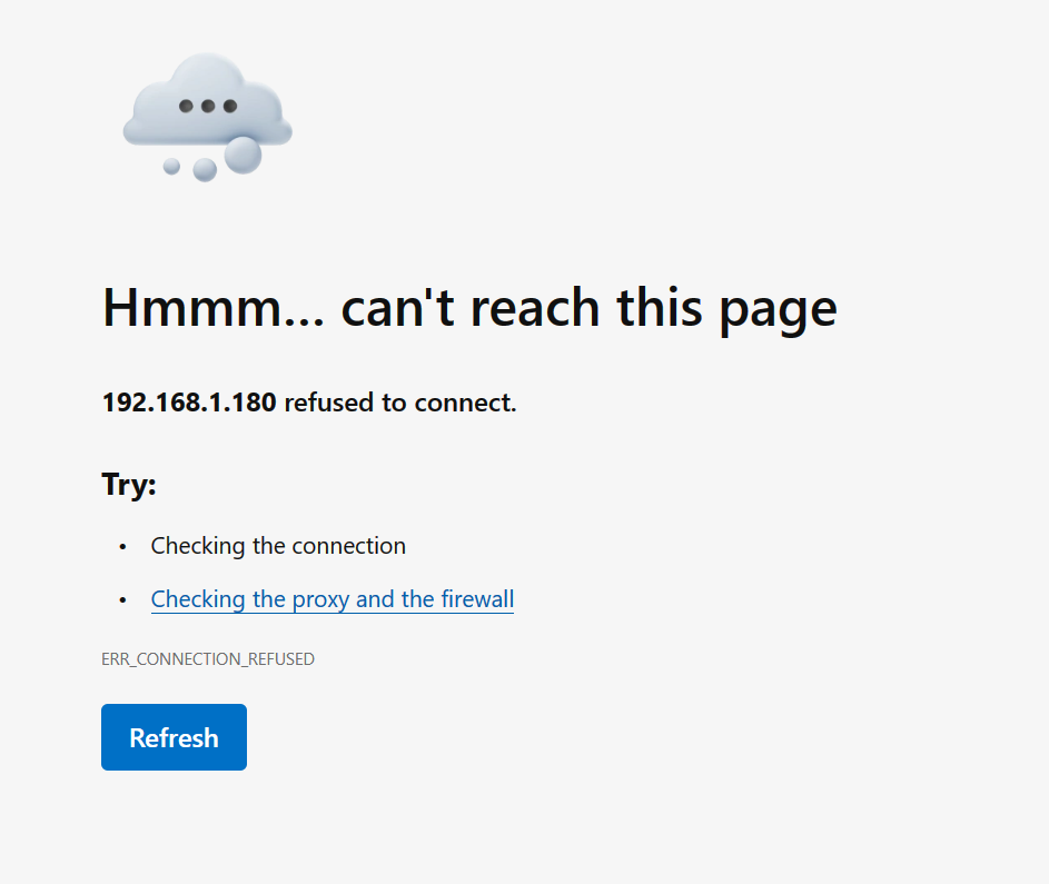

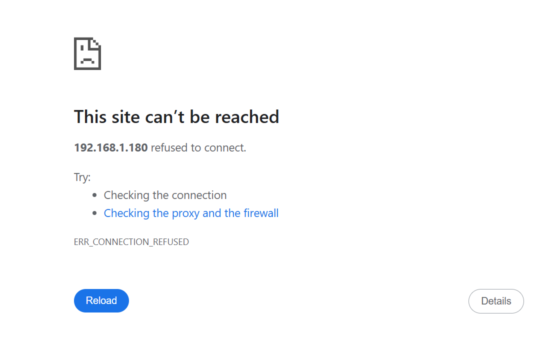

Hello! I'm farily new to this and would really appreciate your help here. Until recently, I had no problem accessing the Web UI either through the the static IP address or tower/main. Since a power outage few months ago I have not been able to access it whatsoever. The browser just shows "connection refused" (see attached screenshot). I can access SMB on my win machine and connect via SSH/putty (attaching the diagnostics here).
I researched all the forum threads but none of the solutions works. Can someone please help? Let me know if I could provide any additional info. thank you!!!

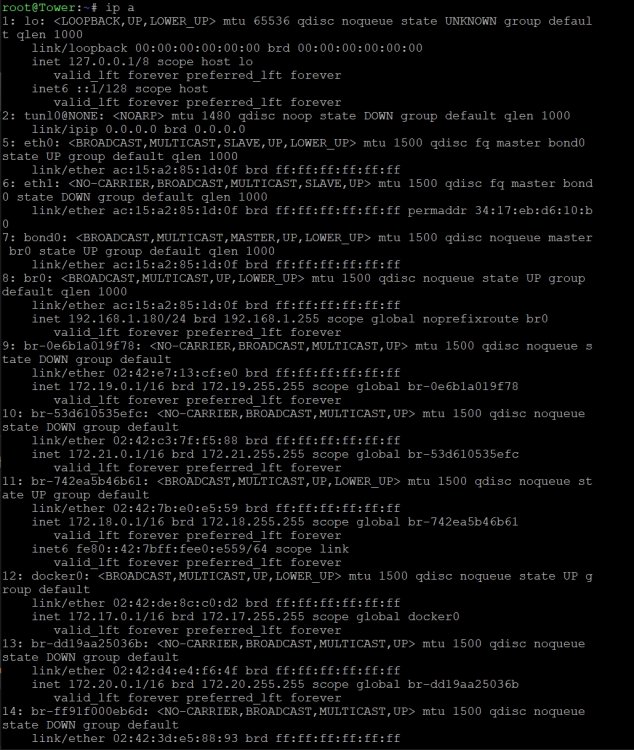

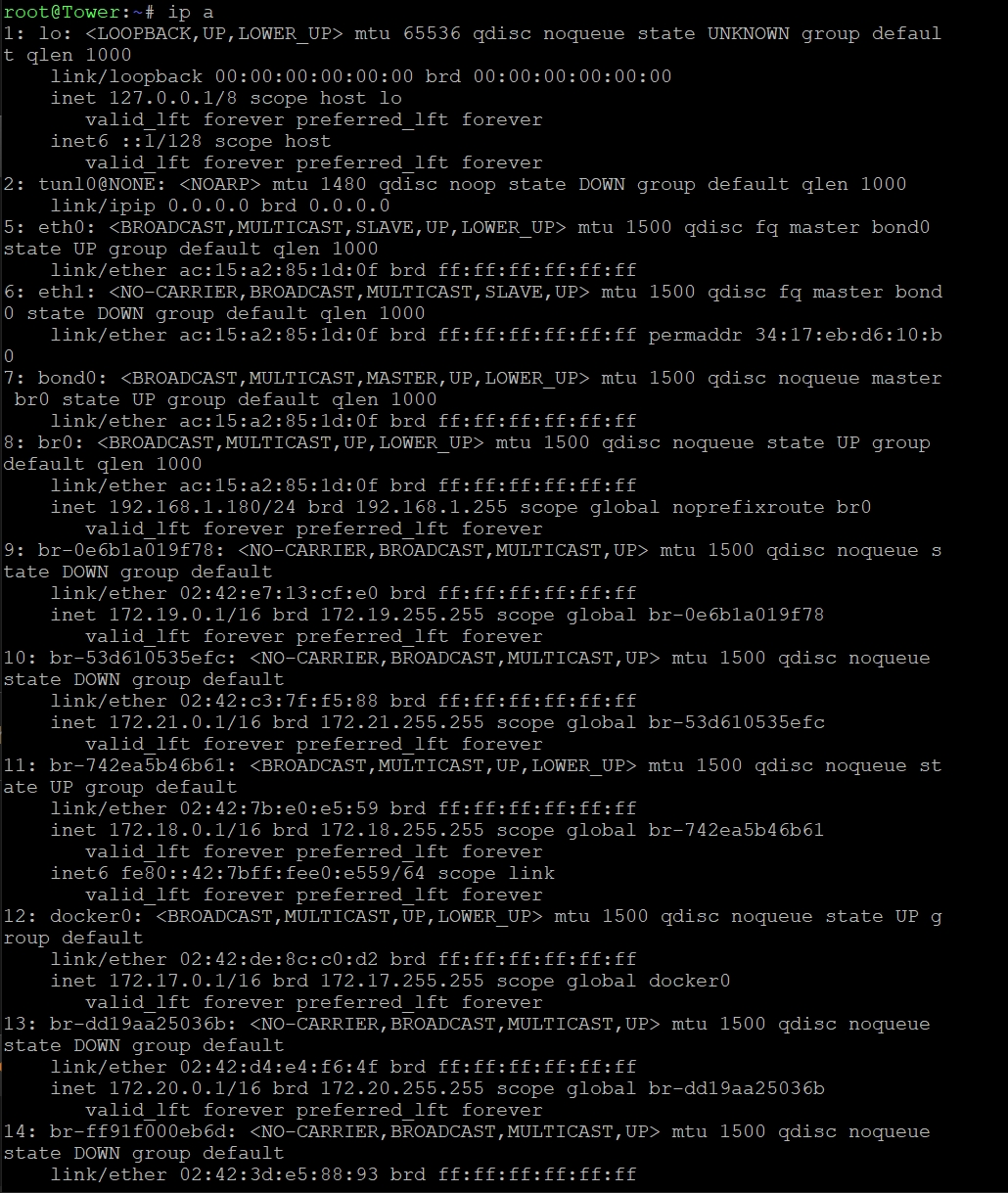

whats the current output of terminal command ip a

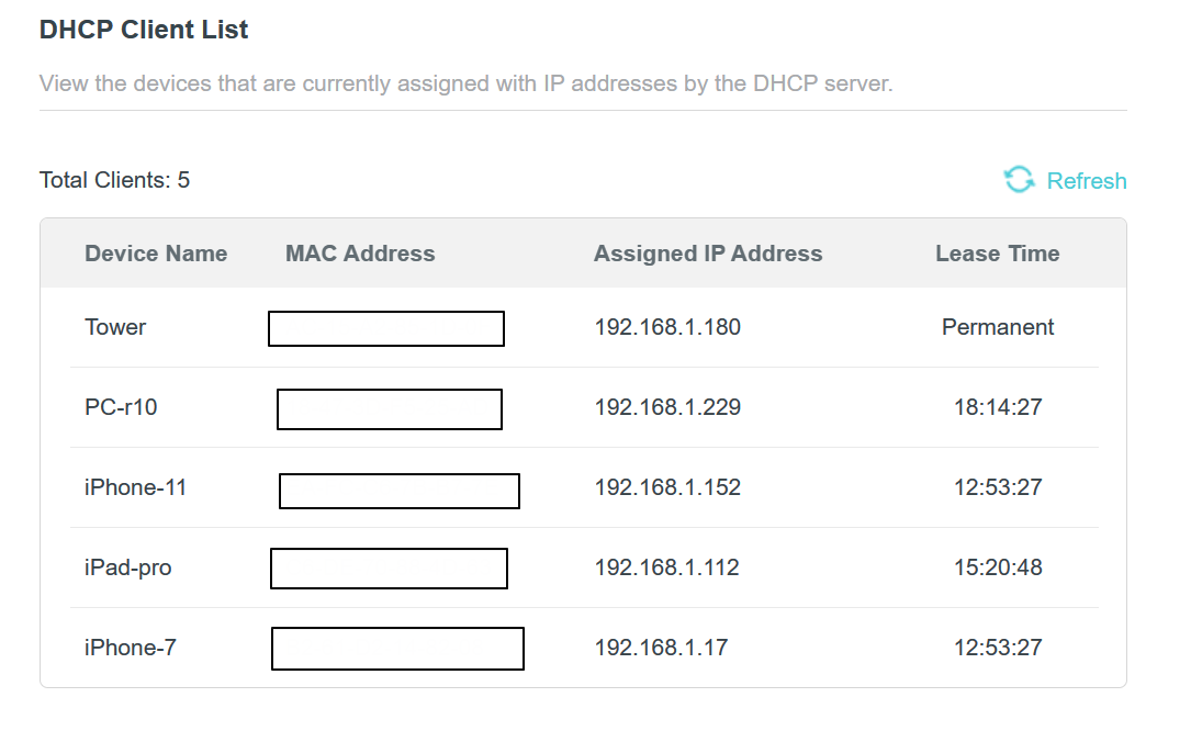

Not sure what this means but I have set a fixed Ip address 192.168.1.180 from my router.  I'm 100% certain that this address is not used by any other devices in my home network. Do you think reassigning to a different ip address could be the solution?
Here's a screenshot from my router if it helps
power cycle all the things. the error even with a permeant address is that 192.168.1.180 is in use on the network.
If you turn off unraid can you ping 192.168.1.180?
Terminal is the command line on unraid at boot or if able to ssh into the system to run linux commands. ip a display all your interfaces and current IP assignments..
You may have grabbed the wrong interface address for unraid static ip... Delete the network config in the config folder on the flash drive and let unraid rebuild the network settings...
Gotcha! Thanks for bearing with a noob.

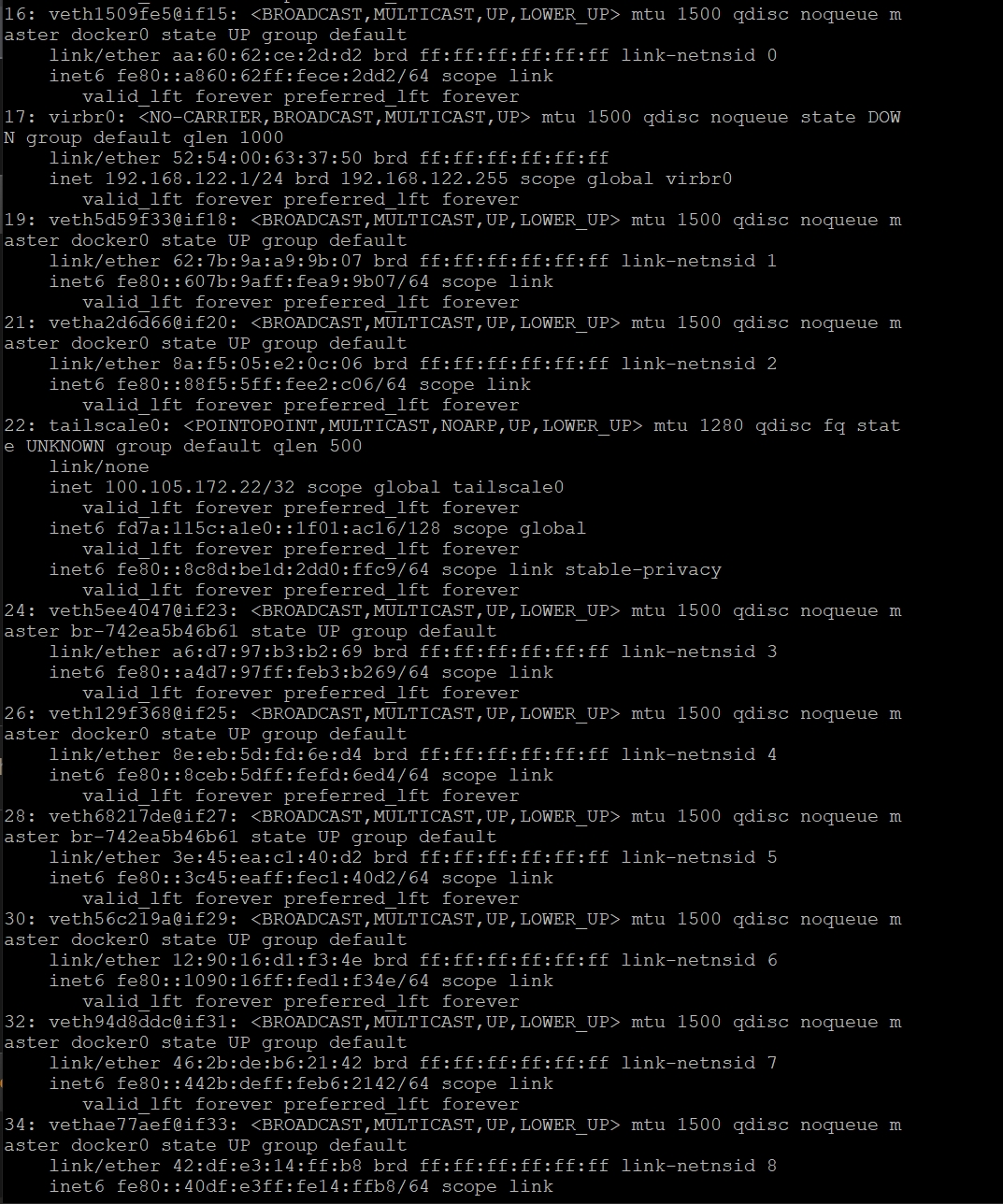

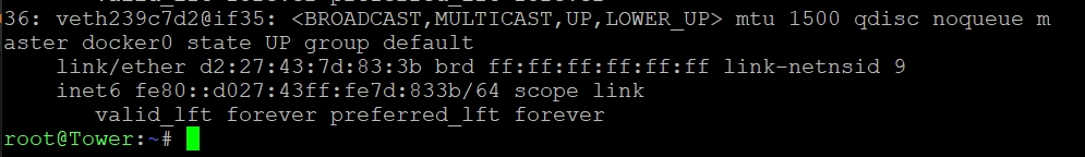

This is what i got from ip a. No idea what I'm looking at. Do I want to go ahead and delete network config file?
I confirm the ip address is set to Unraid server's mac address.

try in browser to see if you can hit a specfic web page:
What web browser are you using to connect?
https://192.168.1.180/login
http:////192.168.1.180
https://192.168.1.180/Dashboard

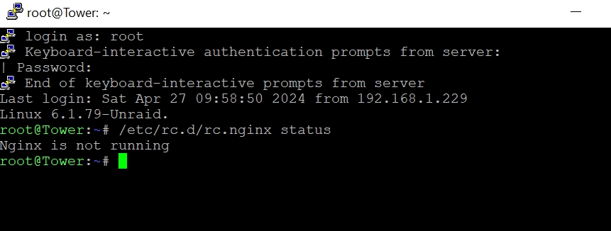

in Unraid terminal, what is the output of
/etc/rc.d/rc.nginx status

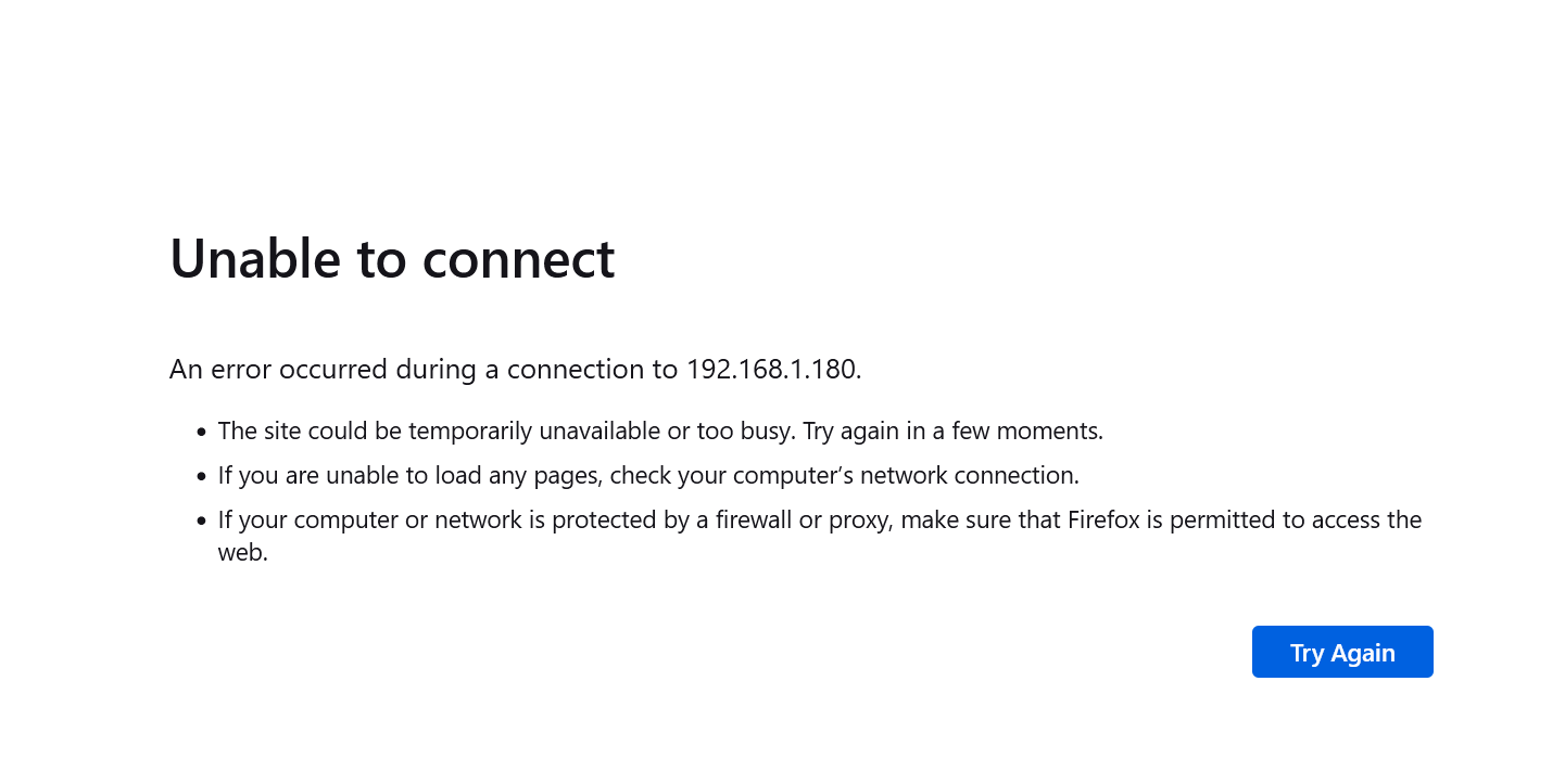

I tried on firefox, chrome and edge but none worked on any of these addresses.

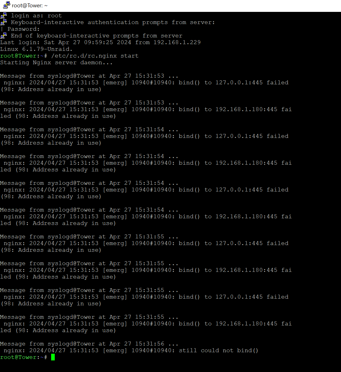

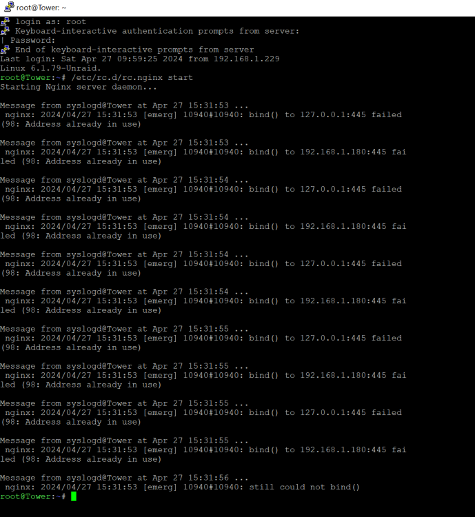

As for the output you asked here you are:
since nginx x is not running and that is the web server, please run command and see if you can access the web gui:
/etc/rc.d/rc.nginx start
its weird that it didn't start. there may be something else breaking in your instance/setup.
hi first of all just wanted to say a big thank you for guiding me through this.
Following your advise this is what I got. doesnt look like nginx started.
ok. somehow you have something running that is replacing the main bind and accesses.

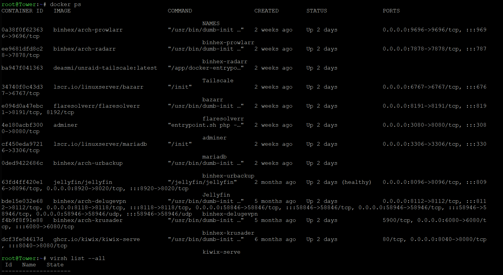

Please run command
docker ps
to list all dockers..
Then stop a dockers
docker stop %name_of_docker%
is it a VM?
https://access.redhat.com/documentation/en-us/red_hat_enterprise_linux/7/html/virtualization_deployment_and_administration_guide/sect-managing_guest_virtual_machines_with_virsh-shutting_down_rebooting_and_force_shutdown_of_a_guest_virtual_machine
To show all VMS:
virsh list --all
shutdown via terminal:
virsh shutdown %VM-name%

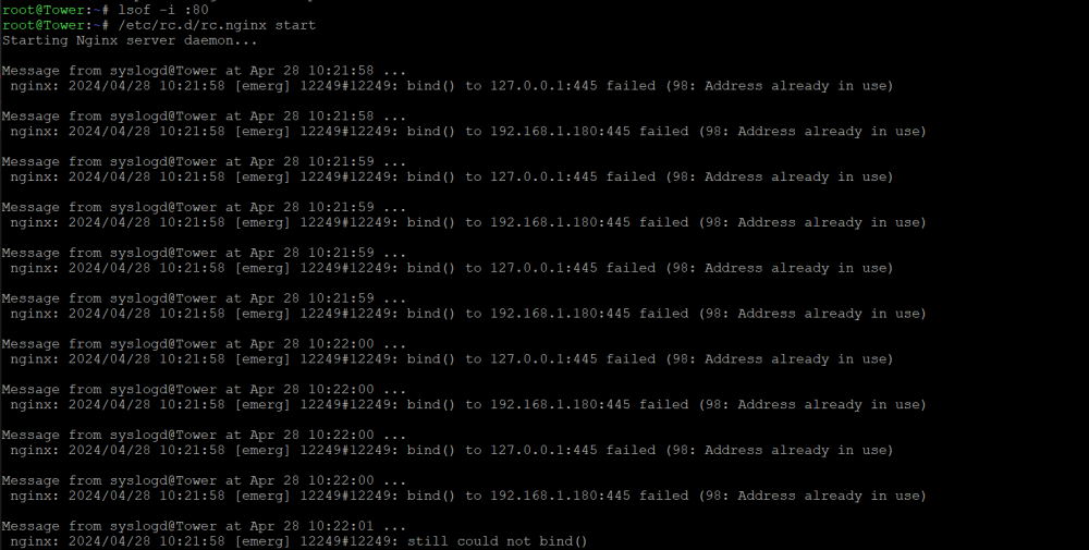

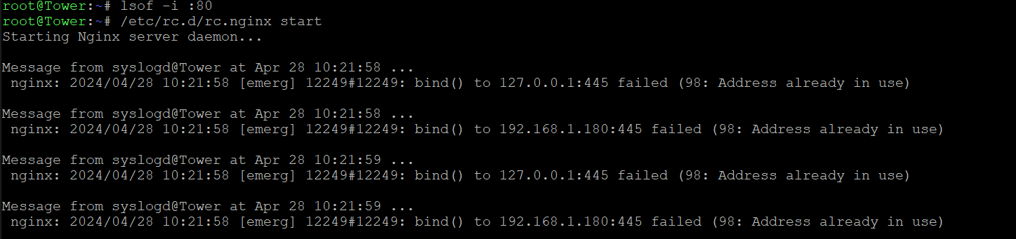

Following your suggestion here's what I got
I confirm no docker is taking the :80 port and I'm not running any VMs.
so isof command shows one instance - tailscale docker, and i killed it.

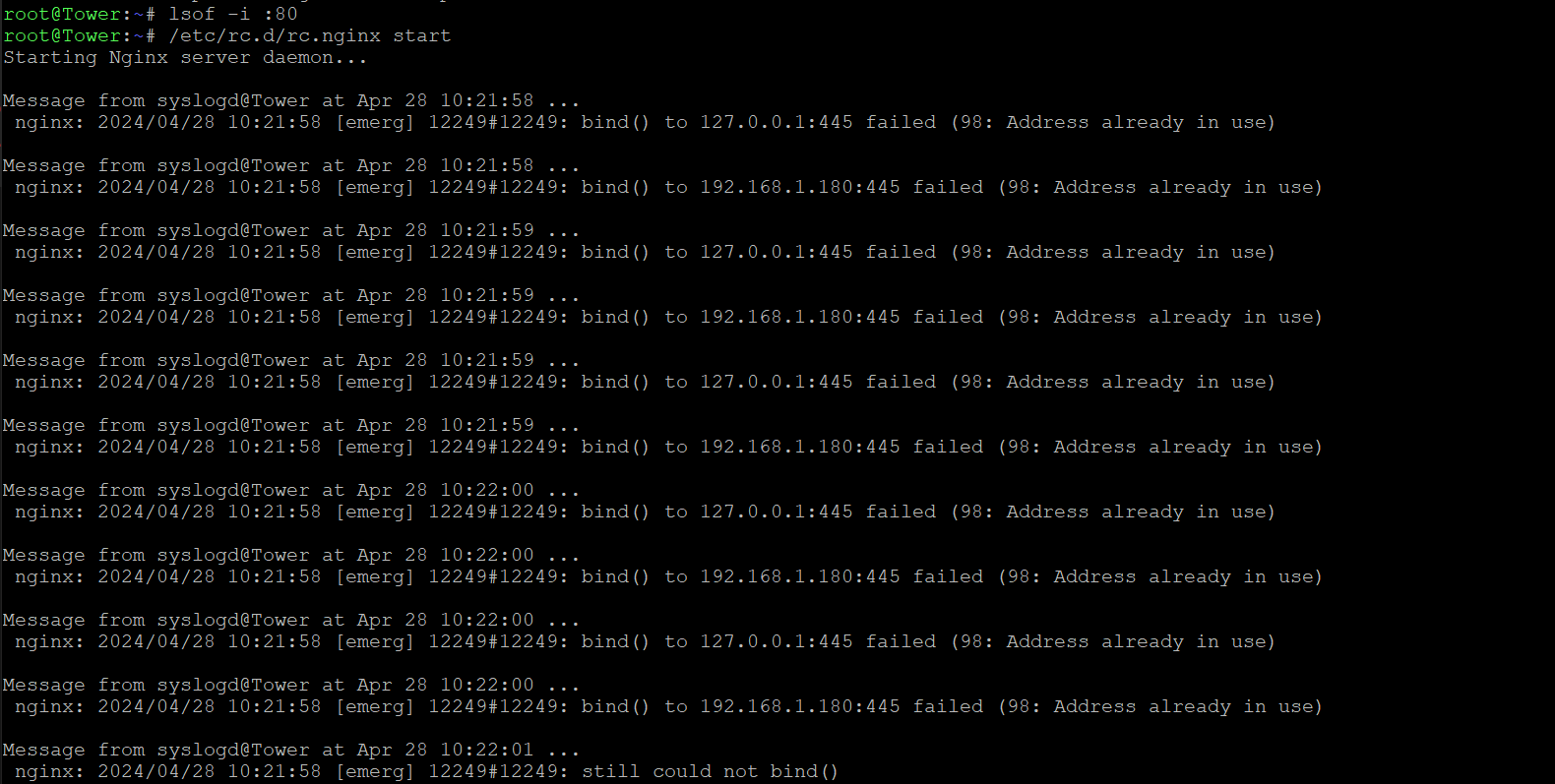

After confirming tailscale is killed using lsof command again (nothing shows up), I tried to start nginx but it still showed address in use....
btw i also tried lsof -i:445 and the output is as follows in case it helps with your further diagnose.
Kindly let me know if I followed all the steps correctly? Thank you so much sir!
Edited by muddyclapton

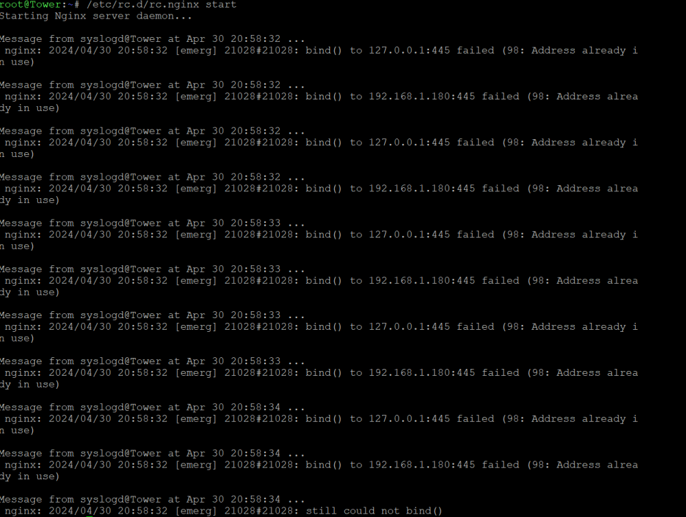

Sorry for the late reply I was occupied at work :(
--quote--
what is the contents of the extra folder on unraid:
/boot/extra# ls
screen-4.9.1-x86_64-1_nerdtools.txz
--unquote--
I'm not quite sure what you meant by this. Is this something I should be looking for in the unraid flashdrive? I tried it in putty but nothing came out of it.

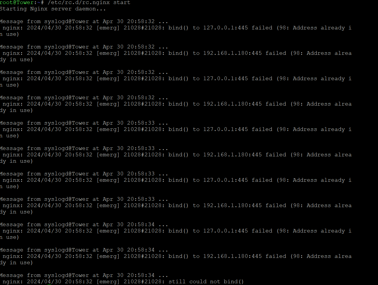

The <tailscale down> command didnt work, but I managed to kill it with <docker kill> command.
At this point I tried the nginx STOP/ START commands but got same error messages as previous post:
