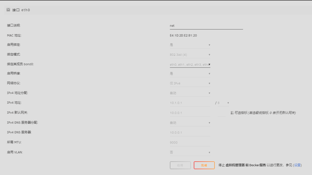

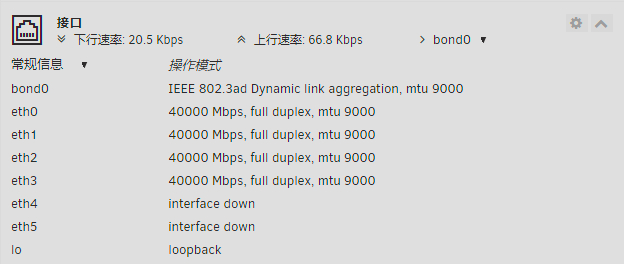

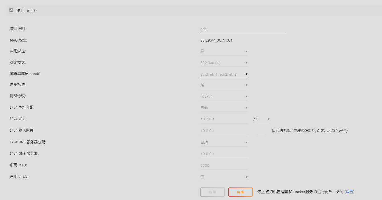

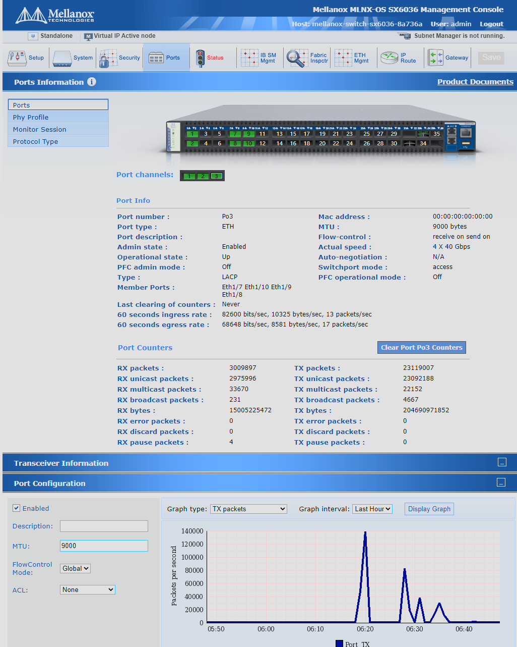

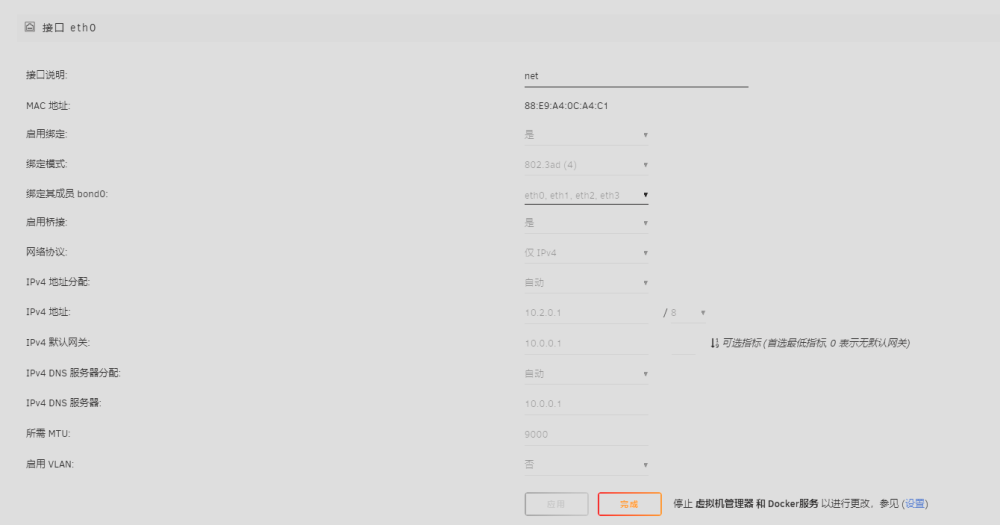

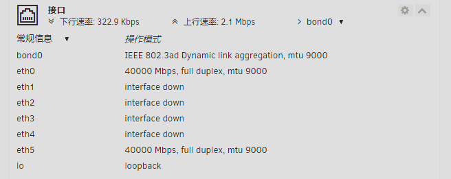

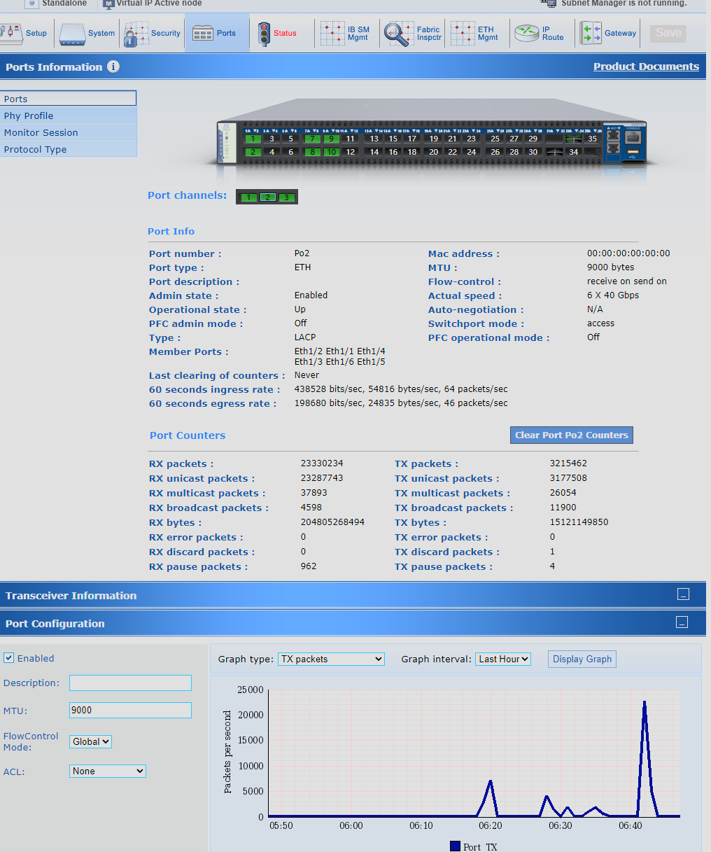

Hello everyone, I have recently established two servers using Unraid, one with 3 314A network cards and the other with 2 flr544+ network cards. I connected them all to Mellanox sx6036. As each network card has two 40G interfaces, I expected to achieve high speed through LACP. When I finished configuring it, I used the built-in iperf3 to measure the speed and found that all interfaces except eth0 had no load, so it could only run around 25G. I hope to get help. This is my configuration picture (the machine equipped with 314A currently only has two ports inserted)

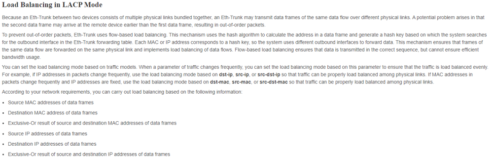

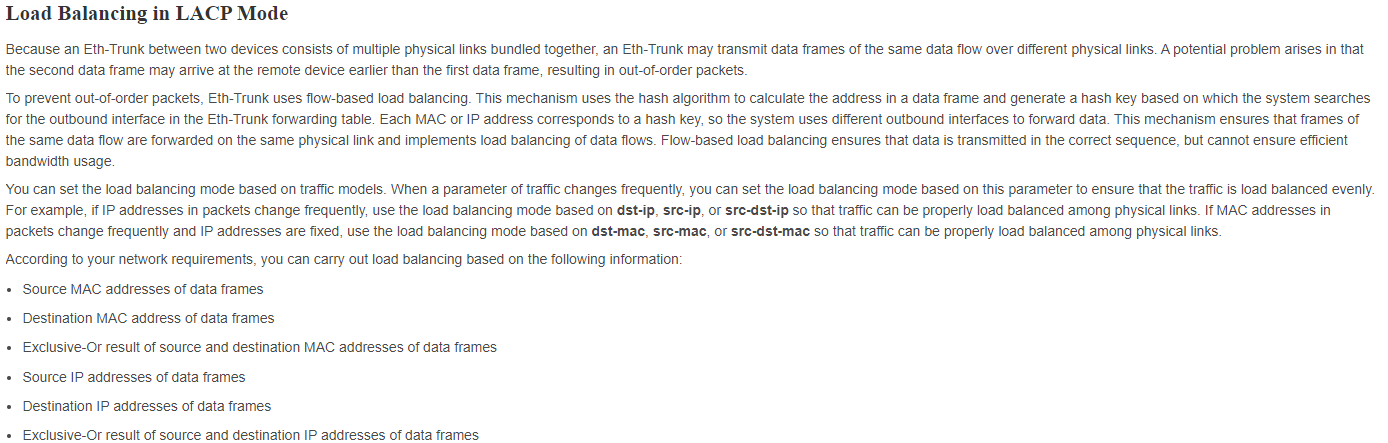

Iperf3 test in multiple session ?  if single session, then traffic will happen in one link only. ( Even multiple session, I am not sure does traffic will balance on different interface, because they are same source-destination mac address )
https://support.huawei.com/enterprise/en/doc/EDOC1100086560
https://www.jannet.hk/etherchannel-pagp-lacp-zh-hant/
Edited by Vr2Io

Yeah, keep that in mind, same for SMB transfers, a single transfer will only use one NIC, LACP only helps with multiple transfers.
