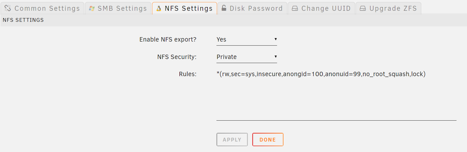

Set the "Enable NFS Export" to "Yes":
Thanks, that's exactly what I'm trying to do. When I do it, I click apply. The page refreshes, and the option is back to No.
