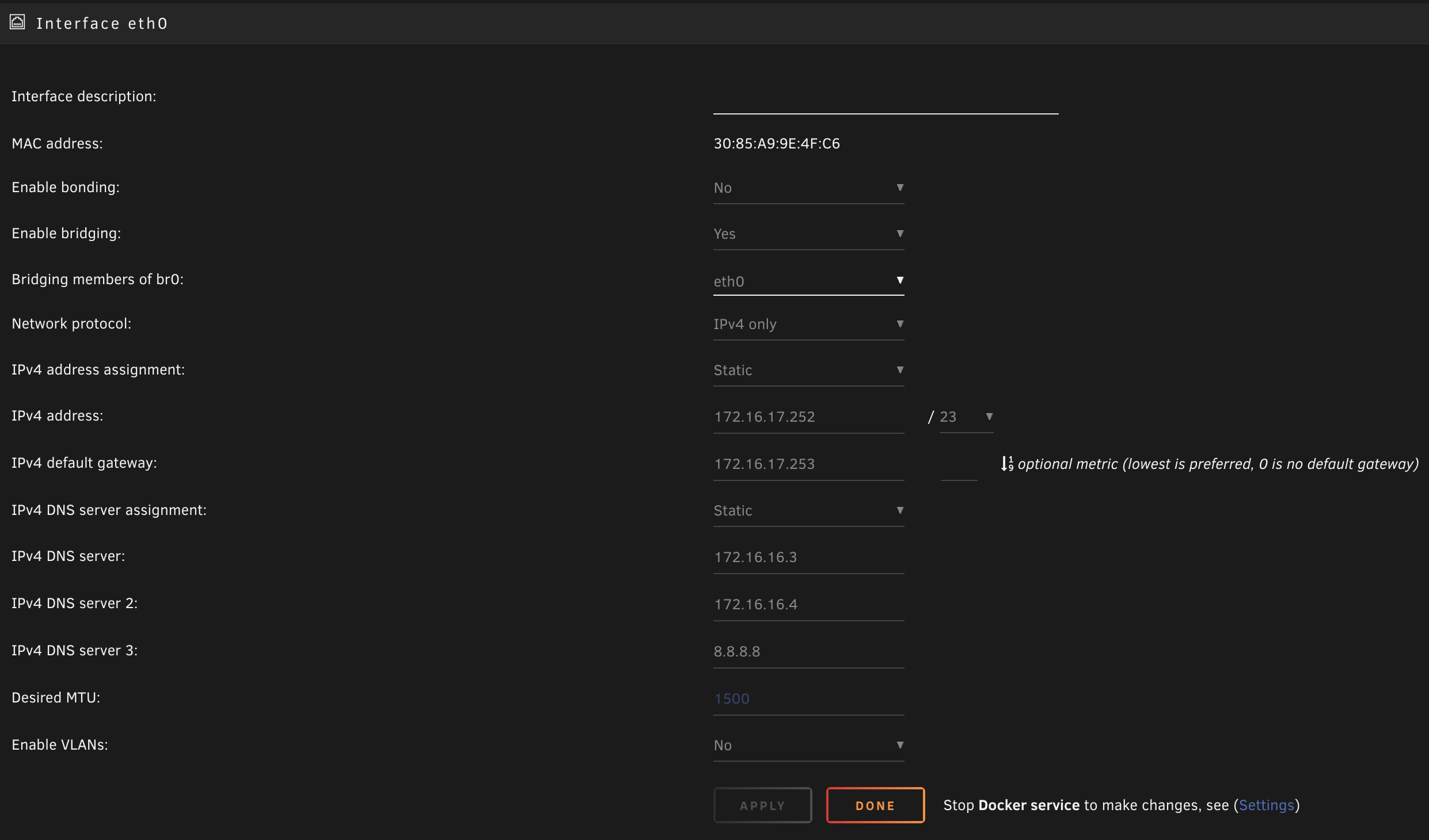

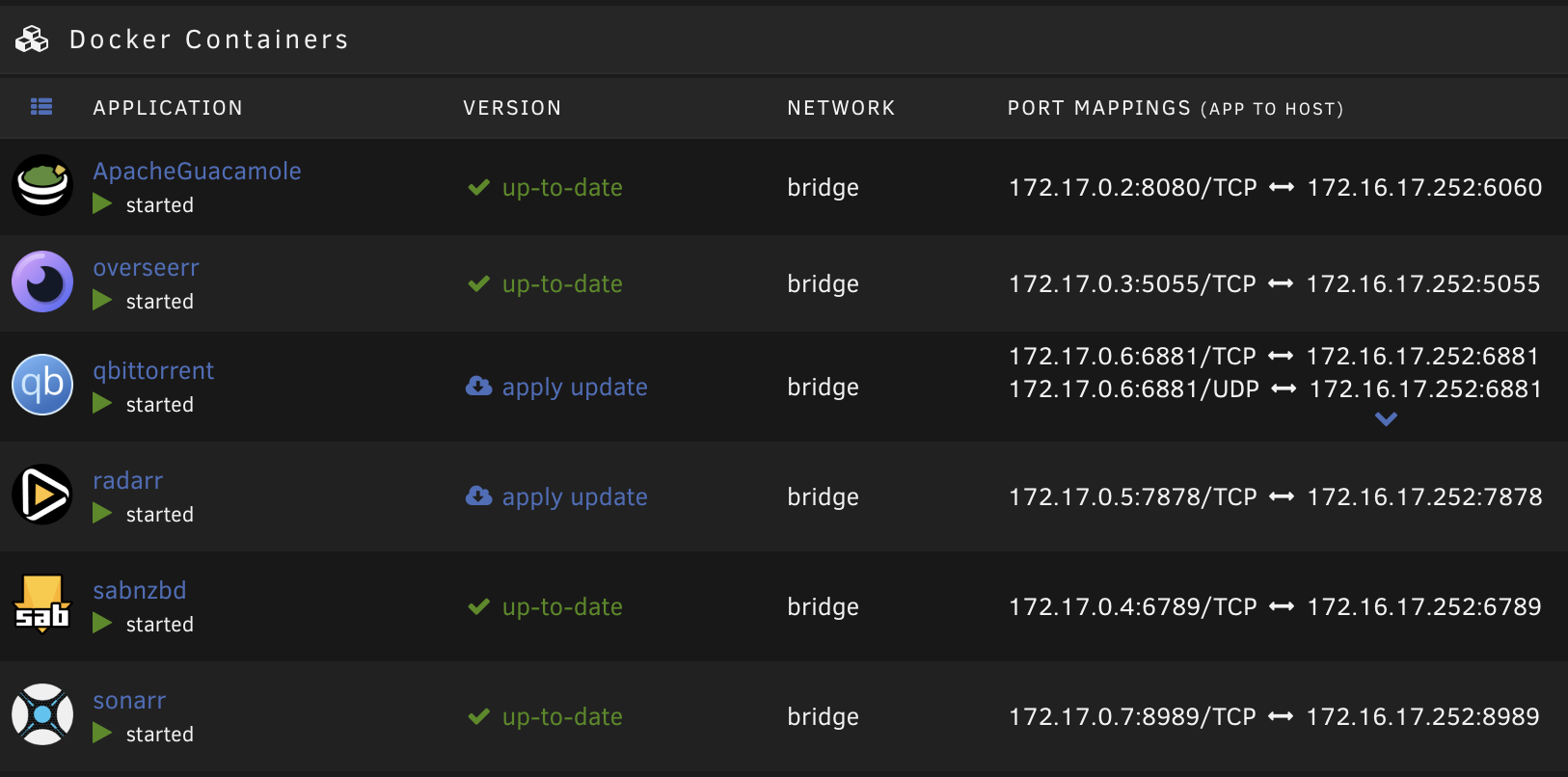

Question, I have two NICs on my unRAID server, configured as such:
eth0 - 172.16.17.252
eth1 - 172.16.17.251
I want to have all my docker traffic go over eth1 (.251) but all my remote shares via eth0 (.252).
I have created the bridge and I thought I had it configured correctly, but for some reason, the dockers all show .252 as the IP address.
Basically I thought this would be a fast way to separate the traffic so "acquisition" dockers (ahem, SAB, etc) would not run their traffic over the same NIC as the shares (where PLEX streams from).
So, I'm just wondering what I'm doing wrong.
Would it be easier to just change the FSTAB mounts in the media server?
I know that unRAID is using the management interface as .252
Any words of advice?

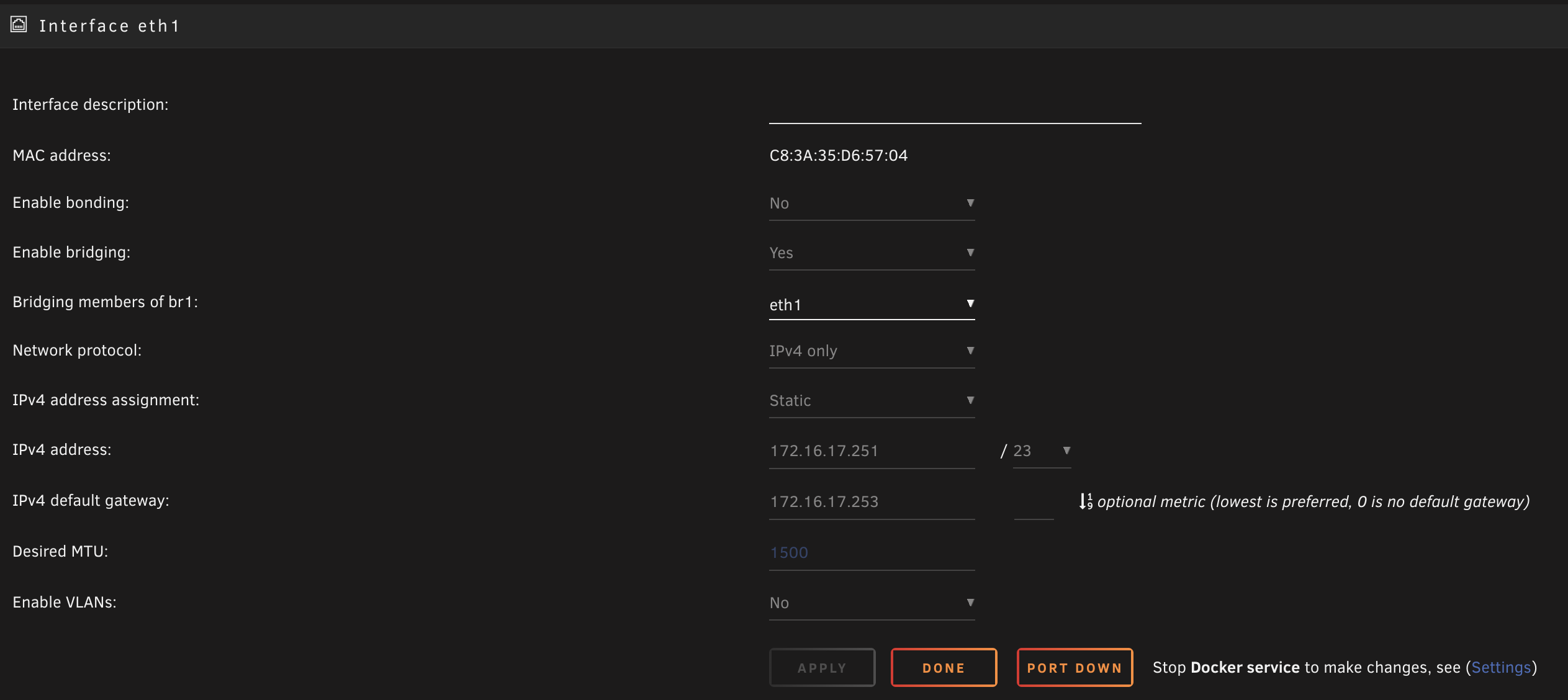

FYI per your network settings info br0 is attached to eth0 only.
at the top you would need both eth0 and eth1 in the same br0.
Unraid termianl
show ip link
would help seeing the bridged interfaces.

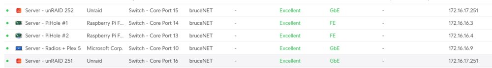

So I get this a lot in my Unifi logs:
Multiple devices are using the same IP address: 172.16.17.252
I notice that the two NICs in unRAID flap between one being .251 and both being .252
Any idea why it might be doing this? They are two, physical NICs, different MAC addresses.
Is this part of unRAID's fairly simplistic "click and done" network setup?
Sometimes they will show indepenenty, sometimes both as .251 or .262 and sometimes as the 172.17.0.X "bridge"
