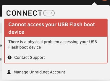

Hello. I have been using Unraid reliably until one of my array drives failed. I have replaced it today but after start of unraid and starting the array, I got a message that my USB is corrupted.
Files are readable on the USB, but when in unraid, I see nothing under /boot. So I have replaced USB drive temporarily, transferred license but I am still getting the same error. Basically when I reboot and array is stopped, all works, I can install license for new USB drive. However as soon as I start array, USB error pops up. With that, I cannot start docker (I assume it can't read proper config and if I configure it, point it to docker.img and apply, it is not saved). Similar goes for settings - VMs (it is blank after I start array).
I am gonna try different USB too, but I feel like this is not USB issue. Any ideas? I tried switching USB port on server, but made no difference. Posting diagnostics as well.
