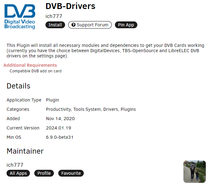

You may need to install a dvb driver to pass it. https://www.reddit.com/r/unRAID/comments/pmlta9/trying_to_pass_through_usb_tv_tuner_to_plex_docker/

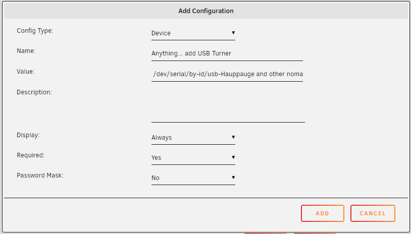

ls /dev/serial/by-id
and find the your tuner usb device via serail by-id. this is to gurantee a device grab...
example output: /dev/serial/by-id/usb-Hauppauge and other noman data at port#
we will then add it to plex by adding a /dev/ttyUSB0 device in the docker
add the device output:

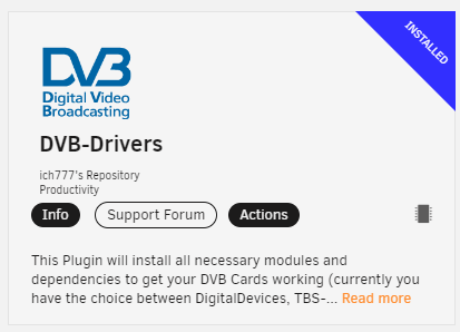

is the plugin installed?
do you see it in setting under the dvb driver section?

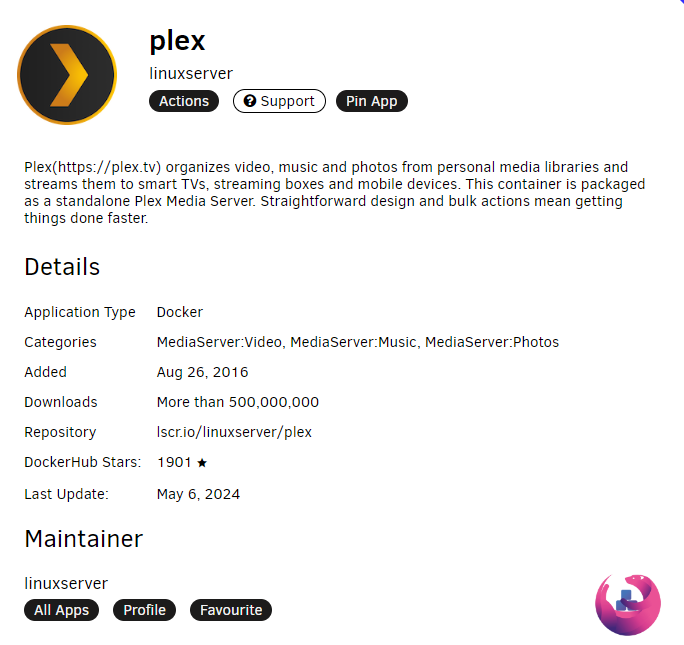

I would recommend you use linux.io docker image. I have a love hate relationship with binhex dockers. Binhex has done a lot and great things, but plex was not one of them in my experiences.
It may not be working as That docker iamge may not have the same dvb driver capabilities to use it with that docker image file....
with plex running console in you should be able to also use ls /dev/dbv and see the adapter 1 and 2 ...
You will need to stop and remove that docker and install a different plex docker... This means you will need to recreate your Plex server. :(
I would recommend you switch to this docker for plex:
I also recommend you use a different network / static ip

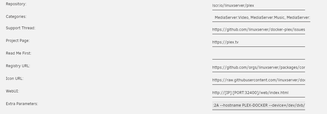

this docker and template has items in the extra place: image.png.929702ffcbd5353750041a9a80552c82.png
add the --devices /dev/dbv to the end of that text...
I have found Linux io to be more encompassing of docker and updates faster than binhex to maintain a fully up-to-date and supported plex system.

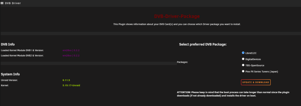

ALSO make sure you have downloaded the dbv drive by hitting update and download and have rebooted the unraid system...
I would like to see a screenshot of the dbv info...
I'm not sure if you have the DBV driver installed or not yet...
Edited by bmartino1
So heres a screenshot with dbv drivers

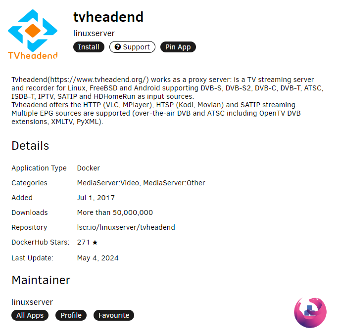

couldn't get it to work with tvheadend so I'm looking for a way to add the usb tv tuner to plex .

Yes i already tested  tvheadend with succes on unraid .

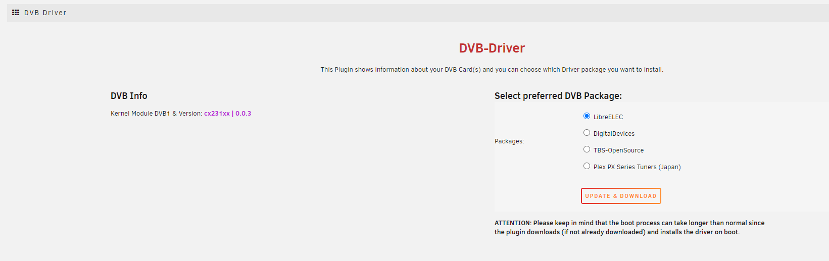

I installed the app dvb driver:
Then pluged in the usb device.
Settings> using libelec > update and download:
then reboted the PC
AFTER REBOOT!
I got a DVB info of unraid seeing the device.

Edit docker
--device=/dev/dvb/
I'm using linux IO Docker image... Per post and Unraid they recommend using the Plex official docker image.

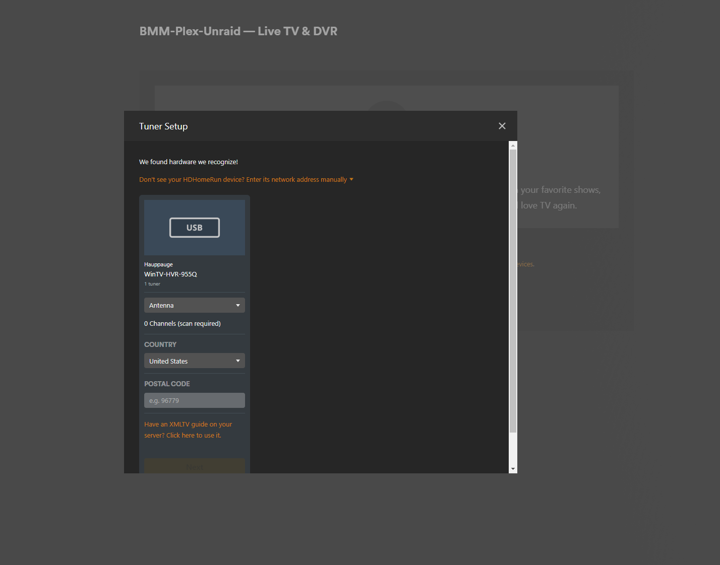

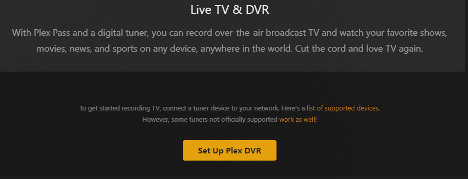

I then open plex after the edit and click setup dvr to add live tv tuner:
as you can see here:
I then set the zip and scan channels:
Thats it.
