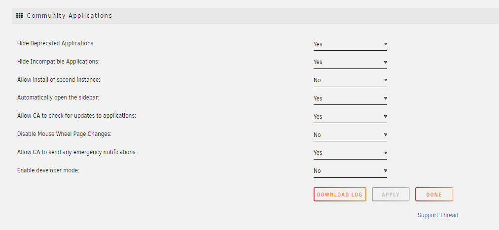

Plugin settings is accessible via link and  seems functional
