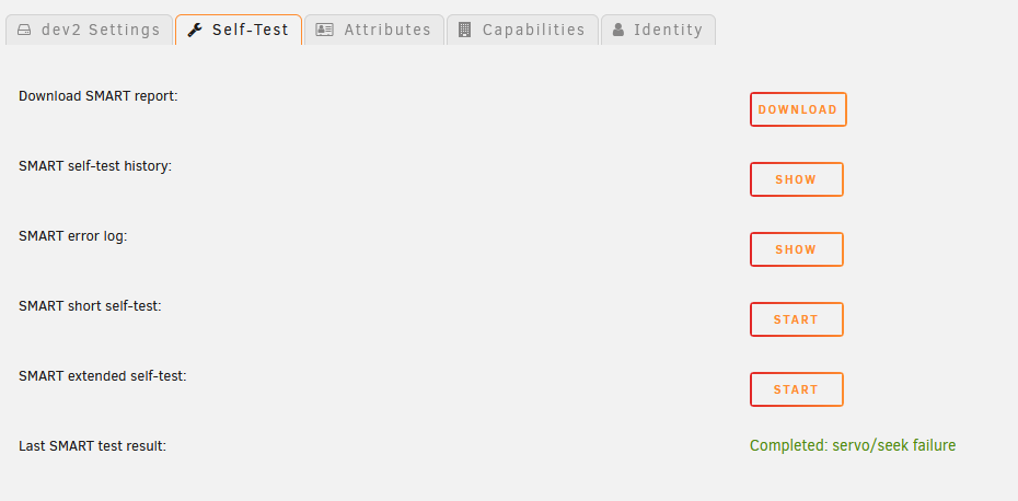

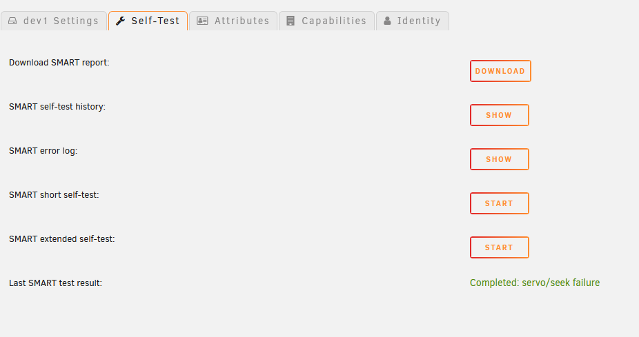

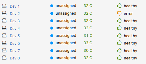

edit: speaking of which, looks like some of the drives are having issues but I don't understand what I'm seeing. On the dashboard Dev1 shows healthy and Dev2 shows error, but both have "Completed: servo/seek failure" under their smart report.
I can't imagine that "servo/seek failure" is possible on a healthy drive.
It's never a good sign.
