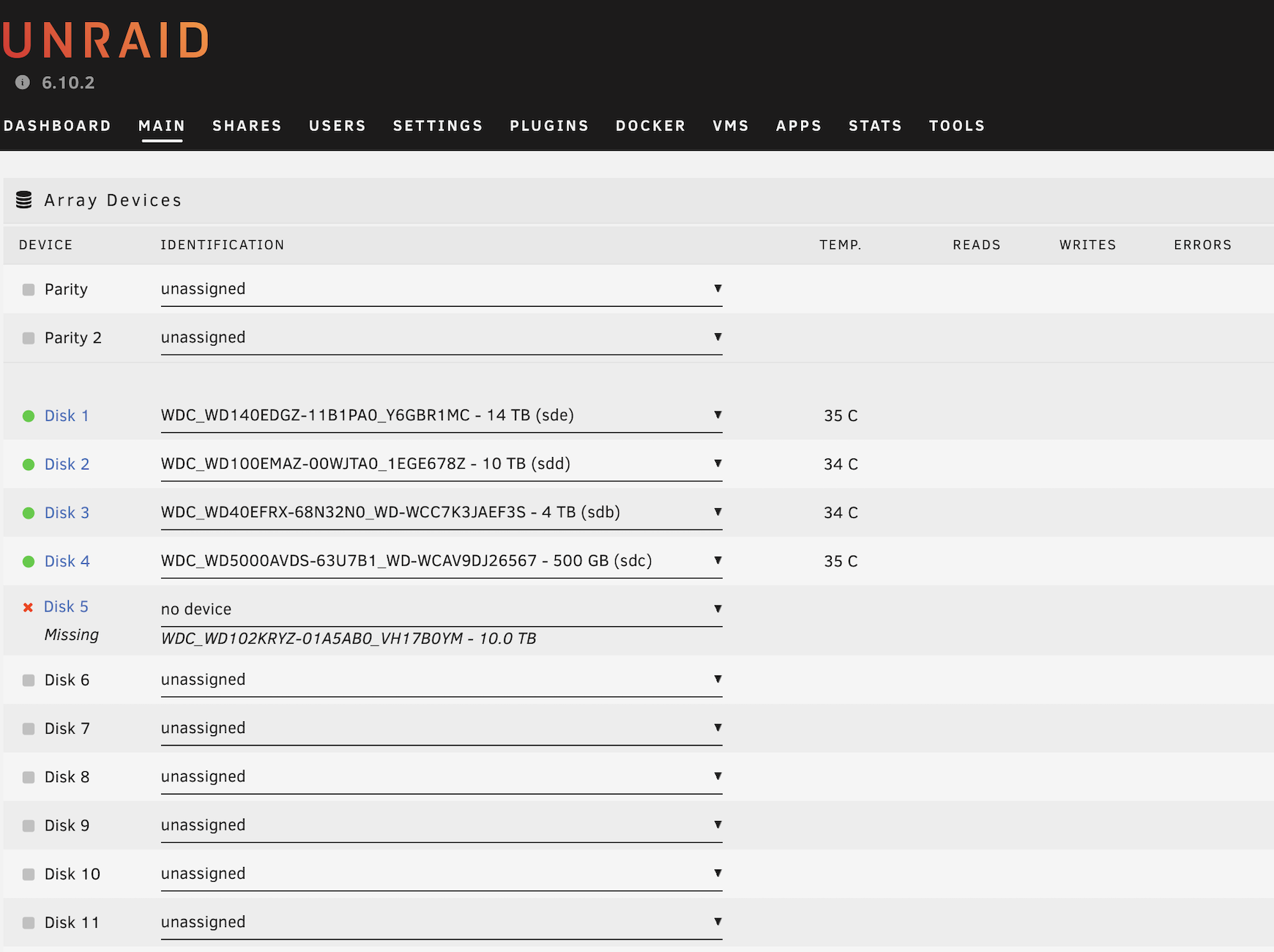

May 15, 20242 yr Hey everyone, My misfortune started a week ago when I piurchased a new drive for unraid. I used a no name pci sata card to add it, and initially I was able to add it to the array. Shortly after, i noticed that it was throwing errors. I never assigned any shares to it, as I was waiting to make sure the drive worked before starting to load data onto it. People suggested I get an LCI card instead, as those pci sata cards don't work well. So since I was going to remove the drive while I waited for the LCI card to show up, I stopped the array, and removed the drive from the array, and then proceeded to clear it (on the same page of unraid). I then realized that I can't start my array again with the other drives, as it's saying that disk is missing and array cant start because of it. So now I'm stuck and don't know what to do, as I would like to not lose any data on the other drives that are untouched. What should I do? Thanks for your help 🫠

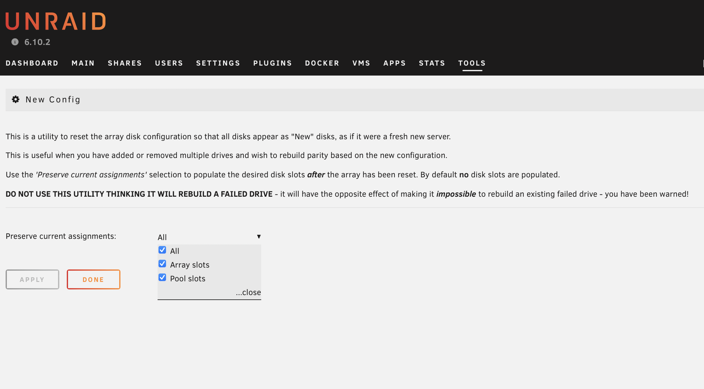

May 15, 20242 yr Author Ok, so if I'm reading this correct, I just need to do a New Config in Tools, and preserve all settings (array & pool slots), this should put me back where I was pre stopping the array?
May 15, 20242 yr Solution Check Preserve Pool Slots. The array slots you need to assign manually (don't check) Basically use your image and assign all but disk 5 so it is left unassigned.
May 15, 20242 yr Author Aha ok I think I understand. And I shouldn't lose any data right? Since it's a disk that wasn't being used anyways?
May 15, 20242 yr Data will stay there on disks 1-4. Disk 5 is is just being removed so that unraid is not looking for it anymore.
