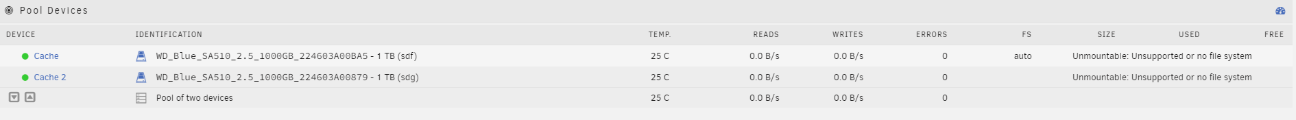

Hello, I have been searching for a solution for my problem for quite some time. My cache pool of two devices will not mount after reboot.
The error listed is " Unmountable: Unsupported or no file system".
I have tried to run "mount -o rescue=all,ro /dev/sdg1 /temp" with the error given as: "mount: /temp: special device /dev/sdg1 does not exist"
If anyone would be able to help me figure out what may be the issue I would appreciate it.
