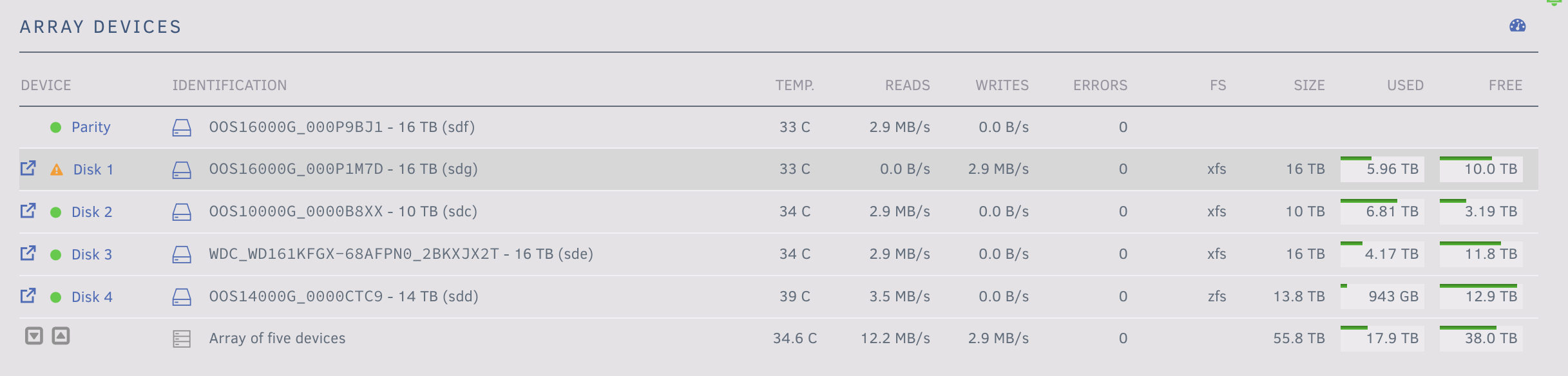

THanks much - I tried exploring that, but the file activity pluggin wasn't showing any disk activity. Also, when I look at the read / write speed per disk it looks like the parity writes are equivalent to the reads on all of the other disks except for disk 4 which is showing a slightly higher read speed.

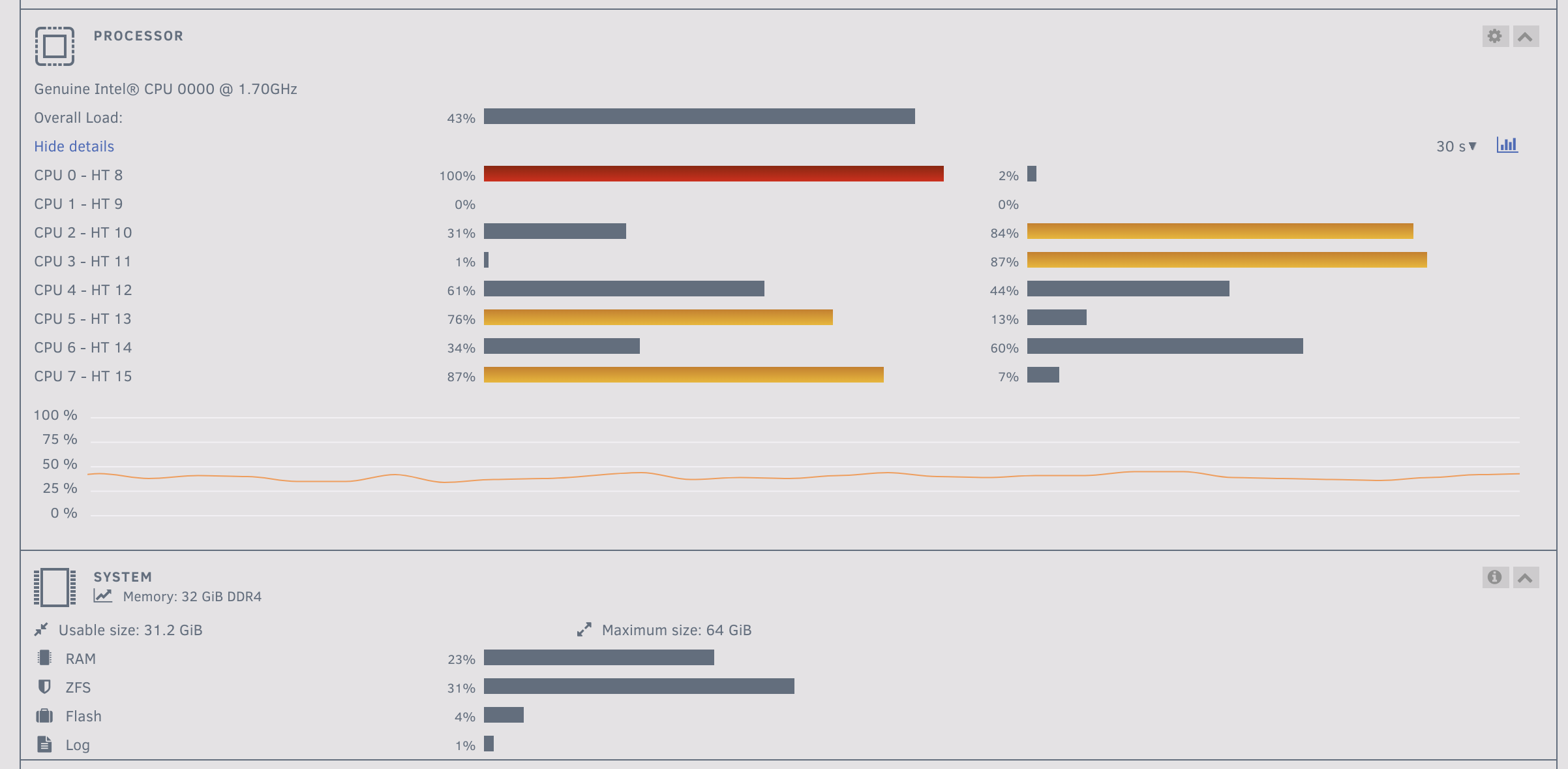

One other item of note the CPU load on the system seems quite high given the fact that I don't have docker or vm services on - anything I should look at there that may be related to the slow rebuild speed?
31 minutes ago, citizen_y said:
Do you think its prudent to run the diskspeed test again while still running the parity rebuild?
You can run it again if you pause the rebuild.
I agree, and SHFS is using CPU suggesting there's something assessing the shares, or it got stuck, you can also try rebooting.
