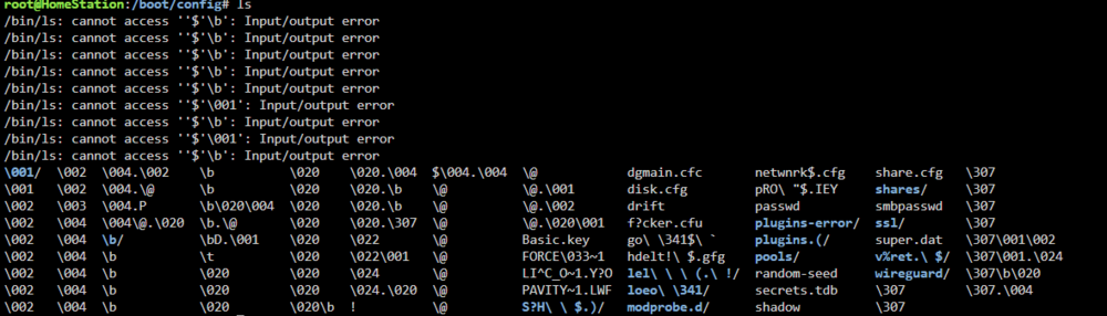

today unraid started to show me the message, that my flash drive is corrupted or offline. Since its only 3? month old i am a little confused.
What would be the best steps to get it to work again? I thought about restarting but am afraid, if my server wont come back up again.
Also my boot/config/ folder looks a little weired. (See screenshot)
Any suggestions or tips, how to handle this?

May 17 14:01:36 HomeStation kernel: FAT-fs (sdb1): error, fat_get_cluster: invalid start cluster (i_pos 0, start 80010000)
May 17 14:01:36 HomeStation kernel: FAT-fs (sdb1): Filesystem has been set read-only
Flash filesystem went read-only, you can try running chkdsk on it, or reformatting, if issues persist replace it.
