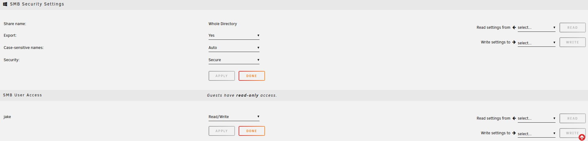

I'm having issues deleting files on one of my secure shares. I'm trying this on windows in an SMB share. I've tried through windows explorer and via a sync software. I need it this way because I'm using synconisation from other locations to mirror some folders, to remove junk off of my unraid server. It's secure share, correct user, deleting works fine on a public share.

A little further digging has returned that trying to delete something asks for permission off of "nobody" which I gather is the default user of Unraid. This share isn't touched by an dockers or anything, it just a drag and drop file backup location off of my PC. It is possible that I have used Krusader in the share but I can only presume I was carefull, only moving within one share etc.
I have ran "chown" and "chmod -R 755", it's all listed as "jake", my user. In windows credentials manager it lists the user as "jake" all lowercase just like on the server.

How do you know you are connected to Unraid with the correct user?
After Windows has established a connection with one user it won't use another even though it might ask you to login again.
Delete the Unraid credentials in Windows Credential Manager and establish the login again.

I deleted the credentials, same result. It doesn't even ask for credentials when I re-map the drive. I removed all mapped drives form the server, have restarted PC, same issue. It's deffo a secure share. I've checked the credentials manager after this, there's nothing there for my server. :S
EDIT: SOLVED! I manually added my credentials, rebooted my machine and it works all honkey-dorey! MAssive thank you!
