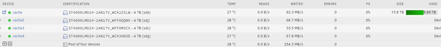

I really like 2.5" drives because they are low power and you can fit a lot of them in a server, example since I'm currently replicating an fs to a 4 SMR drive zfs pool:

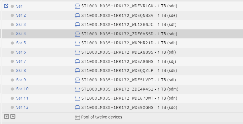

This pool also performs well for SMR:

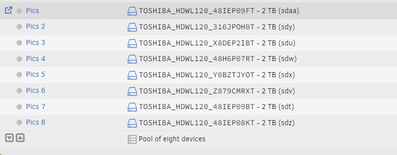

This one not so much, used for WORM data:
