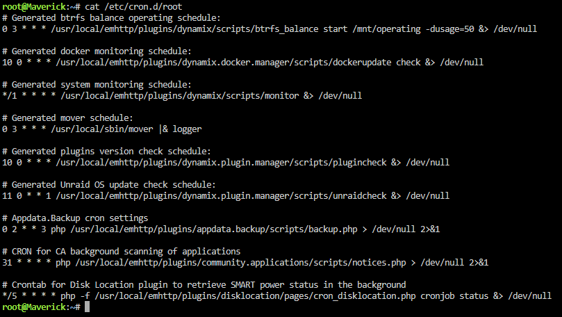

Going through the terminal processes I was able to confirm the spike is coming from command:
usr/sbin/crond
The triggering command aligns perfectly with the reads happening on the array
We don't really know what is happening there. Are you able to shed any light?
Further updates, but no solution as we need higher level assistance.
We tracked the cron.d that was operating to the dynamix system monitoring that seems to now be embedded in Unraid. There is no way to block the command to test if it is the main issue and as soon as `update_cron` is run then the settings revert. Others dont seem to have the same issue despite this apparently being a new 'setting'.
Not sure how to address this bug until we have a response from someone who understands whats happening.

The dynamix system monitoring has always been there.   It is likely some other job being started by cron that is causing you an issue.
It was the first we went to as it was the only one running every 60 seconds, but all the others that were there seemed normal as well.
There were only 6 jobs running in safe mode, 9 total.
Which of these do you believe could be the one causing an issue?
