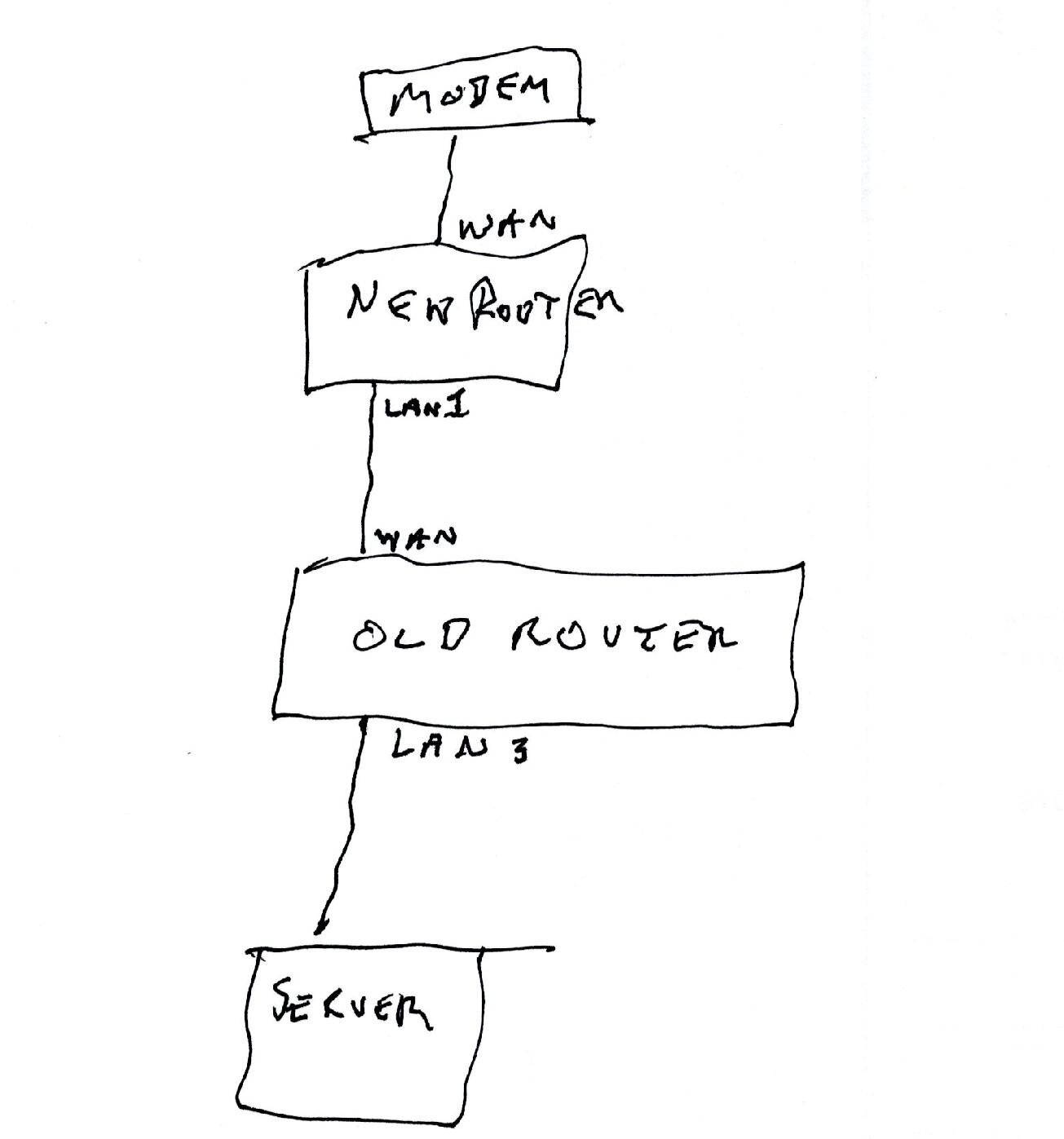

NO!!!  I meant an actual sketch.  I will attach an example.
BTW, two routers (on a home network) is bad news most of the time unless you are a Network expert.  You would probably be better off if you would remove one of them.
EDIT:  In my sketch, that setup will be one example of how not to do it unless you know how to configure both routers using the 'ADVANCE' setup procedures on both routers.

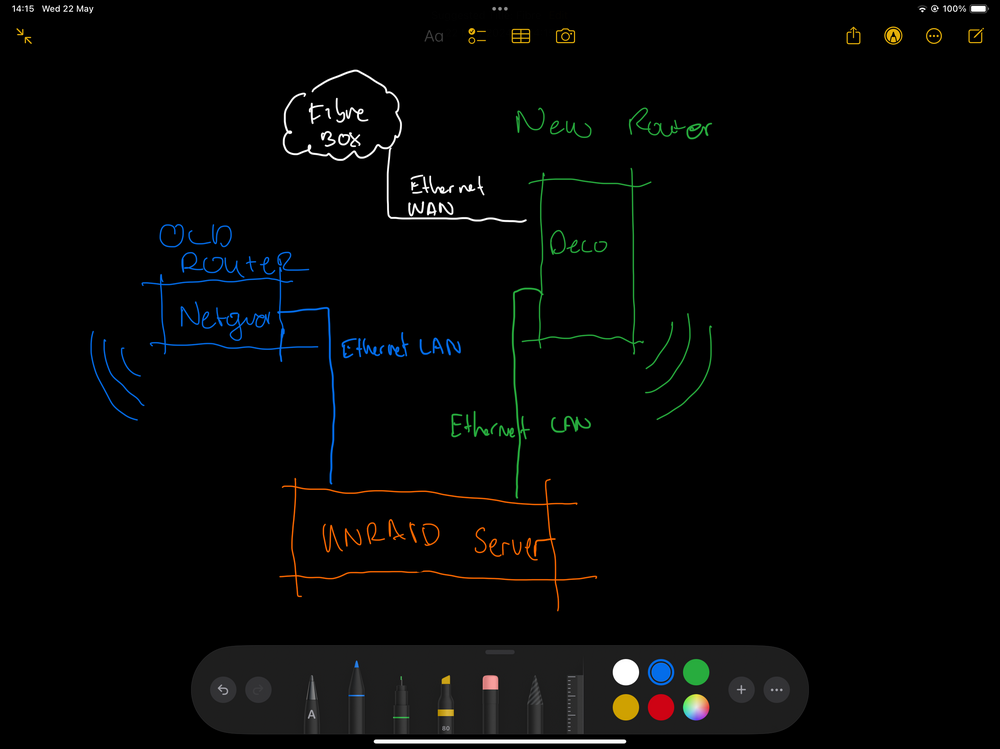

I'm only on the old one because the server doesn't pop up when I connect it to the new one and I needed to access it to get diagnostics. Excuse my crappy sketch
2 hours ago, Kardiogramm said:
it's still connected to the old router (how I managed to find the address and log in) and it's connected (physically but not recognised by it) to the new one too.
You can only have it connected to one router (DHCP server)
