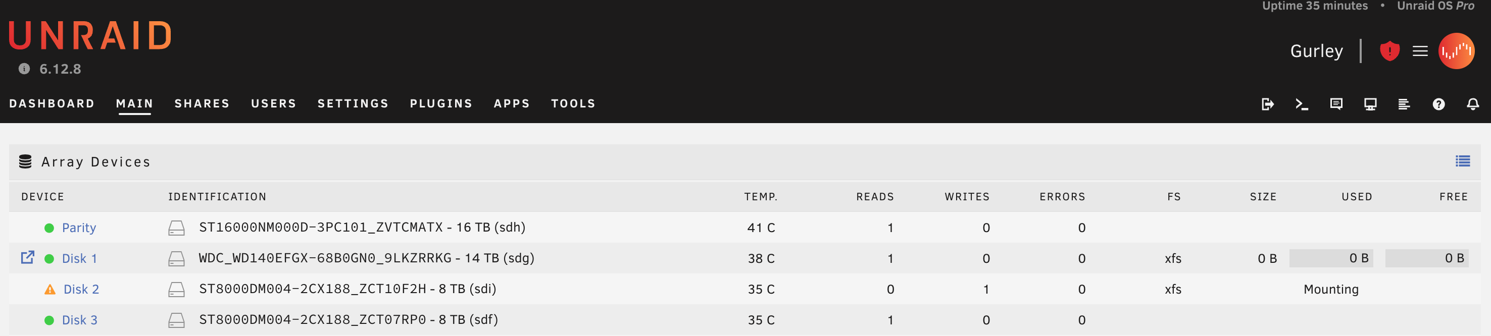

I finally got my Parity disk upgraded (copied from old Parity) and Disk 1 (old Parity) rebuilt.  Then I see that Disk 2 is unmountable with a red X, CRC errors are appearing.  I shut down my machine and reseat the cables, but the drive still won't mount after reboot.  It is now getting stuck as Mounting and just sits there, unRAID will not respond to a restart or shutdown command.
After rebooting the machine I:
  • removed the device from the array, clearing and formatting the drive, add drive back to array, start array - same result as above
  • Currently running xfs_repair -L through the GUI to see if it can be fixed, it seems to be taking much longer than any previous xfs_repair that I have performed
Do I just have another bad drive? Or is something bigger at play here?
If it doesn't fix it post the output from that.

I had to be patient. It took about 20 minutes for it to complete. Afterwards I was able to mount it properly.
