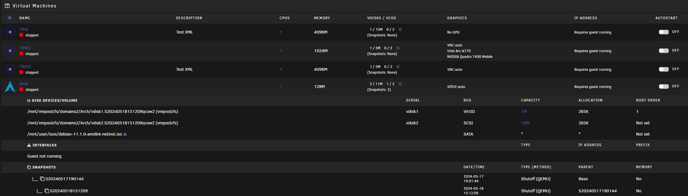

3 hours ago, SimonF said:
Can you provide some info on your use case? are the appliances etc?
These are data sensitive systems and I don't want VNC to be exposed on them. I access them using SSH + TOTP (MFA). I want to add a layer of security by not exposing VNC.
So you are looking for an option like this.
<domain type='kvm'>
  <name>!Test</name>
  <uuid>95141a59-95b2-b065-23a2-394ac9d395d7</uuid>
  <description>Test XML</description>

Spot on!
I marked this thread as Answered. How do I know if this patch will be included in the next release?
19 hours ago, SimonF said:
PR has been merged and will be in next release.
LEGENDS!
