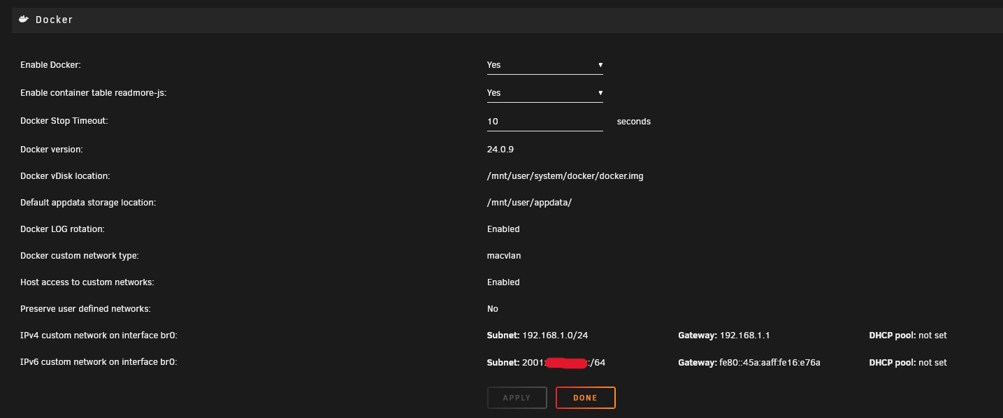

Your using ipvlan docker setup you would need to use a macvlan setup. This is due to each docker in ipvan using the same mac address...
Turn off bridging. Under docker setting set: custom host access enabled.
Edited by bmartino1
Hi bmartino1,
thanks for the reply i have tried the settings:
Unfortunately, it had no effect on the problem. Even after setting it up and waiting a few minutes, neither the Unraid system nor the Docker could ping any of my devices, nor could I add them to the Matter server.

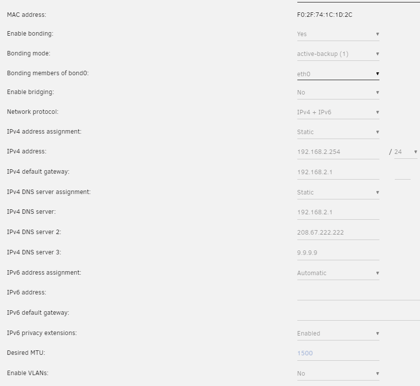

did you turn unriad network seting bridgin off?
It its is on even with docker setting it will use ipvaln.
You issues is more network related...

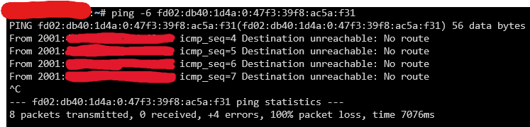

The problem is that Unraid itself cannot access the ipv6 devices in the thread network (ping) and therefore the docker cannot either. However, the VM on the Unraid can access the devices, just like all other devices I have on the network, such as PC or iPhone.

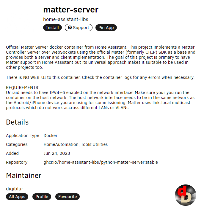

Did you follow the instrution on the docker template?
step 1 unraid needs ipv6 and ipv4 enabled.
step 2 the docker network for the matter server need to be set to host. per requirments as that is how the image was built to run.
step 3 confirm you can ping the HA docker within the container
While ipv6 can be used ipv4 is the ip to conect talk and do things on. ipv6 comes after ipv4 comunication is established at unraids level.
Then things tunel off ipv4 and use ipv6 in this instance..

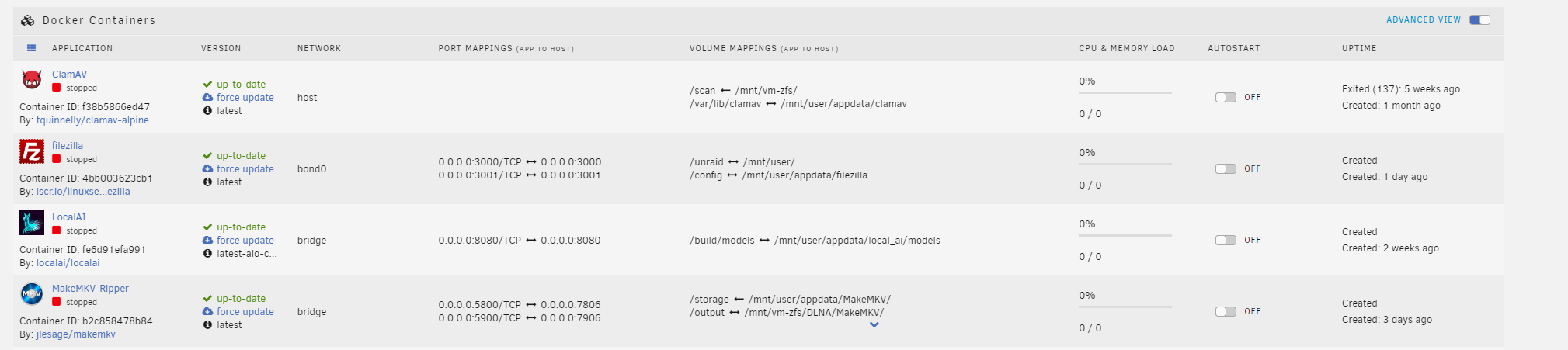

i need a advance screen shot of you docker page.
EX:
as you can see I have multiple docker in the example, I need the once for your HA docker and Matter Server Docker.
As the Matter Server Docker networking MUST BE HOST!!!!
you need to complete ipv4 unraid connections first before using ipv6 connections.
This will make the matter Server at unraids IP for ipv4 and ipv6 and is the dockers requirements to run and use...

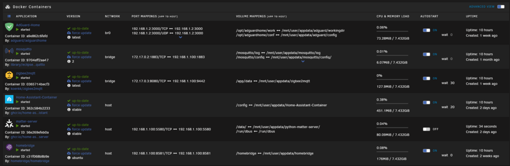

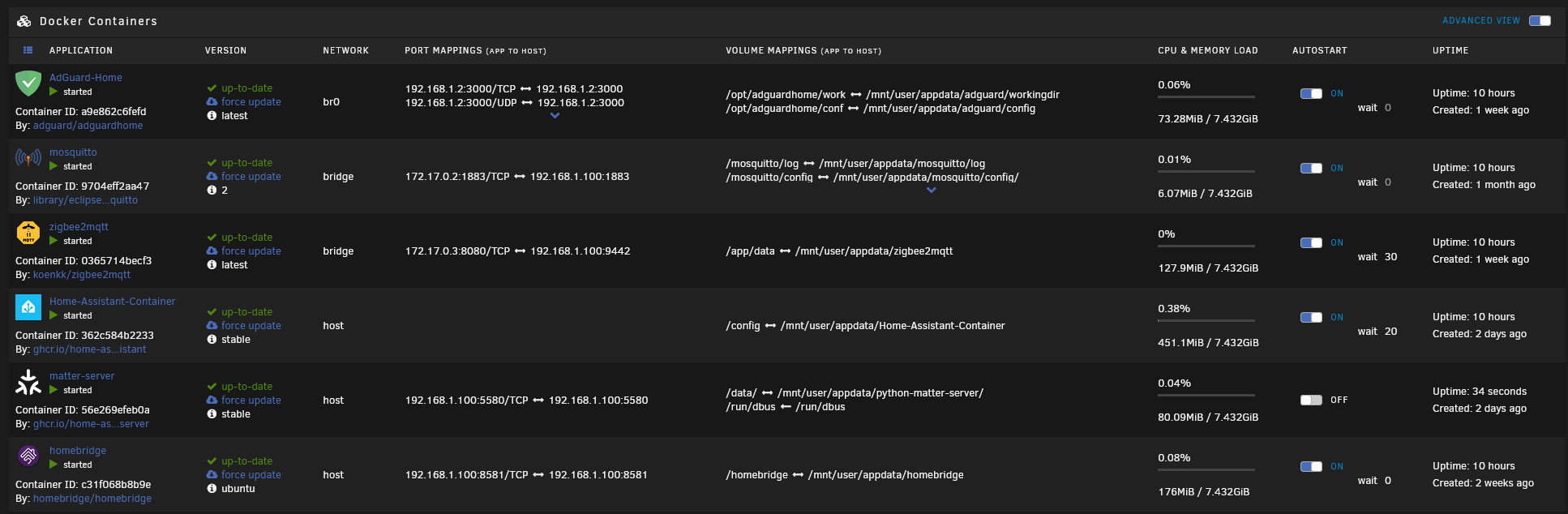

Gladly here is my docker list:
ok. Is your unriad ip at 192.168.1.100 ?
also your Home assistant should be using a custom br0/bond0/eth0 not host. and should be set to a lan static Ip address.
Yes 192.168.1.100 is the unraid system. The HA docker is set to host is just not shown in the UI for the docker, no idea why that is, but it is the same for other setups I have seen.

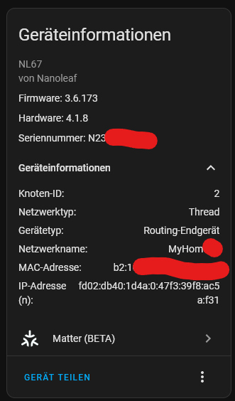

To clarify, the problem is that the Matter server cannot communicate with the devices (lamps and sensors) in the ipv6 network behind the boarder router. HA has nothing to do with this problem. The interaction between HA and matter Server also runs without any problems.
The aim is for the matter server to be able to "see" the devices.

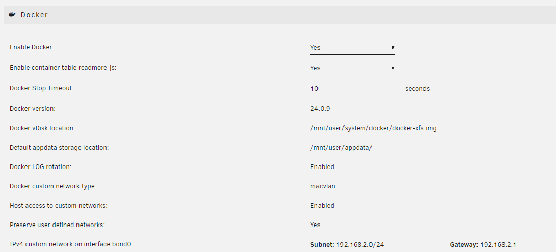

I'm not having the same issues you are with HA and the matter server. I have run both the dockers and VM and passed a zigby usb device with both...
I run a macvlan unraid docker setup.
Bridging off, bonding on, docker settings macvlan and host custom access enabled...
^- you may need to use or change some docker settings...
Edited by bmartino1
I think you are using a ipvlan docker network and the matter server is alos in need of its own custum mac address. which is why it works with the vm as the mac address are different.
with a mac vlan setup you can define a mac address as well.
--mac-address 02:42:C0:A8:01:00
