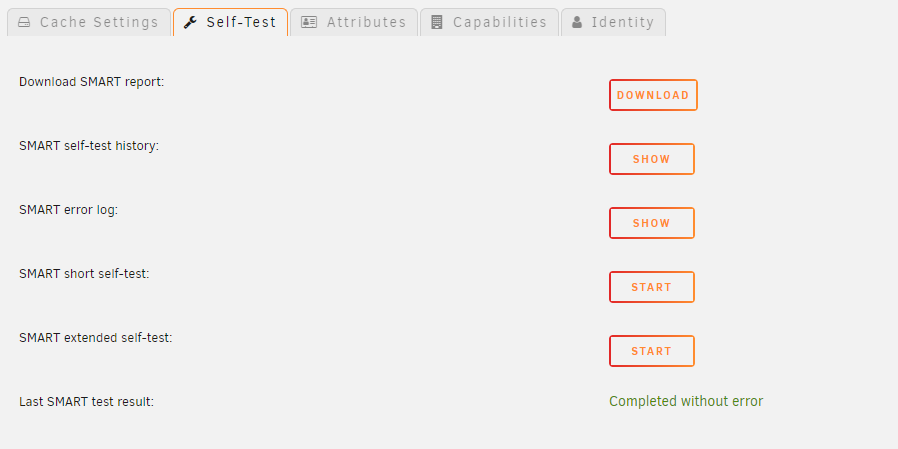

click the drive go to self test and click short test:
the database is empty as their is nothing on the disk to read or a test that would show any data?...
The drive is there, and curiously enough is showing SMART info. The short test also passed. This is a new drive so it's currently running pre-clear. Could that be what's messing it up?

Look at your disk reads and writes. they are constantly going up due to proxmox host checks and claims to the disk. This also cause extra strain on the disk and hurts performance. As unraid is also trying to spin down the disk...
There are tool you can run at the host and vm level to check.
What tools are you referring to?
PM...
