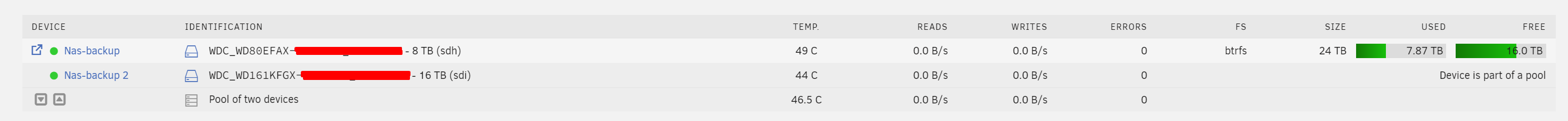

Hi @JorgeB thanks a lot for the help.
I think i have managed to do it, this looks good but i didn't actually do anything to convert it to a single profile. However the 16TB free space and about 8TB used seems like it is acting as a single profile, no? Is there anything i should check about this to make sure it is all okay? My existing backup data still seems to be there (The 8TB)

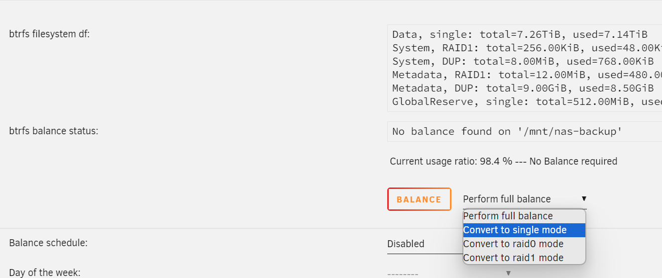

I can see in the diagnostics for the nas-backup pool it says diskFsProfile = "raid1", is this supposed to say "single"?
If i do "convert to single mode" and press "balance" nothing changes in the diagnostics when i download them again.

Profile is OK, metadata and system are raid1, but the data profile is single, that's what you want for this case.
Alright thanks a lot, that makes sense now with what i see in the screenshot as well.

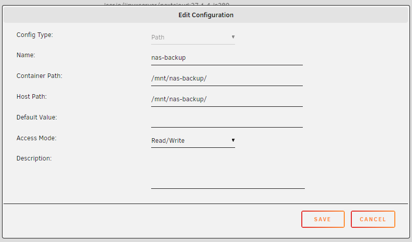

Only i'm now having problems where my Nextcloud container can't write to my /mnt/nas-backup/ folder. I mounted it in my Nextcloud like this:
It has read access but no write access it seems like. Here is the command ls -la from my unRaid system in case that helps:

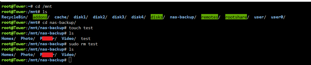

Actually now that i did some more tests it doesn't seem to be Nextcloud related at all. When opening a terminal straight from my unRaid UI i also cannot write to the pool.
Anything i can try to check to see why this would be the case?

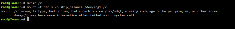

Sorry, missed your last post, something/someone started a balance to raid1, with the array stopped, try this:
mkdir /x
mount -t btrfs -o skip_balance /dev/sdg1 /x
btrfs balance cancel /x
umount /x
Then start the array and post new diags.
Hi @JorgeB, no problem.
The second command gives an error:
This is above my Linux knowledge so all i can really do is post this error and hope you know what to do, i think. The only thing i noticed is that /dev/sdg1 is a 4TB disk in my array, is that correct? Is this supposed to be one of the pool disks?

It is, I forgot to mention it can change with a reboot, use sdh, so:
mount -t btrfs -o skip_balance /dev/sdh1 /x
I accidentally closed the terminal window after executing the commands so unfortunately i can't copy paste the output :/ But when doing that one i got a warning about metadata and system being RAID1.
