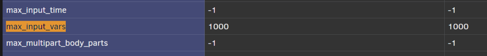

Tools -> PHP Settings -> PHP Info confirms that max_input_vars is at 1000
Edit /etc/php.ini and add a new line at the end:
max_input_vars = 1500
And then reload PHP:
/etc/rc.d/rc.php-fpm reload
Refresh Tools -> PHP Settings -> PHP Info to confirm max_input_vars has a new value, then try submitting the form. If PHP log still complains, try a higher number.
