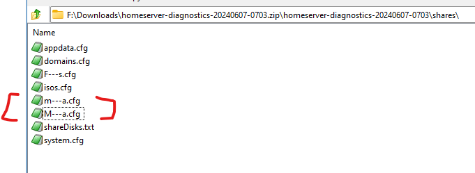

Just looked at your diagnostics.  (They are generally fairly useless in troubleshooting SMB issues!)  Look at your SHARES tab in the GUI*, are there two shares---  one named media  and the other   Media ?  If so, that is a problem for Windows.  While Linux is case-sensitive, Windows is not.  Therefore windows will only 'know' about one of these two items and it will ignore the other.  (The first one it finds is the one it will use...)
*  The reason for this question is this in the diagnostics file:

I think the duplicate 'media' share is the issue. If I change the SMB setting for 'Media' then it updates the settings for 'media' as well. But I do not remember creating this share, so I wonder how it was created.
media shows no files in the web UI where Media is the actual storage location. Windows seems to be showing media, which is why it's empty. But when I try to map the server as a network drive via server name/ ip address I still get the 'windows cannot access....' error.
I'll create a new share, moves the data from Media to the new share, and delete Media and media and see if this persists.

If you had top level folders on the drives named 'media' and a 'Media' share then this would cause problems.   Windows (and therefore Samba) is case insensitive whereas Linux is not.    You would not know which of those two folders would be selected by Samba as the one to share over the network as SMB shares are case insensitive.   If you now have a redundant folder (with different capitalization) then make sure you delete the redundant one.

This can happen in a Docker containr has 'media' rather than 'Media' in a variable parameter.  (It could probably also happen in the same situation in a VM..)
This is an issue that can happen with Samba/SMB transactions.  Since Linux is case sensitive, 'media' and 'Media' are two separate directories.  With Windows (which is not case sensitive), that situation can not exist!  (If you try to create a file/directory in Windows with only a case difference, Windows will response with a message of 'that file already exists'!)  So there is no need to address it.  It is a Samba/SMB problem that has never been completely addressed and probably has no satisfactory solution.
