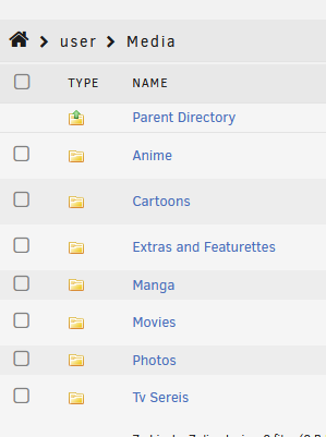

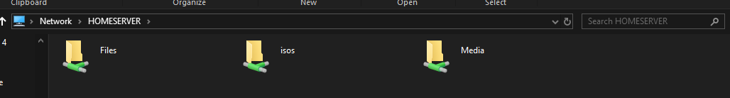

  6. Update: created new share 'New Media' - export = yes - security = public Moved data from 'Media' to 'New Media' Can see 'New Media' in Homeserver via 'network' and it shows all files set export = no for 'Media' deleted the 'Media' share So I can now access the server and shares via windows explorer, which is great. My concern now is will this possibly be an issue at a later date? since the security is 'public' that means any PC on the network can access the share, yes? I haven't mapped the server as a network drive, as I can see it in 'network', so I'm assuming I don't really need to. Changing this to private, I just need to make sure the credentials used to log into the PC are the same as the Unraid user I am accessing the shares under? That's what I understand at least, and so long as credential manager has the correct credentials saved I shouldn't have an issue.
  7. I just updated my unraid user password to match the one used to login to my windows machine and still no dice. I made sure to clear the credentials in credential manager and chose to sign in with other account details, still unable to connect. I think the duplicate 'media' share is the issue. If I change the SMB setting for 'Media' then it updates the settings for 'media' as well. But I do not remember creating this share, so I wonder how it was created. media shows no files in the web UI where Media is the actual storage location. Windows seems to be showing media, which is why it's empty. But when I try to map the server as a network drive via server name/ ip address I still get the 'windows cannot access....' error. I'll create a new share, moves the data from Media to the new share, and delete Media and media and see if this persists.

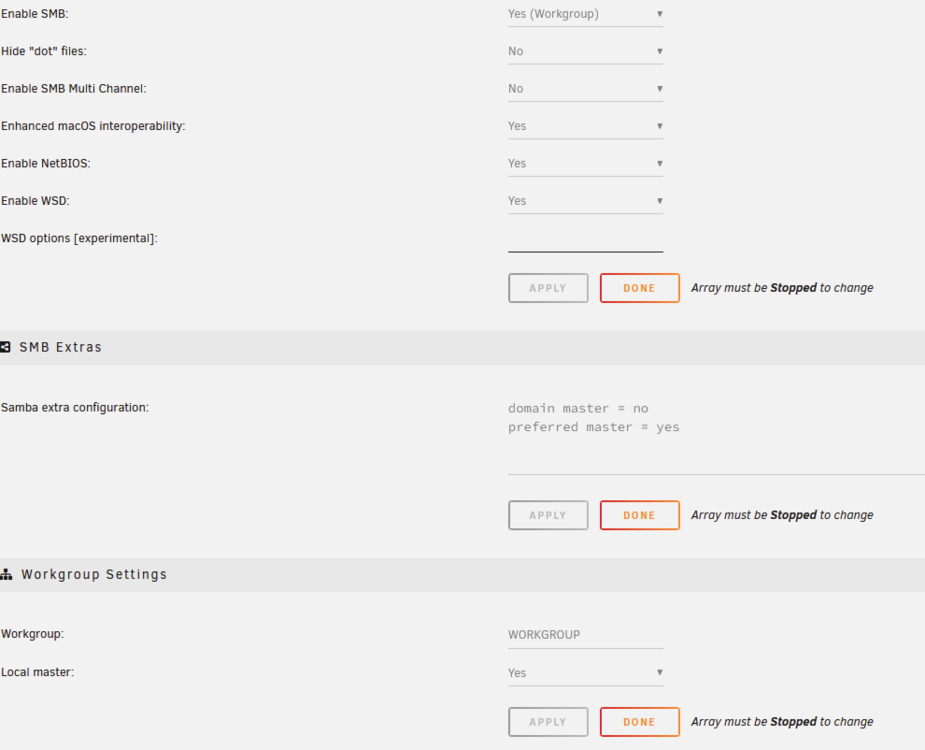

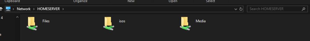

  8. @Frank1940 sorry for the delay. Since the original post the issue has changed a bit. I ended up resetting my Windows as my C: drive needed it anyway. I still cannot map the server as a network drive, however, I can see it in 'Network' in File Explorer. When I open the directory, however, I don't see all my files. I know these files are still intact because I can see them via the Unraid webgui and access them via Jellyfin. I believe I have set SMB up correctly in Unraid, I went through that linked post to help set it up originally, but not since resetting windows. SMB v1 is off. Insecure connections is enabled. The credentials used to log into my PC are not the same as the details used when trying to map the server. Same username, but different password. This user has read/ write access to all shares and disks All shares and disks are set to export = on and security = public (at this stage) My PC is part of the same workgroup I set up a 'network neighborhood' folder before I had this issue, that was how I originally got it working. That folder was still there after the windows reset, but produces the same results as accessing \\HOMESERVER via network I've attached diagnostics and images of what I can see and what happens when trying to map the server The other two folders show as empty but are not homeserver-diagnostics-20240607-0703.zip

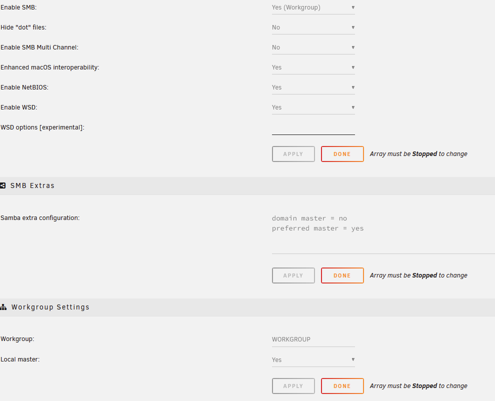

  9. This originally worked for me but I upgraded the CPU in my server the other day and have been having issues accessing and adding the server as a network drive since. I ended up resetting windows (needed to be done anyway), enabled smb1 to be sure, enabled insecure connections via gpedit, and I can now see the server in my network, but I can only see an empty folder when I know my data is still intact as I can still access it via streaming apps, etc. If I try to map the server as a network drive, I get a connection failure. Images and diagnostics attached. homeserver-diagnostics-20240605-2213.zip

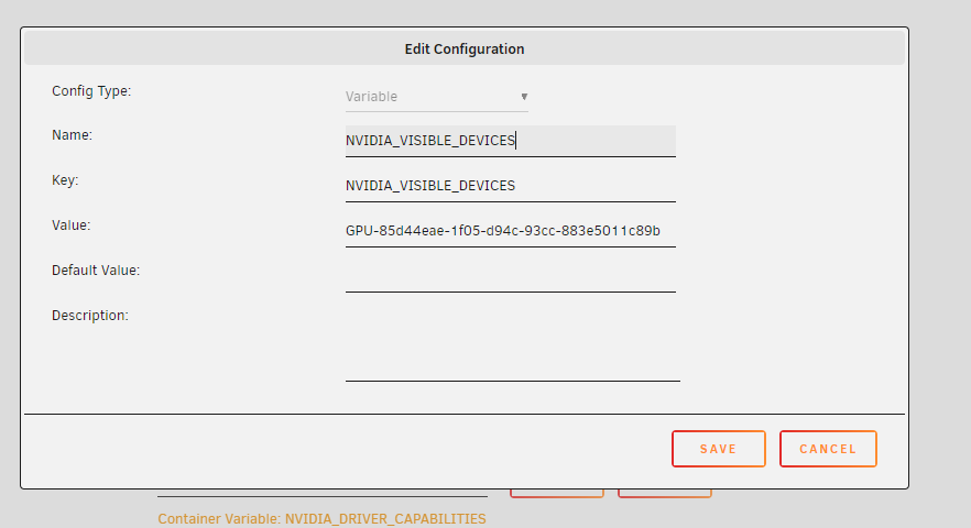

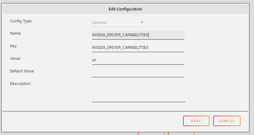

  11. @ich777 I forgot to mention that, sorry, that was already enabled. I tried the quality change; it uses the GPU if I set it to 480 - 1.5 but if I change it to anything else it stops utilising the GPU. Jellyfin logs and diagnostics attached JF log 14-5-24.txt homeserver-diagnostics-20240514-1817.zip

  14. I tried this first and it did not resolve the issue so I moved onto the documentation provided by @Frank1940. Once I labelled my Ethernet network as Private and added the shortcut for the server, I could read and write via explorer again. Thanks both!
