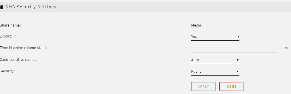

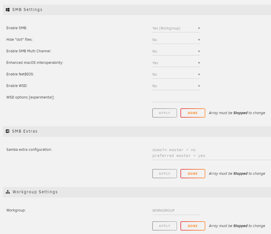

SMB settings:
Share settings:

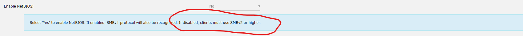

You need either NetBIOS or WSD enabled to be able to see your server on the network.  I'd recommend turning on WSD.
I tried this first and it did not resolve the issue so I moved onto the documentation provided by @Frank1940. Once I labelled my Ethernet network as Private and added the shortcut for the server, I could read and write via explorer again. Thanks both!
