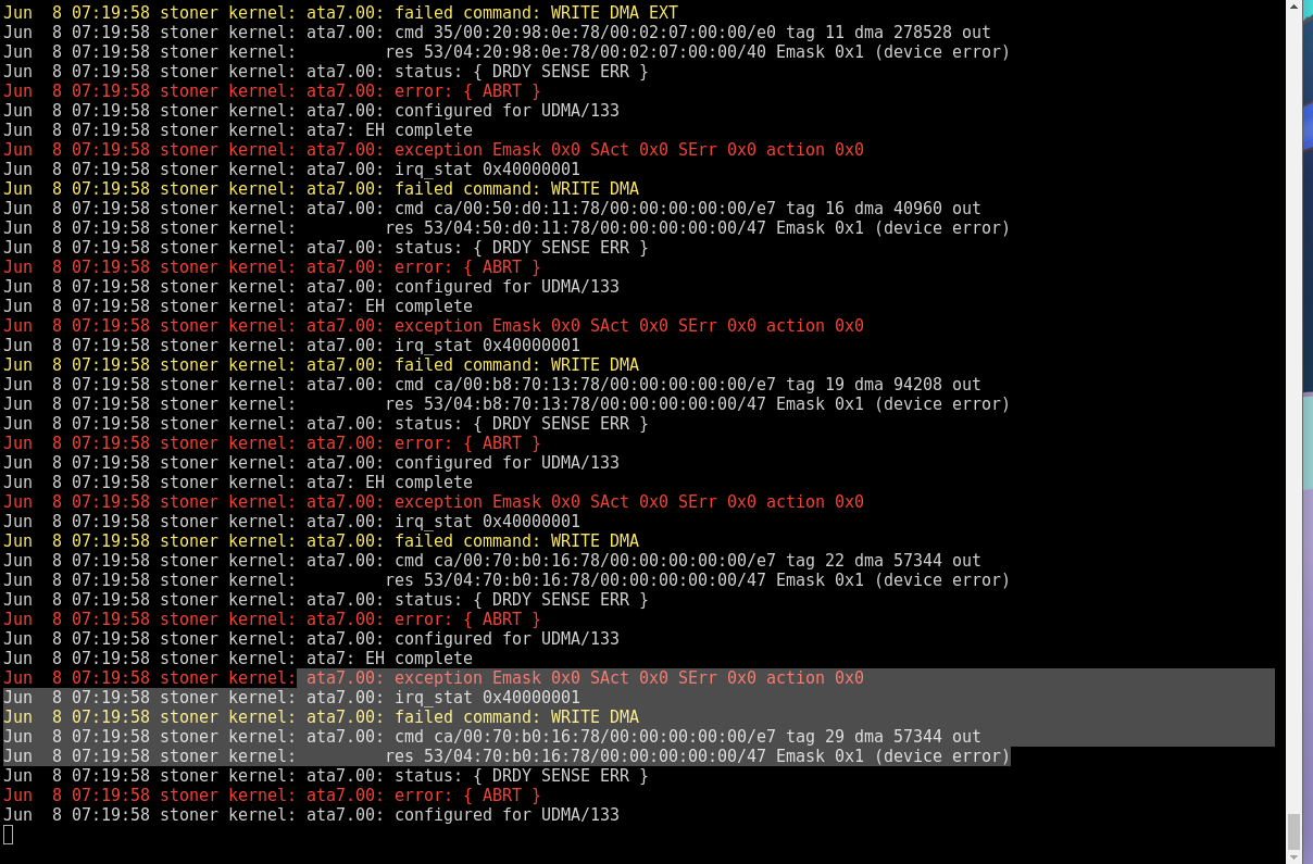

June 8, 20242 yr Recently changed my mobo and cpu and when i booted i couldnt attach my HGST_HUH721010ALE600 plugins.txt lspci.txt btrfs-usage.txt meminfo.txt vars.txt unraid-api.txt lscpu.txt urls.txt cmdline.txt ifconfig.txt lsusb.txt iommu_groups.txt sshd.txt lsmod.txt motherboard.txt loads.txt top.txt memory.txt df.txt folders.txt testparm.txt ps.txt ntp.txt ethtool.txt lsof.txt lsscsi.txt drm.txt servers.conf.txt ST4000DM000-1F2168_Z302B1HM-20240607-2212 disk2 (sdd).txt Samsung_SSD_970_EVO_Plus_2TB_S6S2NS0T924451M-20240607-2212 cache2 (nvme0).txt ST5000LM000-2AN170_WCJ4B5L4-20240607-2212 disk4 (sdb).txt eui.002538592140dcfc-20240607-2212 cache2 (nvme0).txt HGST_HUH721010ALE600_7JG38URC-20240607-2212 (sdf).txt Samsung_SSD_860_EVO_500GB_S598NJ0N122316Y-20240607-2212 cache (sde).txt SanDisk_Cruzer_Glide_03021614103123184001-0-0-20240607-2212 flash (sda).txt ST4000DM000-1F2168_Z302AJ4A-20240607-2212 disk3 (sdc).txt dhcplog.txt syslog-previous.txt syslog.txt super.dat network.cfg disk.cfg editor.cfg go.txt listen.txt docker.cfg cache.cfg share.cfg ident.cfg domain.cfg unraid-6.12.10.txt S--------e.cfg domains.cfg system.cfg shareDisks.txt m---a.cfg e------r.cfg isos.cfg appdata.cfg

June 8, 20242 yr Looks like a connection problem. Check connections, SATA and power, both ends, including splitters. Then reboot and post new diagnostics
June 8, 20242 yr Author i've changed both mutiple times still not wanting to connect to the array and when i try to check the disk for errors halts my unraid and cant shutdown or reboot
June 8, 20242 yr Author i can see the device in preclear it just wont let me do anything it errors out when i try to format it or anything
June 8, 20242 yr If you have replaced both the power and SATA cable the problem is likely be the disk.
