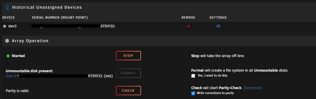

Hi there, so had a power failure and when the server came backup. disk2 stated Unmountable: Unsupported or no file system. I had another HD just sitting on the systems as a cold spare i precleared previously (sitting in unassigned devices) so i decided to just swap them. So i stopped the array swapped the disks and started it back.
the array started the rebuild process and started doing a bunch of writes to the disk. However the disk still showed Unmountable: Unsupported or no file system. So i decided to let it do its thing maybe it will be fine after, because it already stated that previous data will be lost if i start the array. But there was that format message at the bottom where you start and stop the disk.
im unsure what to do as im afraid of data loss.
