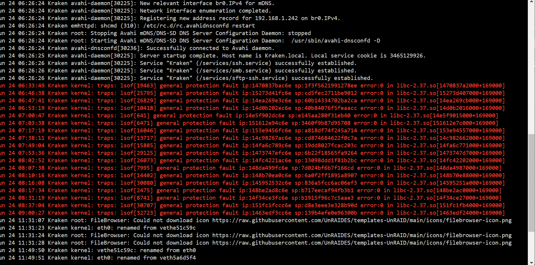

I just don't understand. It has work wonderfully for years. I'm left wondering what has changed. While the system was down I set up the ARR's on a windows PC for nightly entertainment. It works well. The whole network seems to work well.  Outside of Unraid but this seems to be dropping network connectivity. Then shortly it will reconnect. Could it be a network hardware issue that was there with my memory issue? I posted a screenshot of the log showing some errors.
