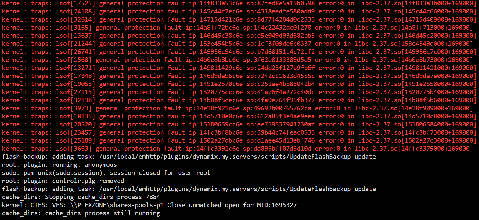

UNRaid kernel: traps: lsof[28497] general protection fault ip:
Had this start happening after I was transferring data off of my Unraid server onto my TrueNAS server to change out the Unraid FS setup. It was coupled with some RAM errors at the same time that the server had not had before. I'm transferring over NFS.

  • Now I got this message also:     What is the reason for this Problem and how to fix it?   Thank you, Luk

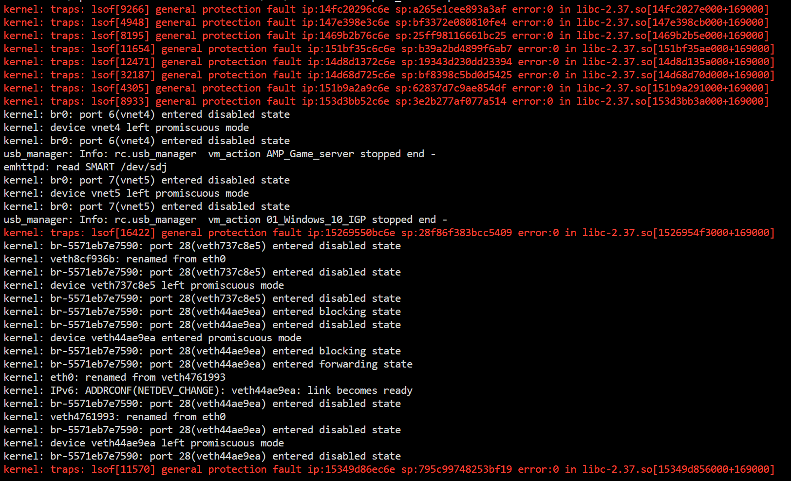

    I get similar issues since a few versions back, server starts to max the CPU then stuff like this gets spammed in log. After a some time, it calms down and everything is back to normal. Seems to
You have the cache dirs plugin installed.  Be sure you set it to include only the shares you want it to operate on.  If you don't set up include shares, it will cache all shares including UD and cause issues like this.
Thanks, just disabled it for now.

Hi all, just thought to chip in with my experience, I too had an error of this nature and turned out to be that I had a SMB mount via a tailscale tunnel which when that mount was not reachable I got this error. When unmounting the unreachable share the errors stopped.
I could reproduce this by having that drive available and mounting it, then turning off that drive on the remote end and the error started again.
I understand this may not be the case in all of the above but it may help some who are getting this error in this use case.
