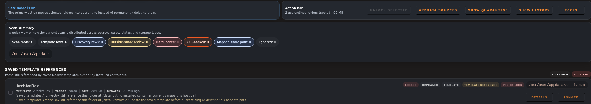

  1. Im still learning and dont quite understand why this cant be removed? The tooltip suggests I need to remove the template reference but if Im already doing that I could just as well do the cleanup manually?
