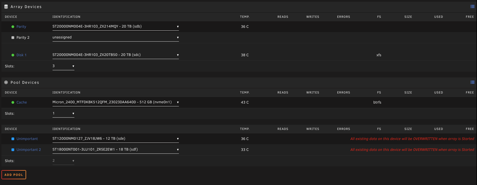

Sorry, but I am not getting on which pool I should run this on.
The image above is currently what I have with all the disks. "Unimportant" is the pool in question (the data is important though, so ignore the name). The old disk is the 12TB one. So I should run the sfdisk command on the old disk (sde).

So is there any way to recover these files? I did not keep any backups.
My latest diags are attached.
insane-homelab-diagnostics-20240718-1244.zip
How were the files copied to the array?
