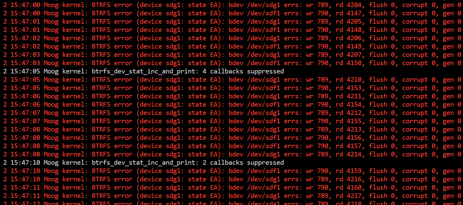

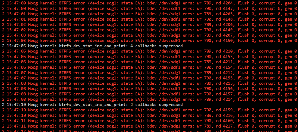

UPDATE : after 30 mins the server is starting to fail with containers not starting to work and the VMs not working now. The log files keep showing this:

The cache drive is in a pool of 2 raid 1 SSD's. I wonder if one of the disks has failed in some way: I took this screen shot from the second of the cache drives:

Post new diags, since those errors are not in the previous ones.
