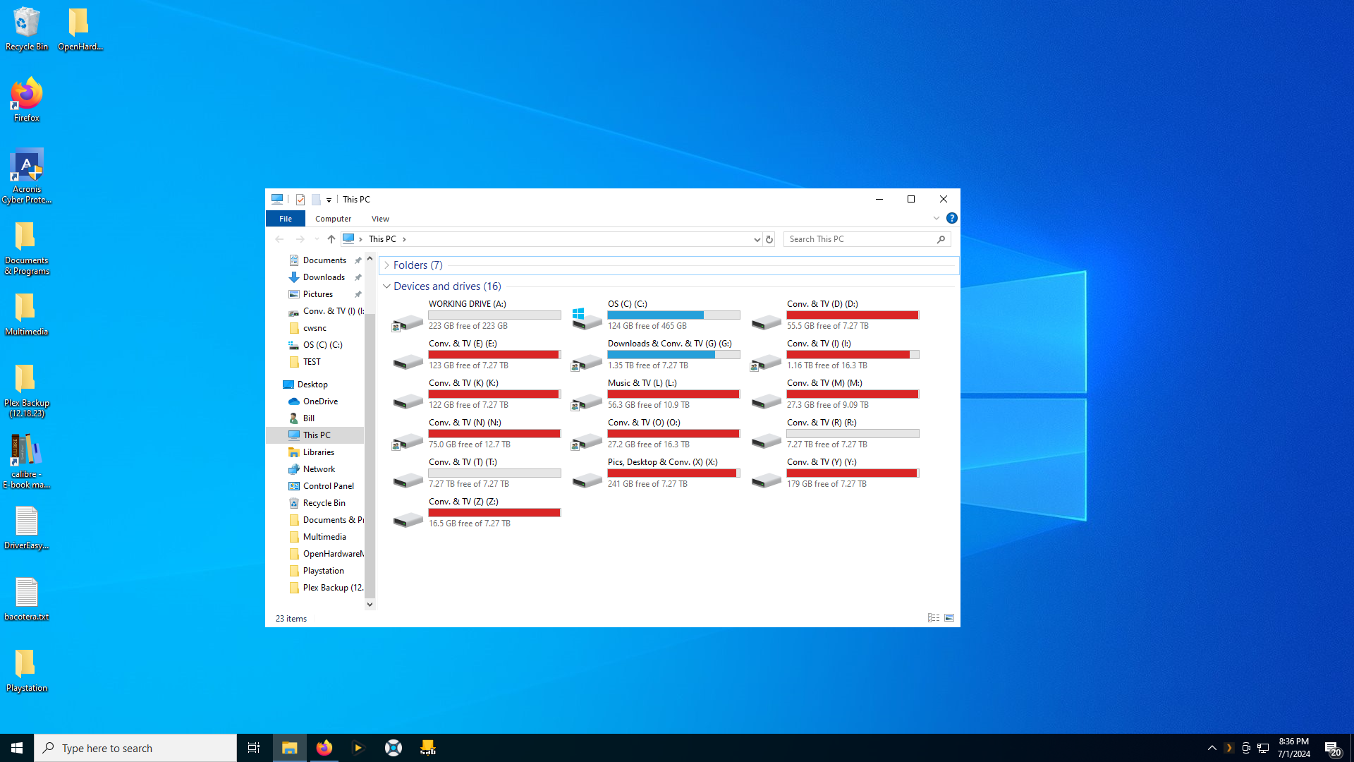

Attached are my Windows data drives. I have (3) empty 8TB HDDs (one is not installed in the screenshot). Can I move them to the array, format them correctly, and them move data drives over one at a time (creating a new "blank" drive each time)? I have a few 18TB data HDDs. Will the 24TBs I create allow me to move those larger drives, or do I need to buy a new empty 18TB?
What is the easiest way to move my Windows files into the array? Over the network?
Thanks for your help!
